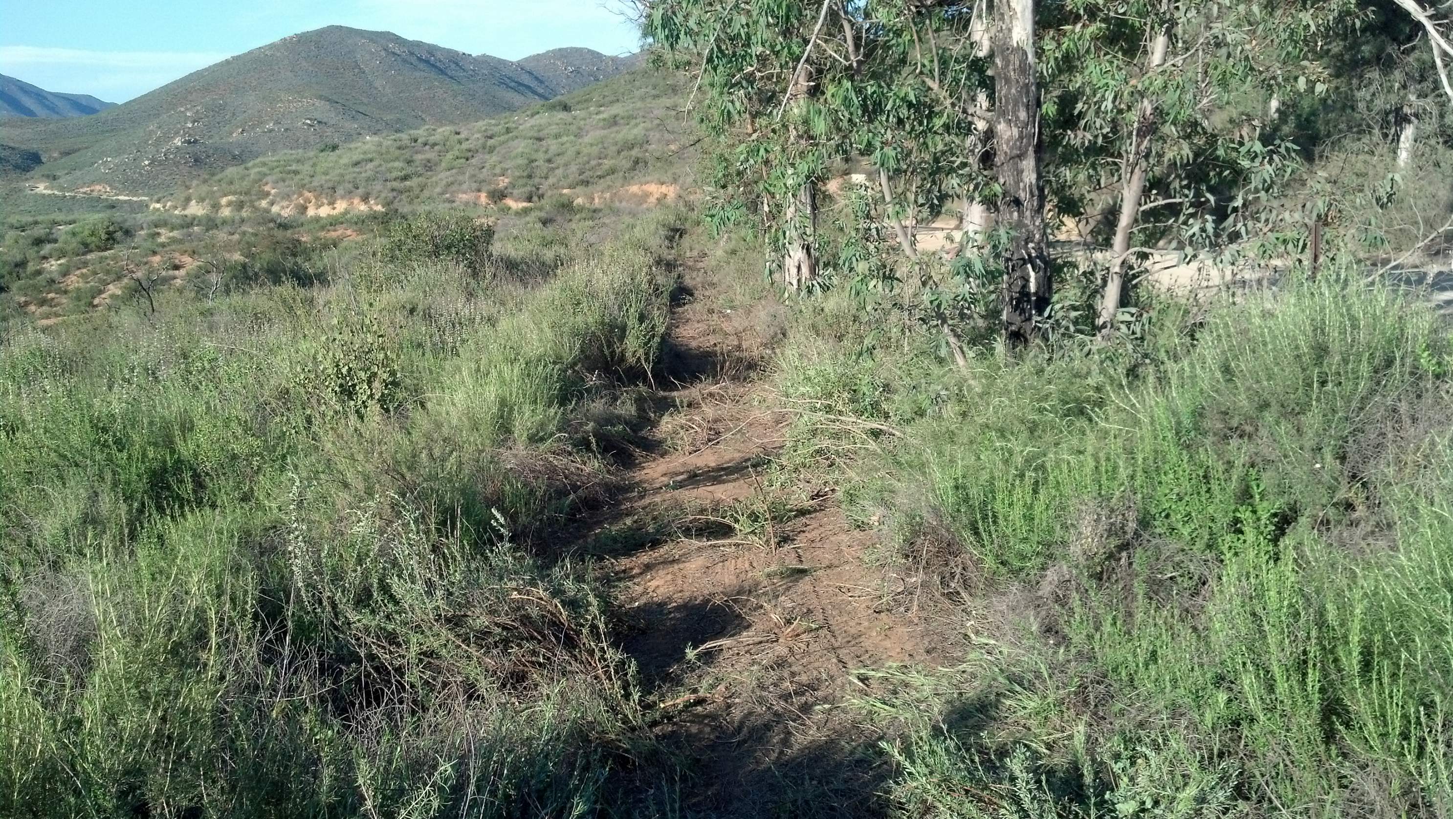

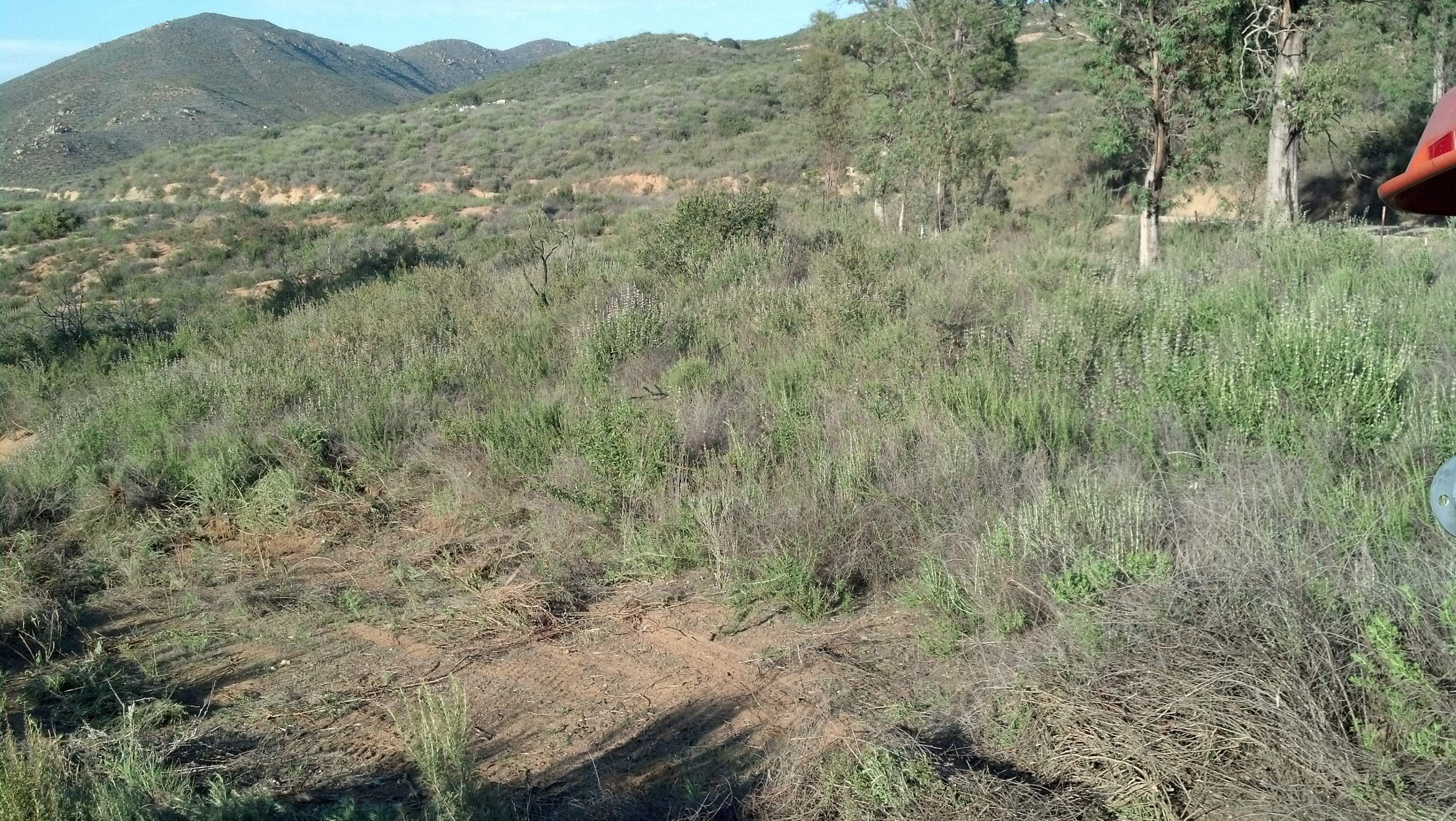

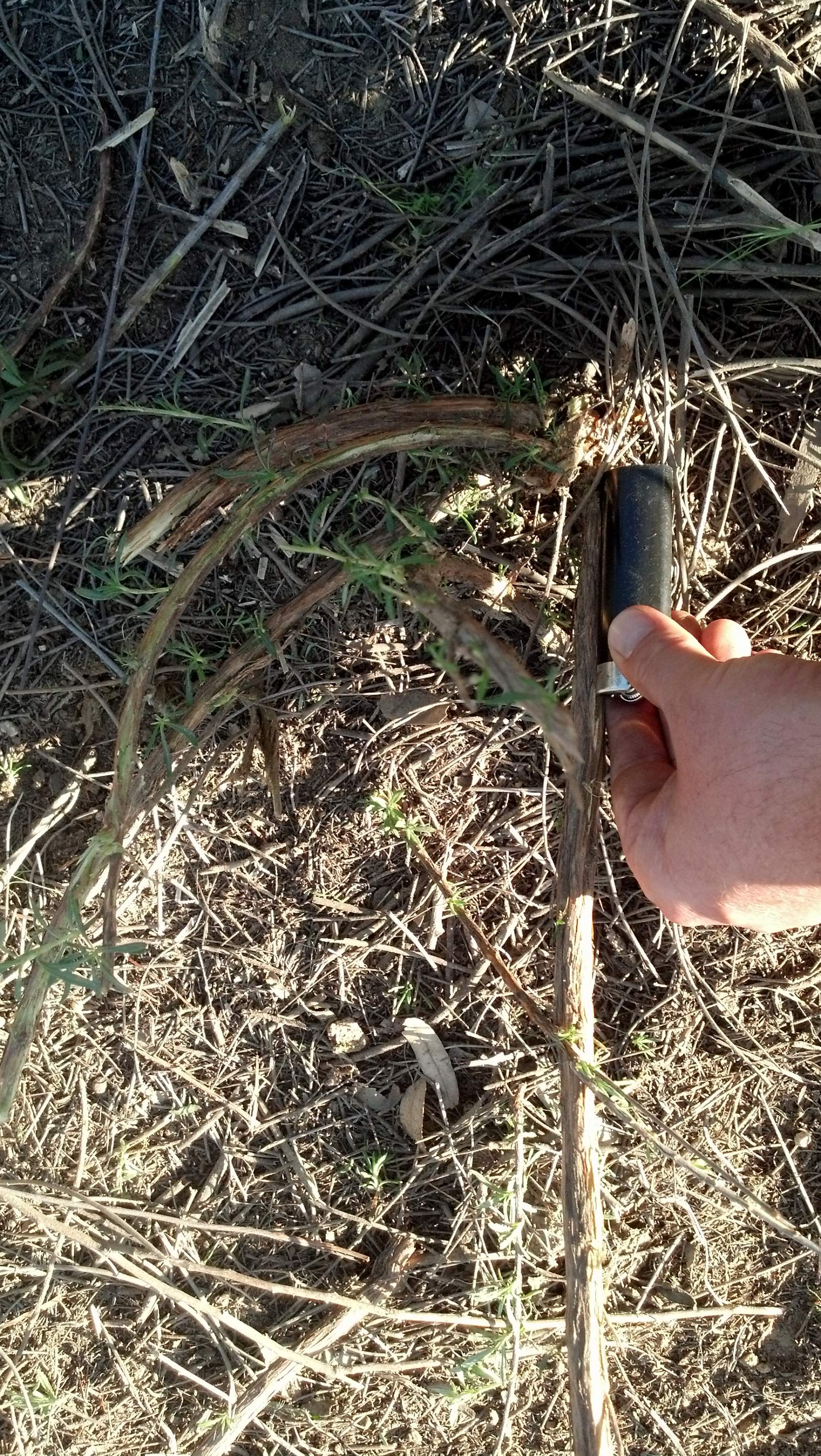

I have attached some photos to show what im trying to get done. one showing a path cut
with box blade in reverse one showing how thick the bace of the brush is and one a general idea of the land im trying to clear. the majority of the brush is california chaparral and anything larger will be cut with a chain saw and dug with back hoe. Thanks in advance for any imput.View attachment 311688View attachment 311689View attachment 311690
About your mowing needs AND before you make a mistake and make more work for yourself than its worth:
Please finish reading the threads and post about flail mowers before you go any further the 20 hours you have spent is well spent BUT I want you to finish reading the posts and threads.
DO NOT expect to drive fast over this brush with a flail mower until you have mowed it to the ground!!!!!!!!!
YOU will lose belts!!!!!!!!!!!!!!!!!!!!!!
A 60 inch Caroni flail mower will require more power than what
you have at the power take off and it may still be an issue with
two opposing rows of knives removed.
YOU can always remove every other knive set on the finish rotor on all four rows if desired
or simply remove the two opposing rows leaving two full rows of knives.
You need to purchase a belly pan protection kit for your mule
first in any case!!!!!!!!!!!!!!!!!!!!!!!!!!!!!!!!!!!!!!!!!!!!!!!!!!!!!!!!!!!!!!
A: you cannot reverse the flail rotor operating direction, YOU simply drive over
the brush slowly and then back up over the brush slowly to destroy it all.

i could use my cat to clear but it leaves alot of clean up work behind it. and for the cost of hiring some one local for a week i could just buy a flail.
