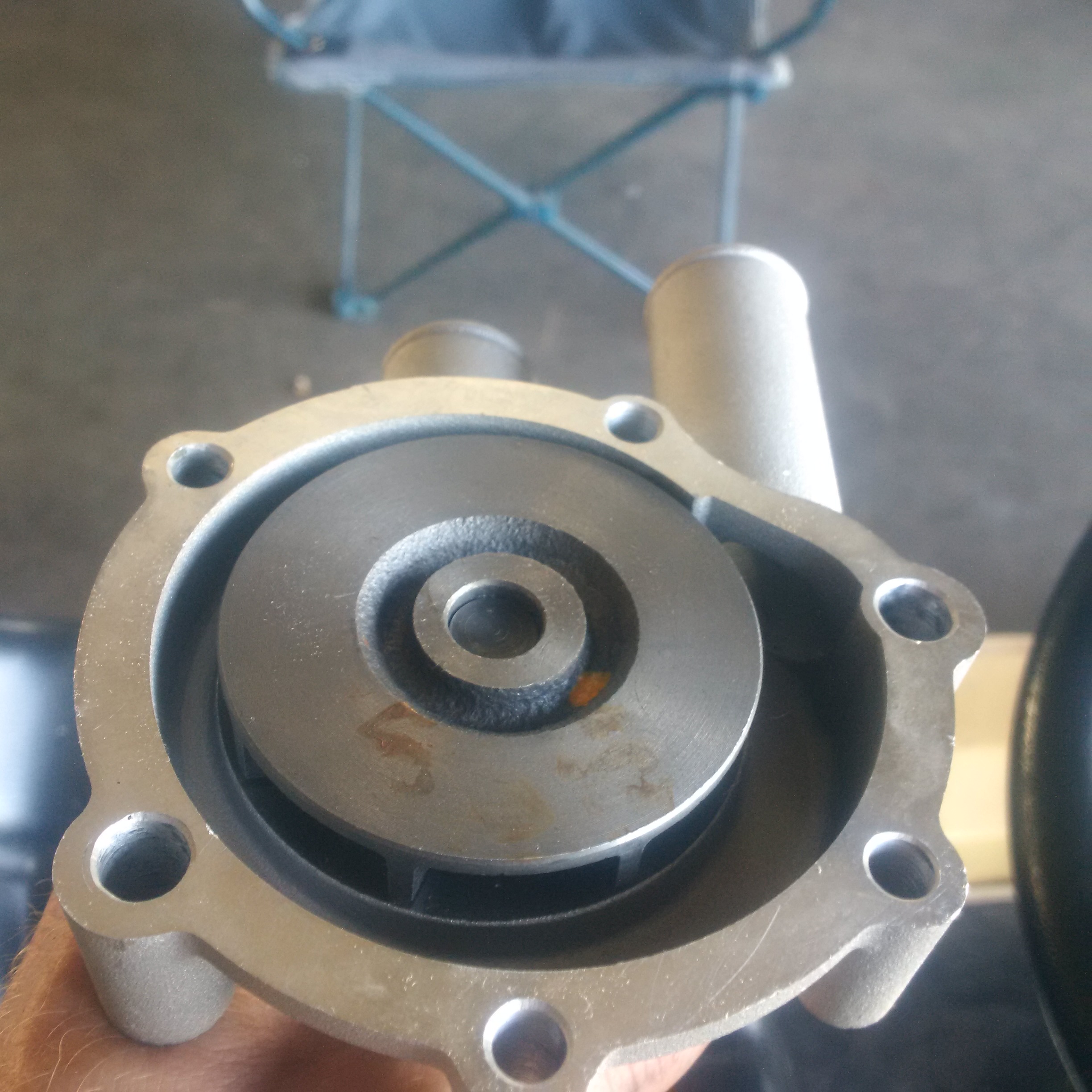

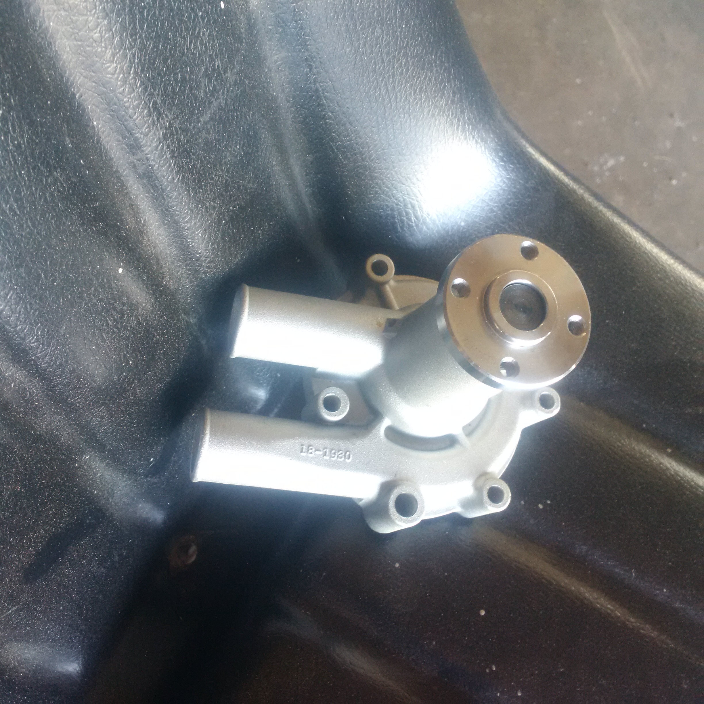

Hi Folks - I am building a 25ft aluminum fishing/pleasure boat with an inboard Cummins 4bt 150hp diesel. I have to rig up a 2nd water pump to circulate the seawater through the transmission oil cooler, engine heat exchanger and then out the wet exhaust. I regret cheaping out and not buying an OEM gear driven Cummins seawater pump when one was available at a reasonable price...Instead I bought a Yanmar 18-1930 water pump and added a pulley, belt from the Cummins crank/ accessory pulley, fabricated a backplate from aluminum and bracket to mount it.
Well, I tried it today and it didn't work..... I am thinking I have one or both of the below issues and maybe more... help please!!
1. Which direction should it spin, when viewed in pics below? I first thought it would spin counter-clockwise (so impeller pulled water from narrow channel to wider channel, perhaps creating some vacuum....now wondering if it should spin clockwise so water is pushed from wider channel towards narrow to create pressure.
I tried spinning it in both direction by hand, with backing plate on with gasket maker, and both hoses primed/ filled with water - with no results at all...and no resistance I could feel- which leads me to #2...
2. When mounted on a Yanmar tractor or engine, does it mount on a seal of some sort or raised area in middle, so it reduces the gap between the center and the backing plate/ mounting area? I didn't look close enough before but looks like there is perhaps a 1/16" gap so the impeller is recessed and does not touch the backing plate. I now assume that any gap of significance would mean the pump cannot create any vacuum/ push/pull of water, etc..
Any help or suggestions would be appreciated!

Looks like it's just a simple centrifugal pump. It should turn clockwise and will pump from the center inlet to the outer connection, judging by the shape of the housing. Turning by hand is too slow, has to turn fast. It will work bolted to a flat surface since the water inlet is at the other end where the clearance is probably less.

Well, |I have it spinning clockwise (when viewed from the front / pulley end) but there was no suction or pumping even at 2000 rpm or more, with the lines primed with water... I will have to measure the distance from the center of the impeller to my backing plate, and if there is any gap like 1/16" or more, I may tack in a shim to reduce the area between the impeller and backplate. I know on the rubber impeller sea water pumps if the backplate is scored at all (increasing the gap) it greatly reduces the efficiency. On some you can turn over the backplate to have a fresh / flat surface for the impeller after one side is too badly worn.

Strange that it wouldn't pump. There must have been some air in the pump. The discharge connection would have to be at the top to let all the air out I would think.
Clearance at the open end of the pump shouldn't affect anything because the center of the impeller is closed at that end. On some engines there isn't any discharge connection, the water just goes right into the engine from the impeller, so it's just open in the back.

I assumed there was no air, as I poured water in one hose and it ran out the other, so thought the pump would be then full or partially full of water. I even kept the ends of the two hoses (about 5ft each) higher than the pump.
It did seem like there was zero resistance. Maybe the water flowed by the impeller but air was still trapped there. But what else could I try?
I see your point about the engines with open mounting, and therefore much more of a gap than I have. But, I fail to see how it would actually create any pumping force, if water can just go in any direction and not follow a certain path around the impeller, like if there was no gap behind it...

The water flows from the center of the impeller to the outer edge. As long as there's not a leakage path back to the center the pressure isn't lost. Since the center of the impeller is closed off on the rear end that we're looking at, the water has to go out the outlet fitting.

The one shown in the picture is actually a 2nd pump - they were cheap so got two at the time (one for another purpose) The one I tried on the boat is identical but I removed the collar and pressed on a sheave / pulley - got lazy and used a big vise to press it on rather than hone out the hole in sheave for an easier fit... I put a block of wood behind the impeller while pressing to prevent damage - I wonder if I may have pressed impeller a bit further onto the shaft, perhaps blocking entrance holes, etc and preventing it from working the way it should..... if that's a possibility, I could try the spare one....

If you moved the impeller very much it wouldn't turn. Try running water into the inlet and see if it goes thru the impeller just to make sure you have free flow.
I presume the shaft is horizontal when you're running it. Do you have the outlet at the top so the air can get out?
