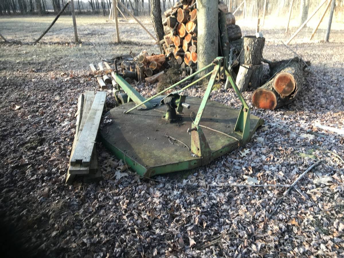

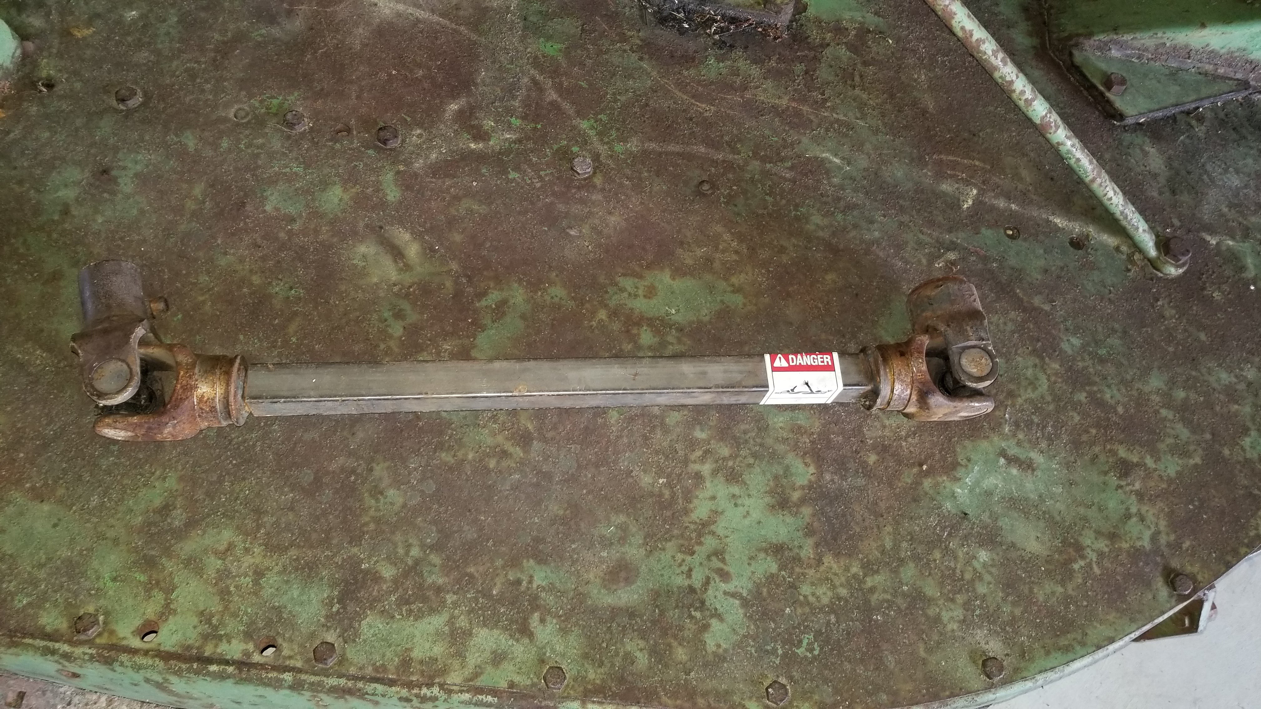

Can anyone point me in the right direction on hooking up my PTO to this John Deere 205 Gyramor cutter? We bought this used, and I was told that I "just need to get a slip clutch for it". haha :laughing:

It wouldn't be that hard to add a slip clutch to a sliding PTO shaft, but if you are planning to use the fixed PTO shaft shown, then it will probably have to be shorten to add a slip clutch to it.
   / Help replacing slip clutch (attaching PTO) on old John Deere 205 Gyramor brush cutter
Thanks! So you think I can put an after market slip clutch on that existing smooth drive shaft and make it work?
I think that PTO shaft pictured is a sliding shaft... But I'm very new to all this so I probably have no idea what I'm talking about. Haha

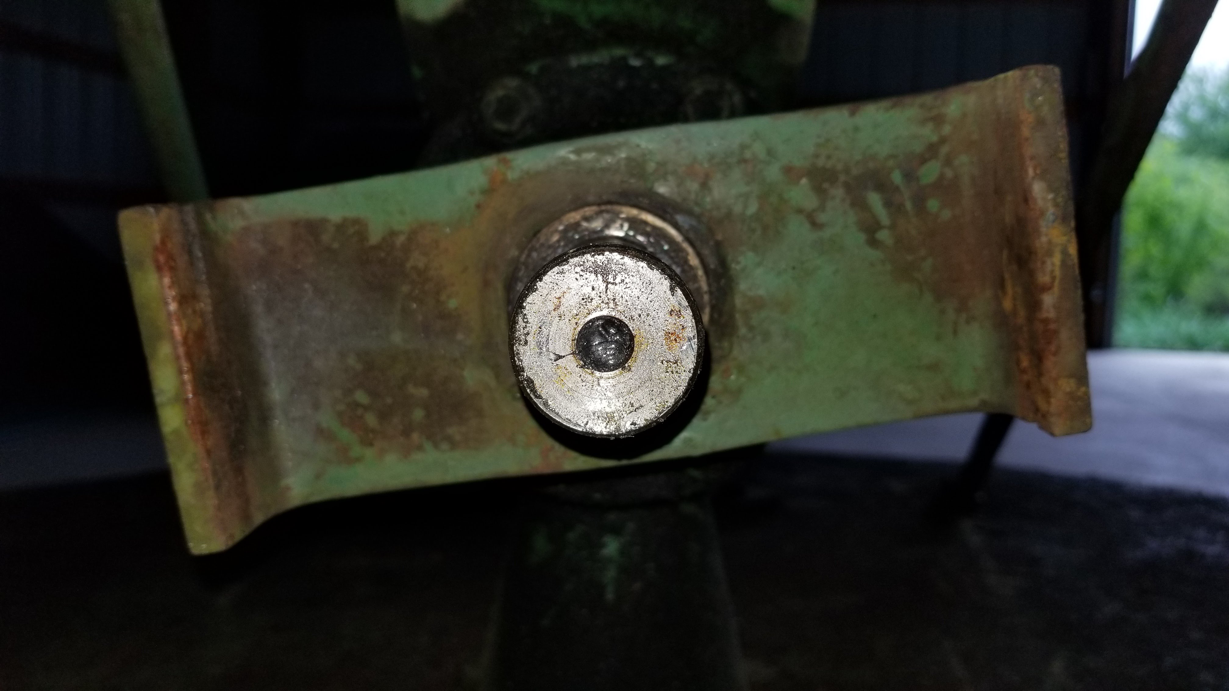

Who said it had a slip clutch on it before? Does it have a place for a shear bolt?

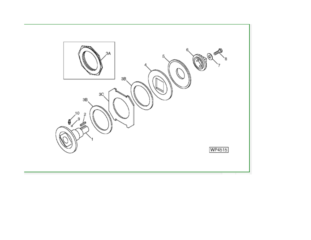

Yeah, this one had a slip clutch. It seems there was a version with a shear bolt and a version with a slip clutch. In my case, the drive shaft isn't drilled for a shear bolt. Here is the parts diagram for the OEM slip clutch ($700+ from John Deere Vintage Parts):

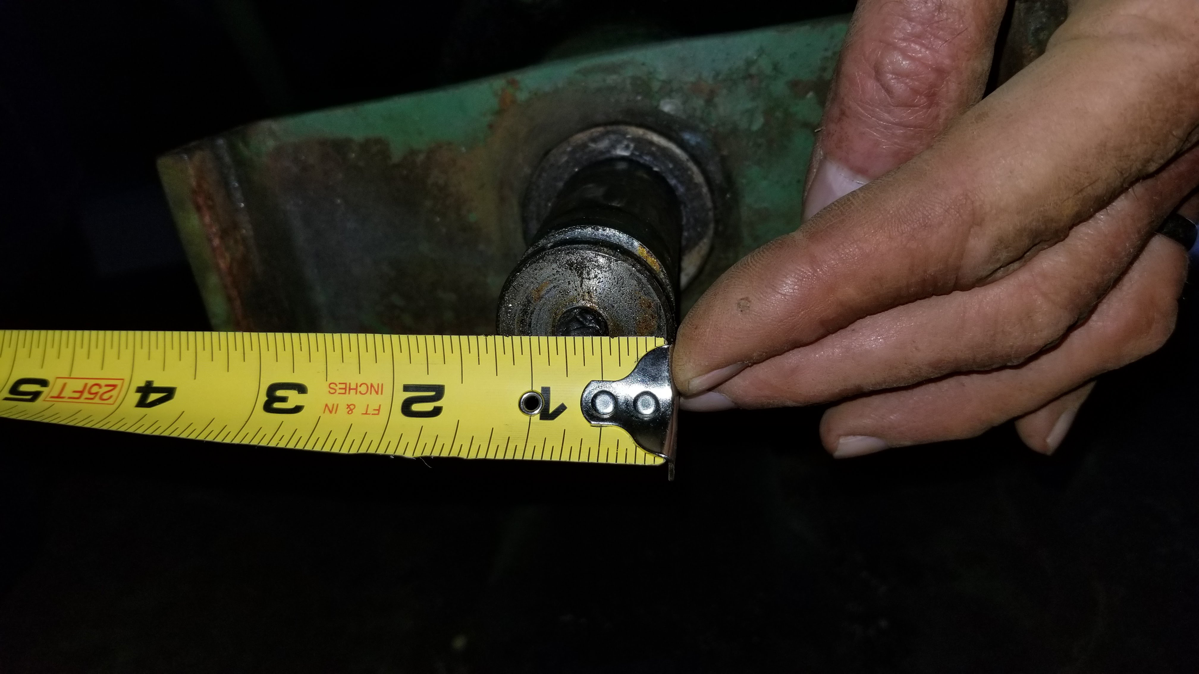

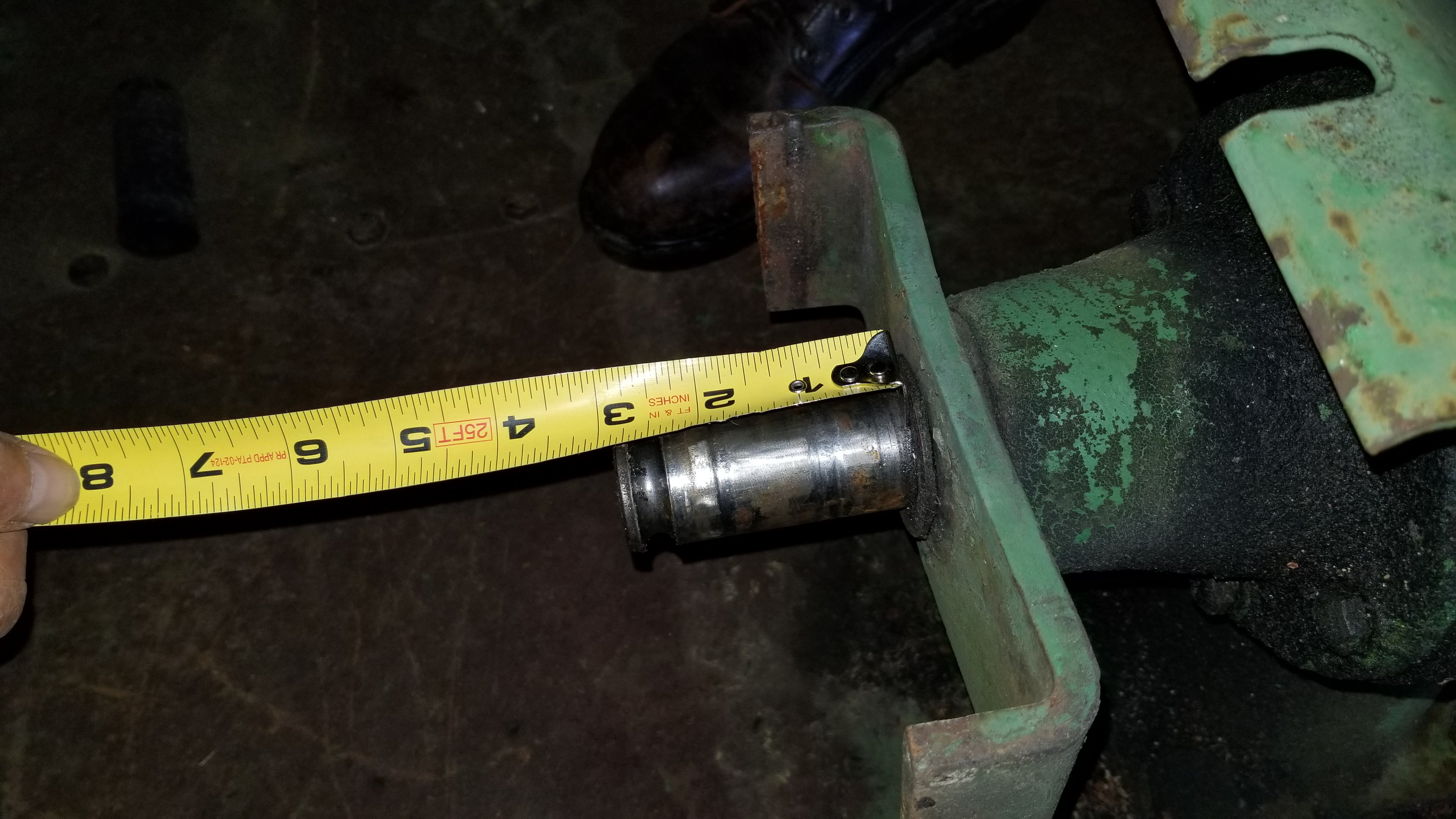

I'm considering trying to either drill it myself and forget the clutch; or maybe having someone weld the PTO directly to the gearbox driveshaft. Thoughts?
My concern with drilling it is that I think this drive shaft is 1 1/4", not the standard 1 3/8:
