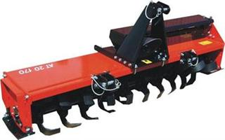

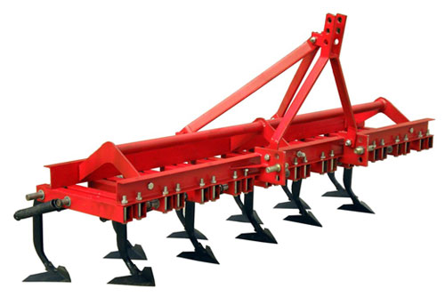

Which tractor attachment or maybe hand-motor tool we can buy to kill weed between bushes AND for between rows? For between rows he use tractor rototilling ( img0118.png) but I think that better tool will be cultivator (4d5f328c0eb078e5991fdd7b59308236.jpg,lees power higher speed)?

Yes, a cultivator would be the best tool to do the job in the least amount of time. Depending on the size of your tractor, you can get a 1 row, 2 row, 4 row or larger cultivator, all with adjustable shanks so you can match the spacing to your row spacing.

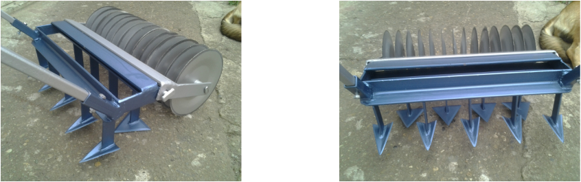

yes, I saw this machines, Side Shifting Rotary Tiller, examples:
What I dont like:
1. machine does not penetrate sufficiently in row.
2. in this first or second year plant is soft and I am not sure if plant can trigger sensor to move out machine.
3. all this machines when go back in row have minimum 5" distance from plant and in this space leave weed. Two reason for this, to much tractor speed and/or slow machine return in row. So I need to go both sides to kill weed.

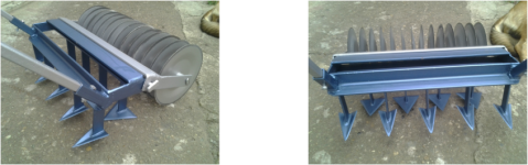

for smaller plantation this bellow tools will be ok but i have in plan 20000 aronia plants and must have machine:
RUCNI ALATI ZA OBRADU ZEMLJE - Home
