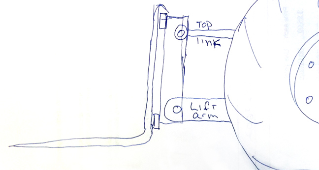

I'm about to build a pallet fork frame for my 3 point hitch. I'd like to keep the top link attachment low, so it is parallel to the lift arms, so the forks stay level when I lift.
Does that increase the forces on the 3 point linkage too much?

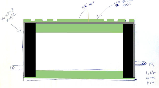

I'm also planning to simply weld the bottom and top bars to vertical 1/4" x3x3 angle, and run 3/8" x 2" bar at right angles to the top and bottom bars to stiffen them. I think this will be way stronger than anything I can lift with my B2620?

I'll cut the bars to 27"-width of the lift arm spacing. I need it for pallets 36" wide.

If the top link and lift arms stay parallel, the implement stays level, right?
If the top link is angled up, the more you lift the steeper the implement point up?

so is there any issue with forces being to high from keeping the top link so low?
I know you're not supposed to use the lower top link location on the tractor as it reduces lift capacity.

I dont think he is talking about lowering the TL.
Basically, in a nutshell, for something to raise and remain parallel, the lower arms and the upper toplink must be parallel to eachother, AND the same length. If that is the case, there is going to be NO binding at all.
So, since most tractors TL are running on a bit of a downhill angle toward the front of the tractor, to get them parallel, you can either RAISE where it is mounted on the tractor, OR lower it on the implement side. For example, if the distance between the lower arm pivot @ the rear axle, and the toplink hole you choose, is 10", you simply make the toplink mount on the implement 10" above the lower pins, and thenn adjust the TL so that it is the samelength as the lower arms, or close to it.
And as far as it creating more stress on the 3PH, it is minimal. Where the big change is, is on the implement.

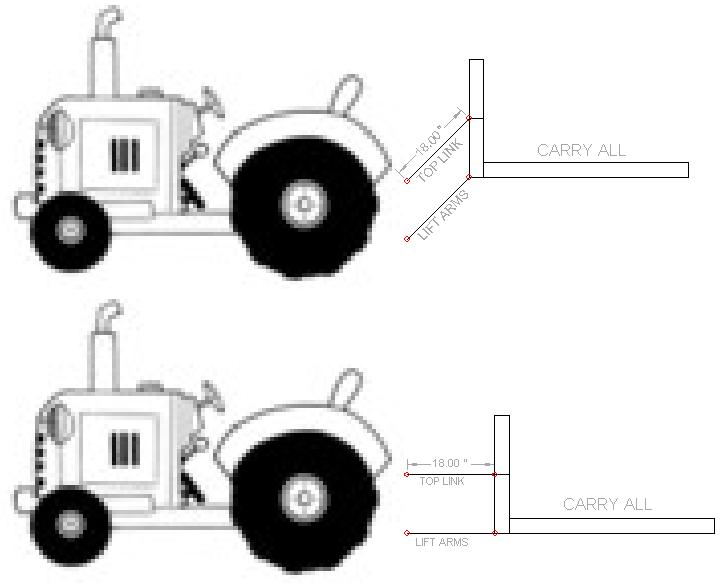

Should be no need for it, though: As long as his lift arms & top link are the same length & parallel to each other, his carry all should stay level ... i.e. a parallelogram.

If the lift arms & the top link are the same length & parallel to each other, then no. They would remain parallel to each other, & therefore the carry all would remain level, no matter how high or low you raise or lower the 3PH.

Now take two peices of string, equal in length, and about 20" long. These will simulate the TL and lower arm. Attach them to the nails accordingly and pull the strings tight. Now raise and lower the board(implement) while keeping the strings tight (remember the strings simulate NON-flexible steel arms). You will notice that the board in your hand(implement) does NOT change angles as it goes up and down. It only goes closer to the wall as it raises. Same as on a tractor, the implement actually moves a little closer to the tractor @ full raise.

In this pic, the lift arms & top link are parallel & the same length.
Does this help?
