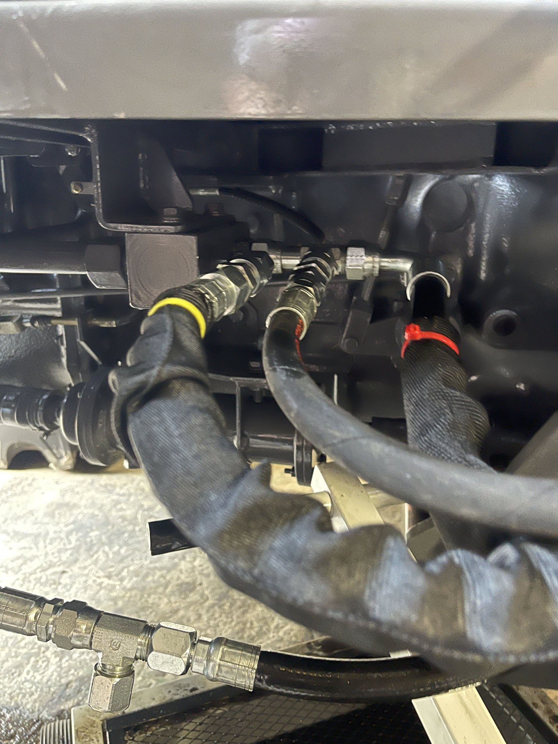

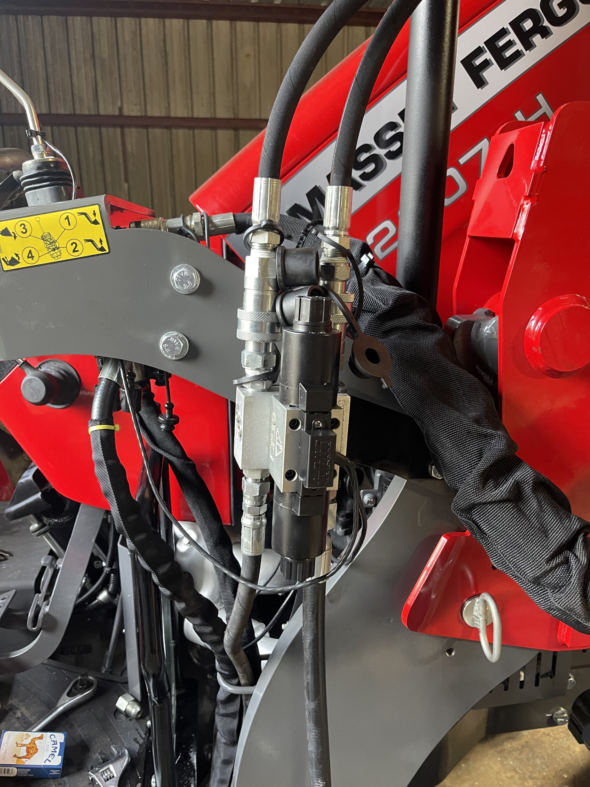

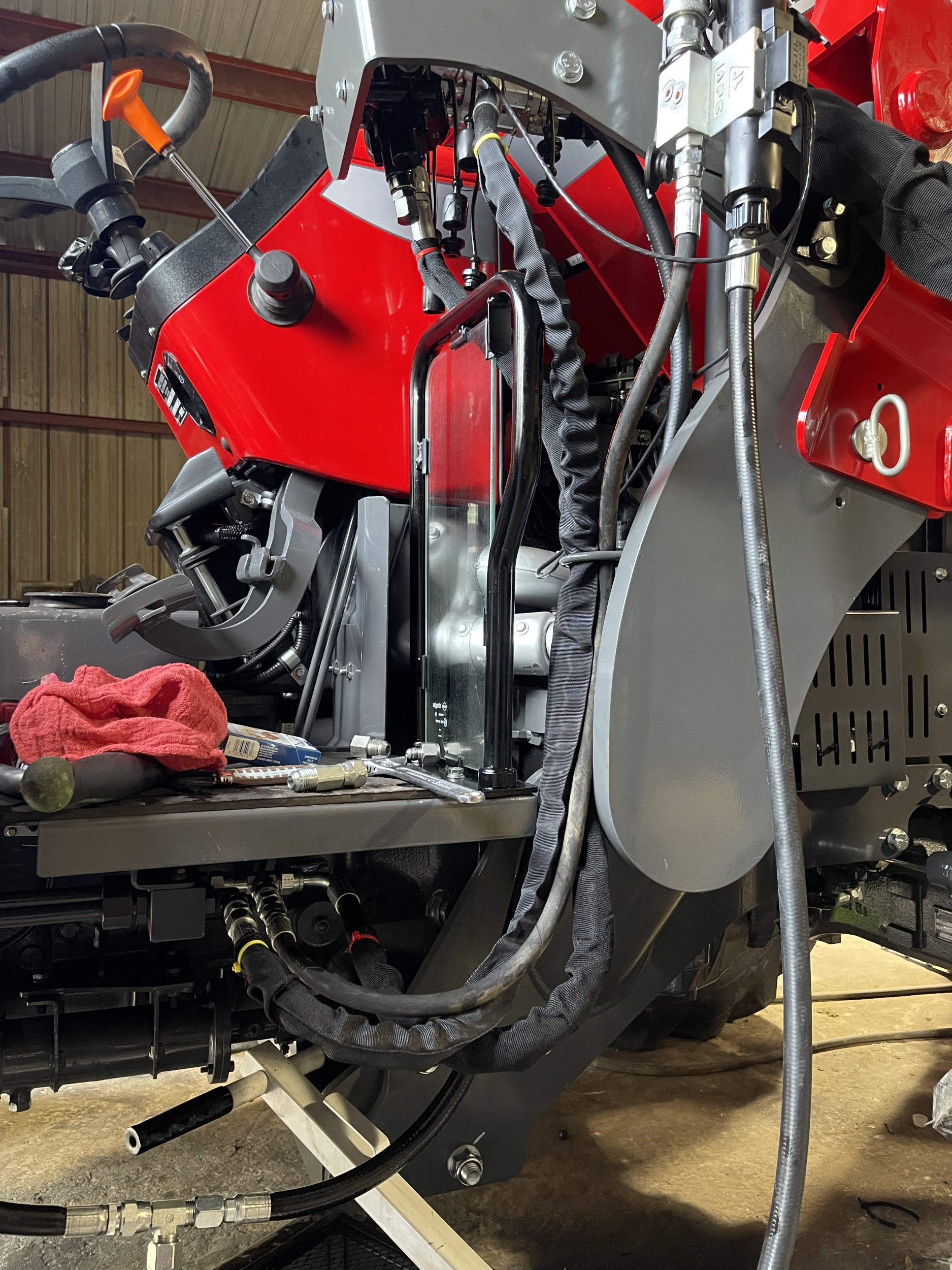

I’m having a problem with installing a 3rd function on a 2607h. At 1st I was blowing the seals on the grapple. We determined that the tie-ins were bypassing the safety valve and rearranged the the lines. to come off the lines feeding the rear remotes because it has a regulator but it doesn’t work unless the remote lever is engaged. Does anyone have pictures of how the hoses are connected? I would really appreciate it.

   / Help with 3rd function install on new 2607h
Sorry attaching pictures. It is a wr long valve kit

   / Help with 3rd function install on new 2607h #6
Sorry vettegc, Now that I see the pictures I realize what you have (which is way different than mine.) I have zero experience with the WR Long setup. I do still say that there ought to be a relief valve in the hookup that would prevent blowing seals and that sort of disaster. Is the WR Long system fed from a standard rear remote control valve or no ?
