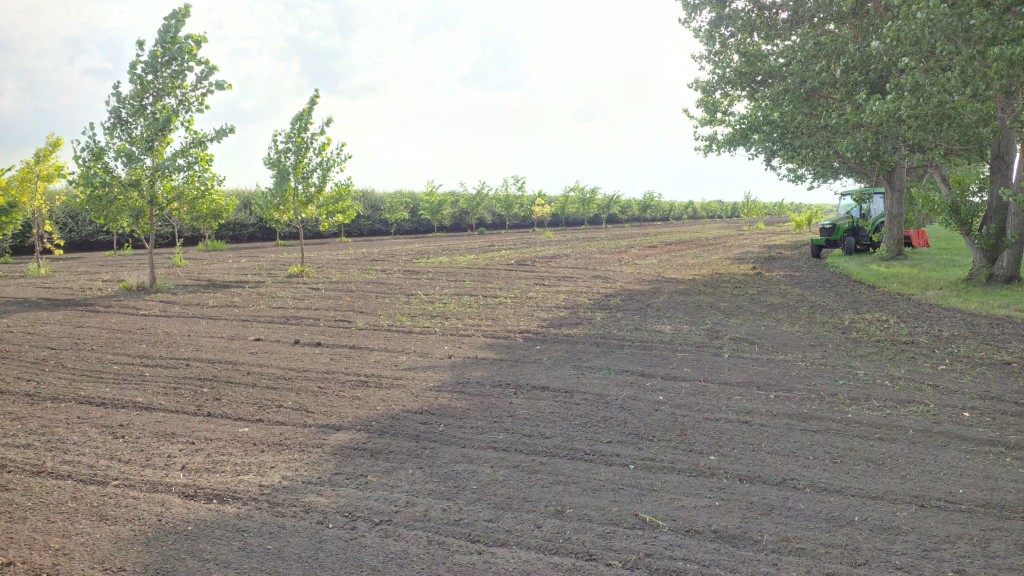

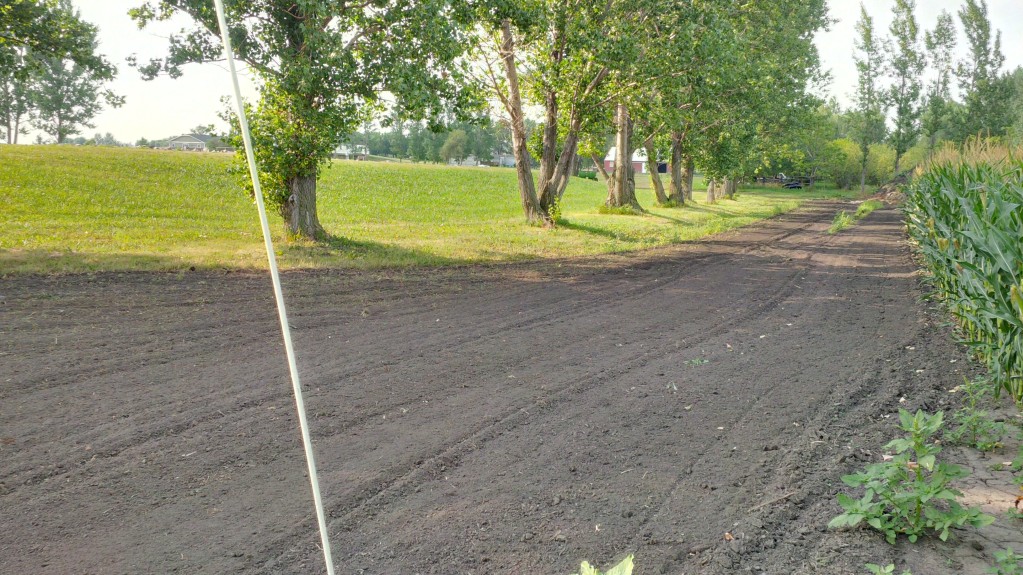

Here is part of what I did today
   / Help with 4320 john deere load match 2011 model #8
That's a lot of tilling!!
What are you making?
#9
It's a part of my shelter belt that for some reason can't grow grass. It gets drowned out ever so often but only weeds grow. Even my trees don't make it
