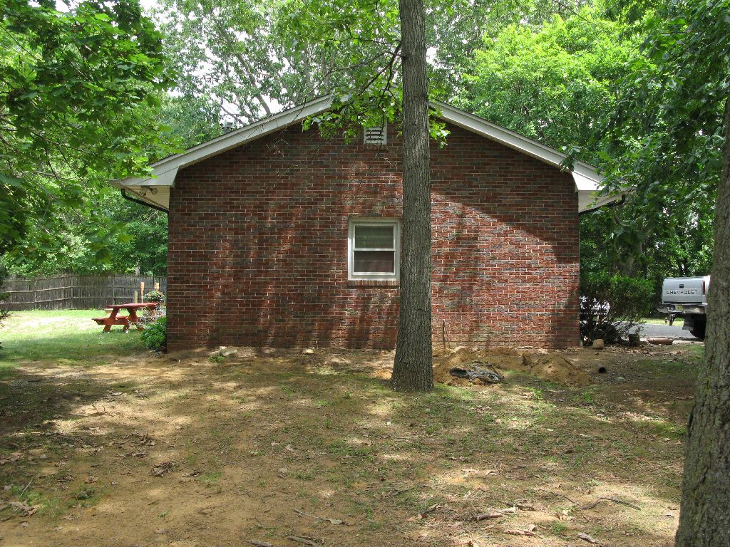

If your portable garage has a gable roof or arched roof and the ridge is parallel with the wall of the house then you'll need to get rid of the water on the half of roof that flows toward the house. A shed roof would be a better roof configuration in this case so the entire roof rain water load can be directed away from the house. If you need to use the gable type (because you already have it?) I'd space it away from the house if possible, beyond the water overshoot of water running off the roof, so you are not getting the side of your house wet.
Maybe you are thinking that the side of the house can provide side protection for your garage. Maybe it can, but don't do it at the expense of the house. Do you have enough space/access to orient the ridge of the garage perpendicular to the house?
If you must use a gable roof and butt the eave of the garage against the house is there any way you can incorporate some type of gutter at the eave of the garage? This would get rid of the garage runoff before it got to the floor level.
If you can post a picture of the garage and the location you want it placed it would be easier to determine the best approach.

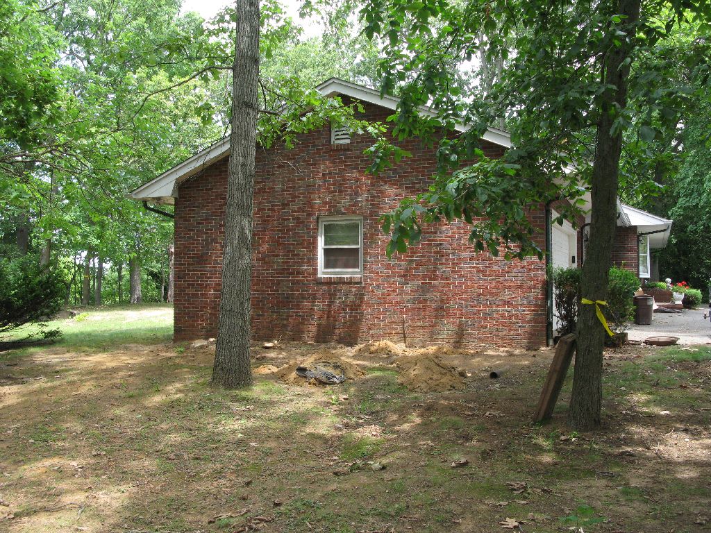

   / Help with a floor in a portable garage
Sorry took so long. This is not a good picture, but maybe give an idea. THere are bushes along the side of the house that are not there anymore, there are also a few trees missing as well. There is on tree about 12.5 or 13 ft away from the house, so the portable garge is 12ft wide so it will have to be close against the house.
The only thing i could come up with is to keep a slope(which is already a good angled slope) from the house out and to lay plastic down on that, but to have the plastic wider than 12 ft and to stick the plastic out of the rock base about 6" or so from the house so when i put up the garage up i can keep the plastic against the inside wall of the garage. This way all the water that runs down a long the tent garage and house will hopefully just slope down under the plastic and rocks and soak into the ground with minimizing the moisture in the protable garage.
Before i do this i am going to run a drainage put from the gutters on the house straight out to the back to here I have a lake. So not sure if i could incorperate something at the same time? Since i will have a trench out along the side of the house maybe i could make a french drain with a preforated pipe out to the lake too?
What do you guys think? I will try to get a few pics tomorrow...
Thanks again for everyones input.

Here are some pictures of where is going....
I measures 12'11" between the house and the tree. So unfortunatly I have to put it 1 foot away from the house....
So any suggestions??
Troy

   / Help with a floor in a portable garage #10
First question ( and I don't think this has been covered yet) is how long do you plan on having this portable garage there? Some of these things are guaranteed for 15 years. If you want it there for a long time, it's better to do it right. For moisture control, you need venting and a vapor barrier (sold by Farmtek.com) to put underneath your flooring. I used compacted processed stone (maybe the same thing you're calling blue stone) and put the vapor barrier on top. I put 1/2 inch rubber matting on top of that. Its very durable and dry as a bone. I do keep the door rolled up most of the time in the Summer and close it only when I'm expecting a big thunder storm or a long, drenching rain. Short rainstorms don't seem to put any water at all inside the door.
