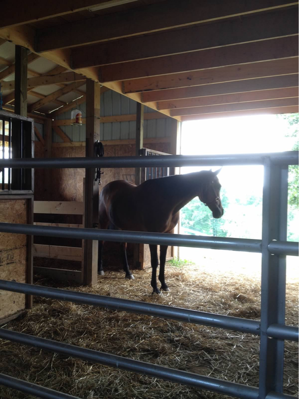

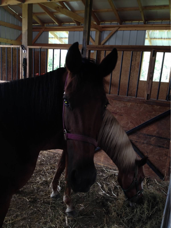

   / Help with barn stalls #6
I would set them 48" and tamp dense grade gravel around them. Not concrete... It will rot at ground level. My stall posts extend up to the loft beams. I'll try to find s pic of how I did them. Not real good pic image-335286459.png Used split stall doors with latches and 3/4" conduit for bars.
