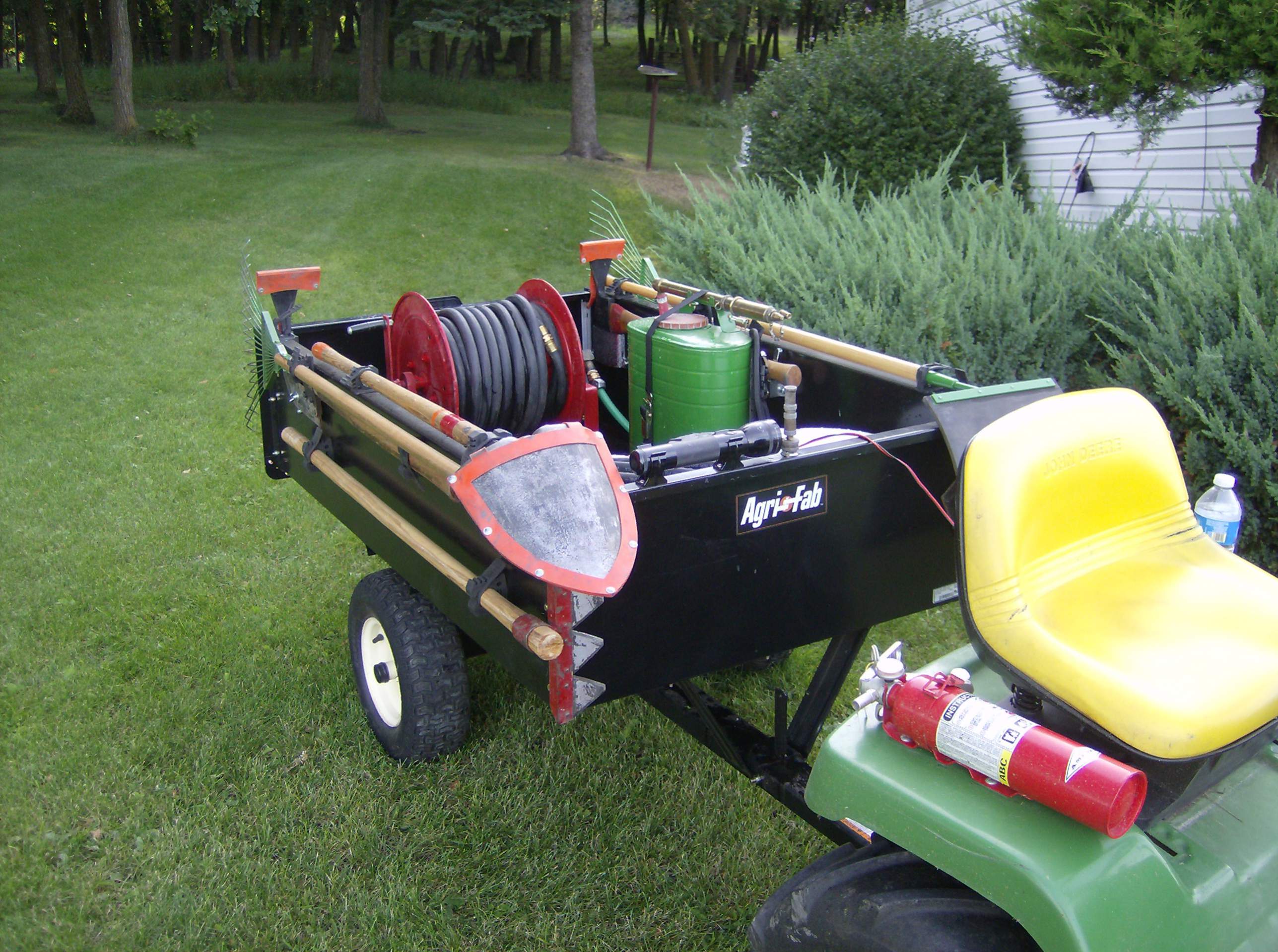

A "canteen holder" or "holder" for a 1-gallon water jug would be good to add, in addition to just a bottle of water on the tractor.
I have a small cooler with food and water that goes in the cart before a prescribed burning or pile burning operation.
I have a 50 caliber ammo box for the fire shelter. That reminds me. While I'm waiting for the North Dakota blizzard to end, sounds like a good project to bolt one to the cart for the shelter.
I added a drip torch holder since I took that photo..
I try to leave room for the leaf blower or chain saw.
In your neck of the woods, I would keep the cart (or your tractor) on a wide fire break or mowed fuel break during a fire. Around here, I park the rig in the black or on a wide mowed fire break. The GPM is not enough for your neck of the woods but would be great for putting out spot fires in the yard within your 100 foot wide brushed out area around your house (unless they force you to evacuate).

I built a "fire cart" out of a heavy duty lawn and garden cart, Fimco 15 GL spot sprayer with the 1 GPM pump replaced with the bigger 3.8GPM 12V electric pump. I plumbed it into a sprayer hose reel with 100' of 5/8 inch garden hose & nozzle. I mounted tools, portable pump can, etc. It can tow behind an ATV or lawn tractor, with the electric pump plugging into a pigtail ans switch on the lawn tractor.
Go out 10' or more and brush/mow out a wide fire break to burn out to secure your pile. Burn when the relative humidity is at least 40%, and secure the downwind side of the fire break first with a "black line".
Nice job! :thumbsup:
Is the pressure/volume you get from the sprayer comparable with that from a standard residential garden hose?
For a little 12V electric sprayer pump, I was surprised. The nozzle put a small stream of water on the roof of the machine shed.
During the summer and late fall, the garden hose is replaced by 100' of 1/2" Ag spray hose with a deluxe spray wand and is used for spraying leafy spurge, canada thistle and other weeds in the pasture and woods.
This does not replace a "wildland fire truck", but fills a "gap" way back on narrow woods trails between stretching hose way back in the woods or hauling around a backpack pump everywhere.
