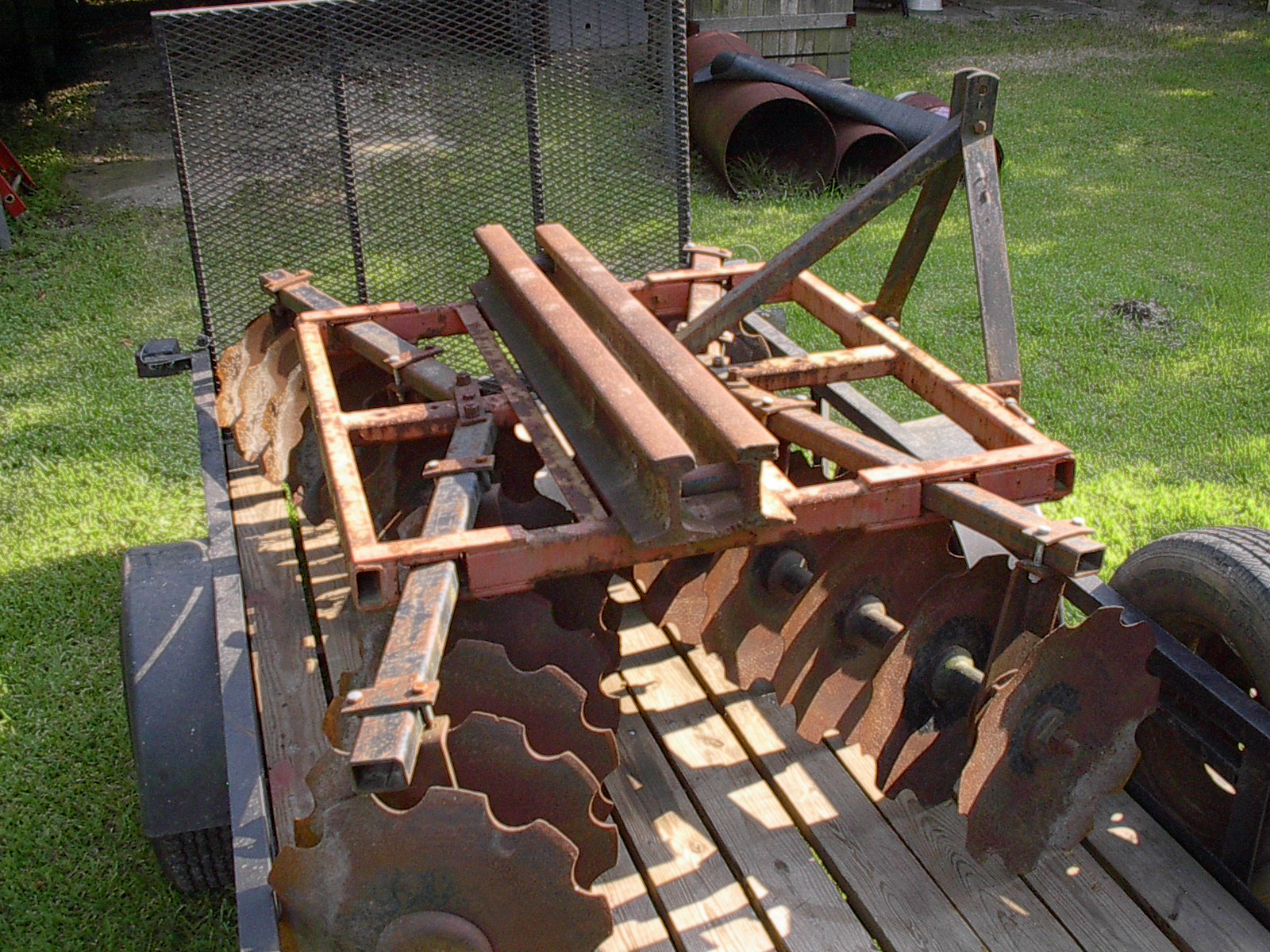

I have a kubota grand l40 3240 4 wheel drive with front end loader on it and I am wondering if i could accomplish much with a set of 5 foot disc for smoothing out some old ruts in my pasture. i have a box blade but can't seem to get much done with it. any suggestions would be greatly appreciated

Extend the scarifiers on your box blade and add more weight to it. If you can't break up ruts with that, a disk isn't going to help. Finish off with a drag as the others have said. Or just fill them with your loader. :rolleyes:

no Box blade in the world is going to break up the sod clumps, The plow turns it under and exposes new soil but short of a rototiller the sod will clump in anything I have tried. I am talking a mowable pasture not simply knocking off the ridges.

If you get a heavy disc, you can break up any thing short of concrete with it. It may take 10 passes but every time a disc blade hits a clump it will slice off some of it. Get a disc with scalloped blade rather than smooth and it cuts better. Most of the 3 PH disc are rather light framed and may need to add a few concrete blocks or some railroad steel like mine. I dont know how much it weighs but to get it off the trailer, I had the use the curl on the bucket, the FEL boom wouldnt lift it. I then had the trailer pull out from under it and lowered it till it was just off the ground. THe rear tires were practically floating. It is an 8 foot disc and give the YM4220D all it wants. It will remove ruts, brush, grass etc but even this thing wont do it in one pass. Just keep cross cutting or diagonal cutting those ruts and it will fill them in. I would make 2 or 3 passes in the direction of the ruts to get some loosen soil and fill in the ruts some, then diagonal across them or cross cut them or both. If you have a drag behind your disc, like a log or an old railroad steel works great, it will smooth it out as you go.
