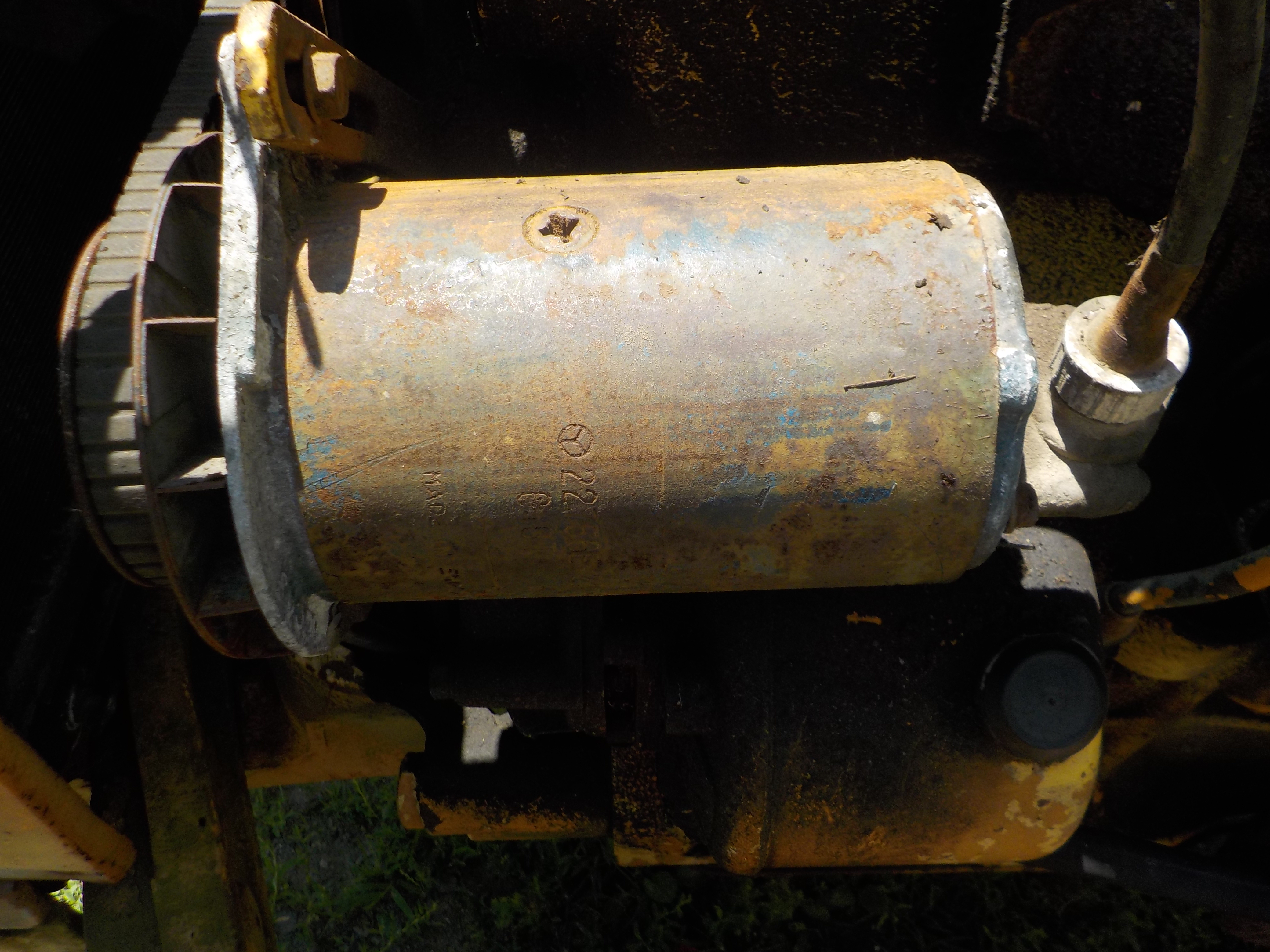

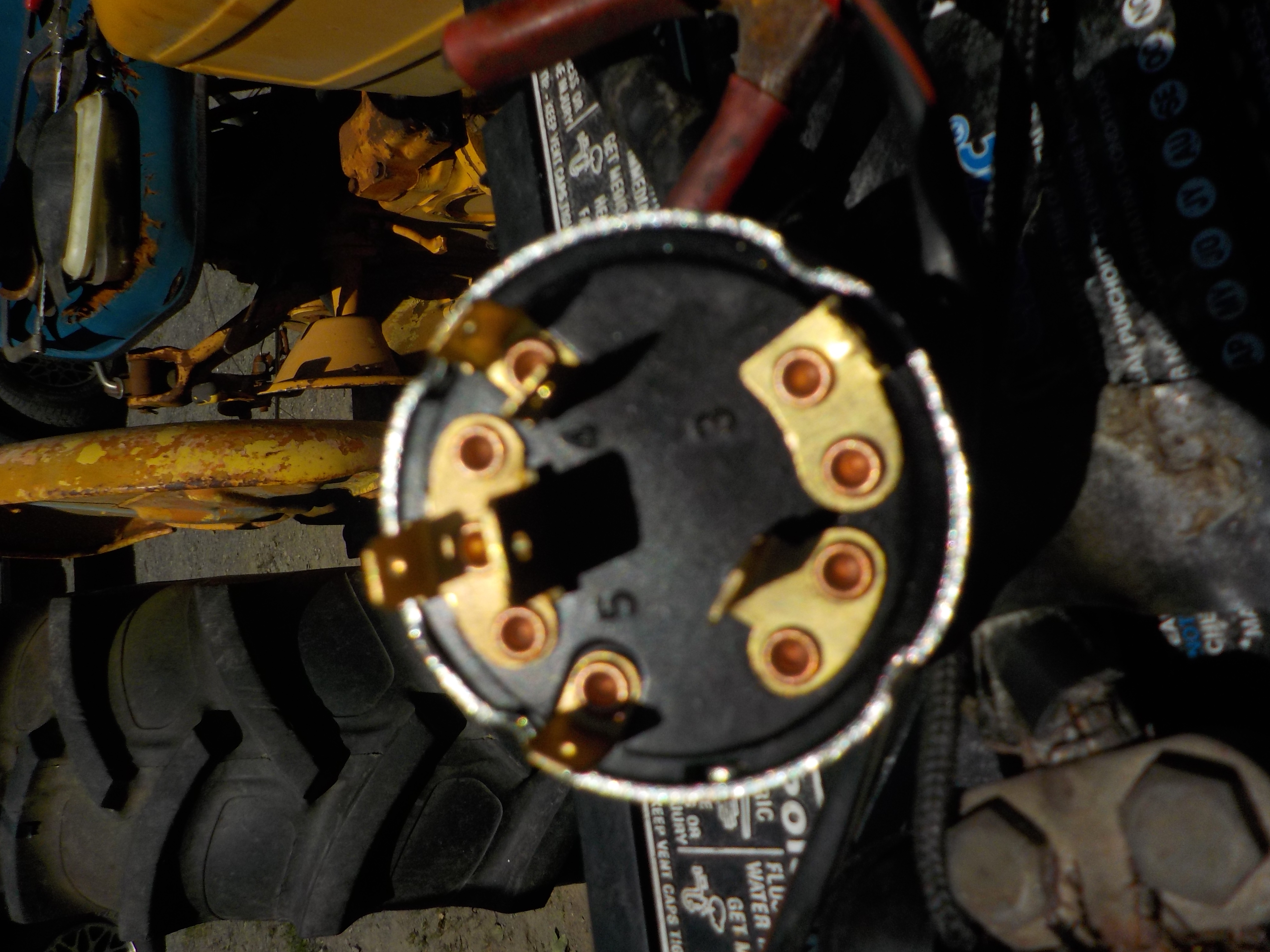

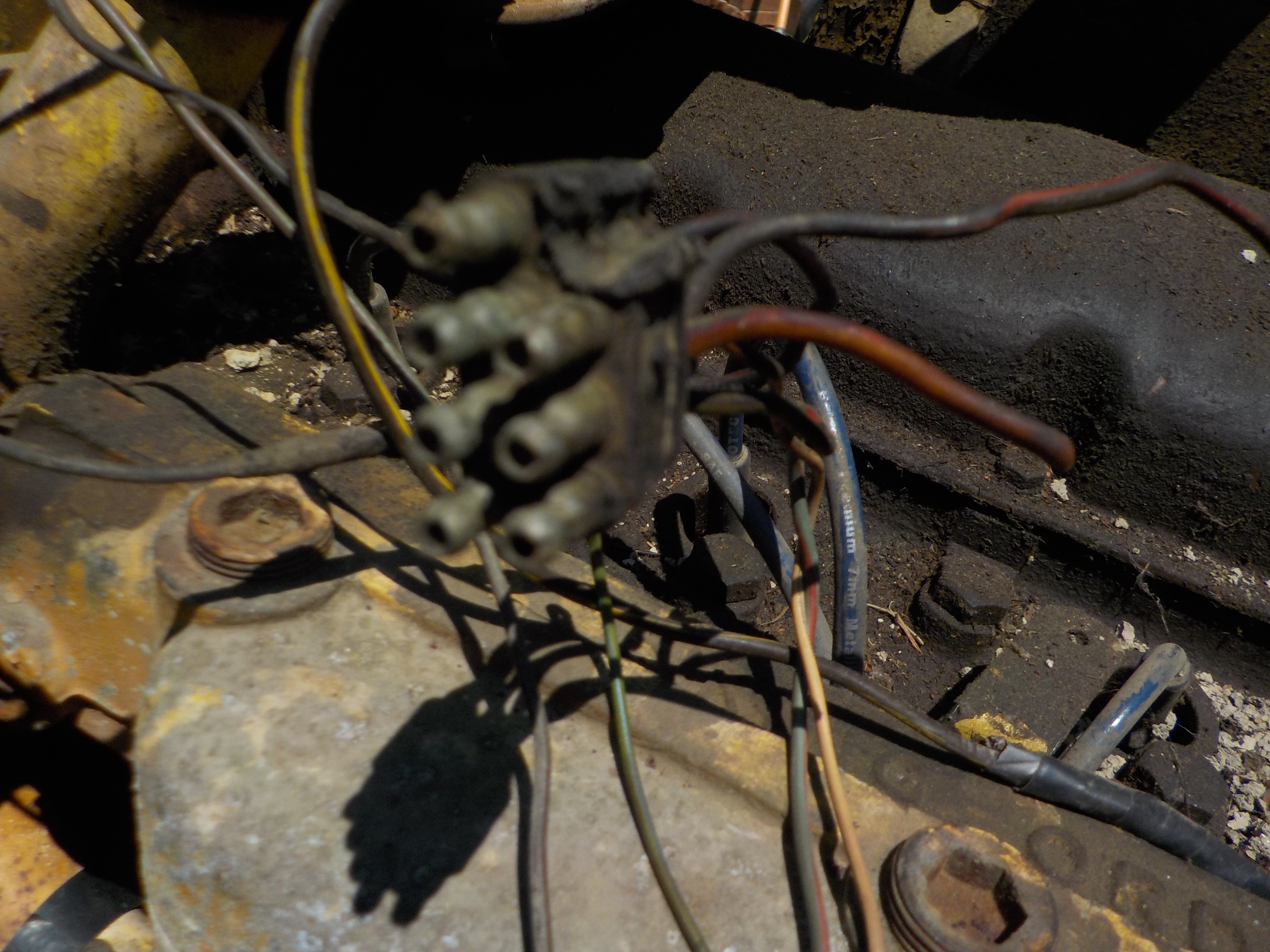

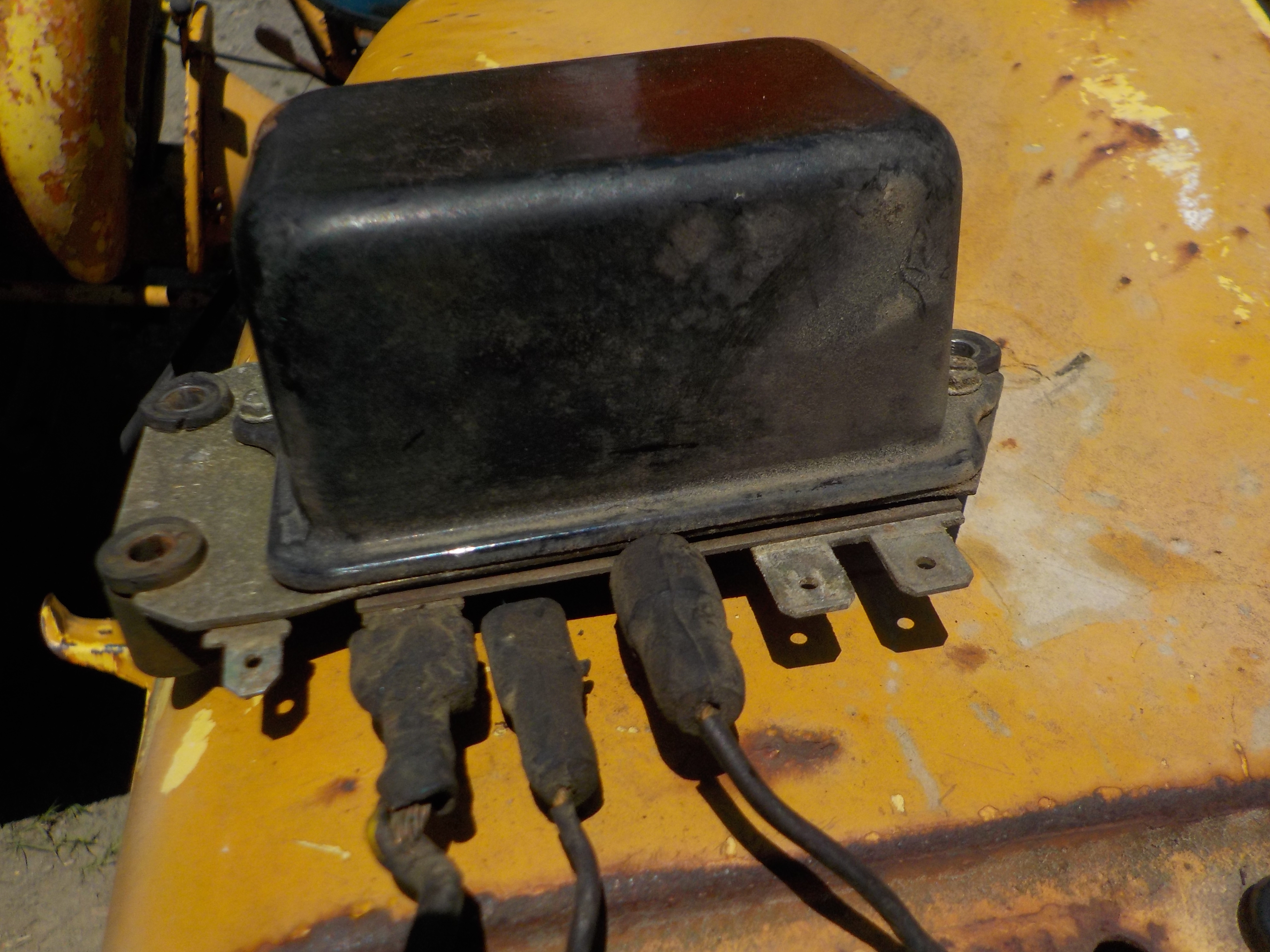

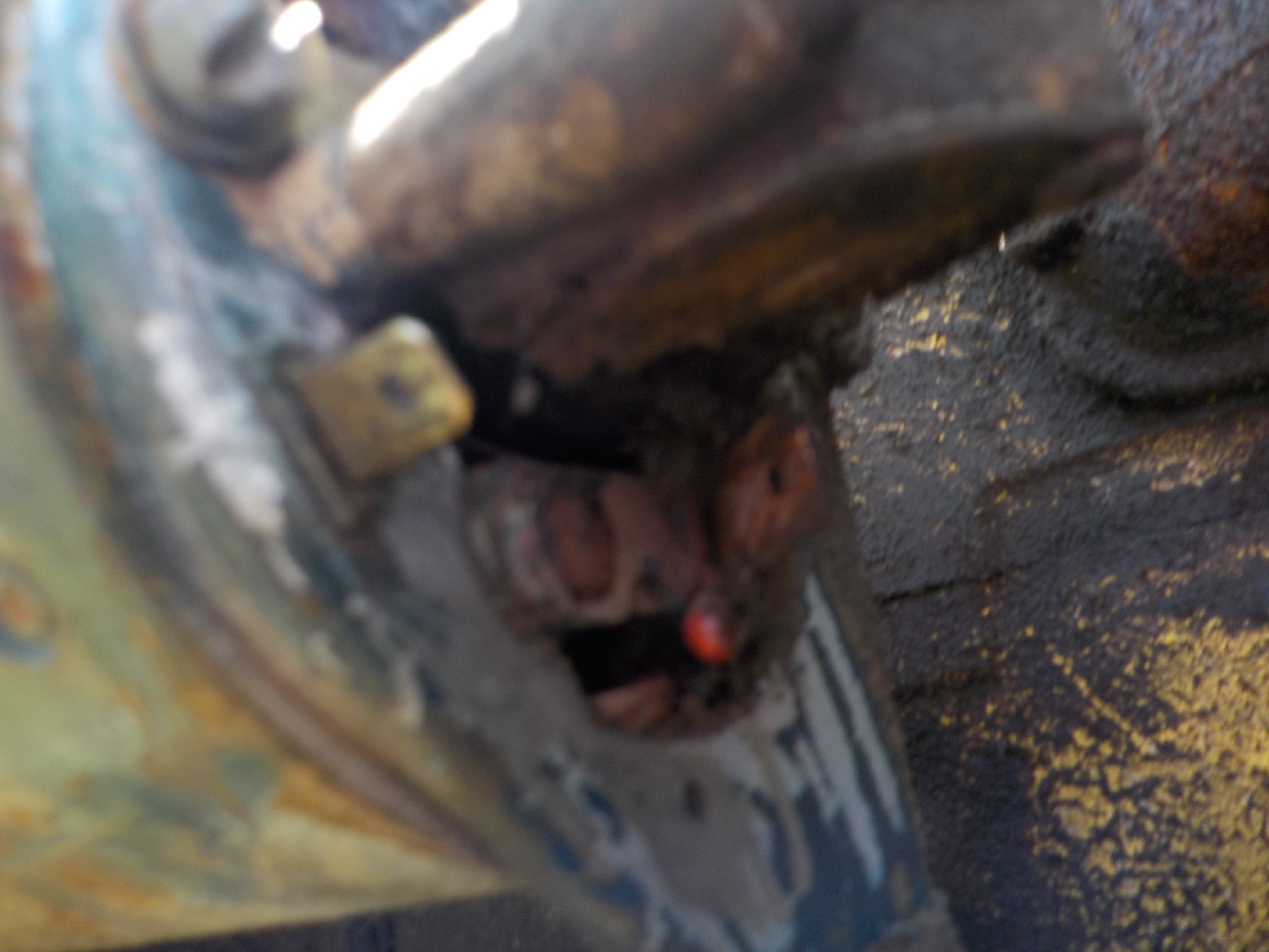

Placed this in the General repairs and Got No Response, Thought I'd Try Here..
1972 FORD 4011 LCG Tractor : I am looking to install a New IGNITION switch and Repair / Replace the whole wiring Harness which has been abandoned and taped up by the previous owner for reasons unknown, lot of Taping Up of wires.... I have looked on Steiners for a Replacement Harness and can't seem to locate the right one,*** I am NEW to FORDS***
I have made my own wire harnesses before for many IH Farmalls , fairly simple to do but this one is a little different , different Genny & Regulator as well as Key Switch, which I'm NOT familiar with, and so I just want to be sure I'm not gonna FRY something. PLease see the Pics and Video Link Below for a up close look at what I'm dealing with.
The Generator has only 2 Prongs, 2nd Pic Hard to See But Trust Me Just 2, and BOTH are Unmarked, The Wire Harness ciming from the Genny has a 7 PIN Plug in Connector?? As Does my New Ignition Switch Coinsodence?? And the Regulator is a 6 Pin I have looked at Many Scematics on Line and Can NOT locate ANY with this 7 PIN PLUG or this exact Genny Anywhere at all ... Most Genny Scematics I found were for 6 Volt Positive Ground, Most 12 Volt I found were for Alternator systems, Could this 7 pin harness be wrong? could it of been added by someone?? I just don't know but I am at a loss here.
Anyway, Any and all Help would be GREATLY appreciated. I want to get everything working again but DON'T really care about the IDIOT lights, as I plan on installing Gauges and don't need the fuel gauge either.
Hopefully the attached Photos and Video will Help Solve this Mess.
Thanks Guys, DanO'

Everything you report' is standard wiring on a 4000, 3 cylinder Ford. I can get a schematic for you, but the part number for the front harness that covers the engine with the harness connector and regulator plug is C9NN14A103B. Google it and you can find aftermarket for $53. on up.
   / HELP with FORD 4011 Wirering Please
Thank You for the info Tractor Tech , I found all the Scematics I need on line and I've seen that harness for as much as $89.. I was quite surprised.
A total of 10 wires, none more than 2 ft long, that's a Rediculous price I think .
I believe I'm gonna just take the time and just make my own as I have in the past, one wire at a time, using 10 & 12 Gauge Wire.
Thanks again, I appreciate Your Response, DanO'
