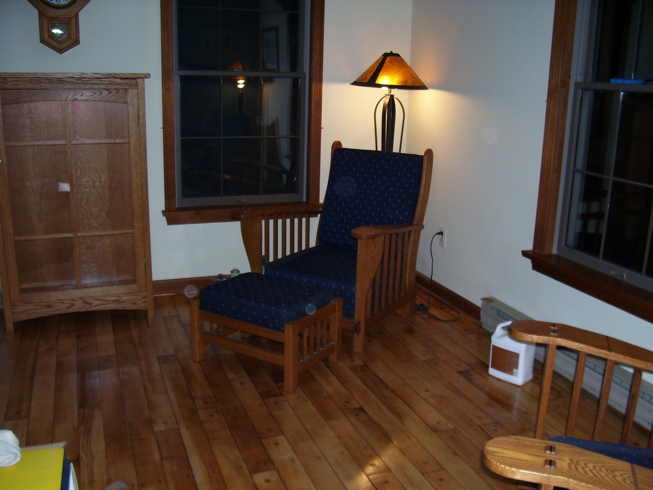

Also maybe you might want to consider refinishing the floor yourself. I rented the equipment from HD and within a couple of days I was done. Its not rocket science and was fairly pleased with the results. I had a lot of water marks on the old maple floor from when the kids were small taking off there snow suits and wet cloths and also from when we spilled water filling the Christmas tree base also.
I will try and paste a finish picture of the floors in one of our front rooms.
BTW This is a satin finish.
