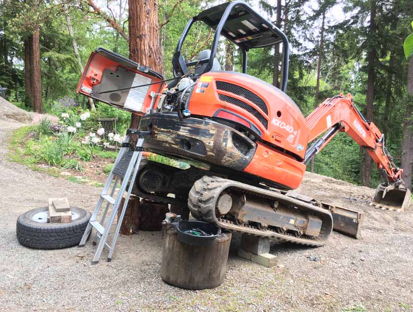

Had to do this to get to the fuel pump.

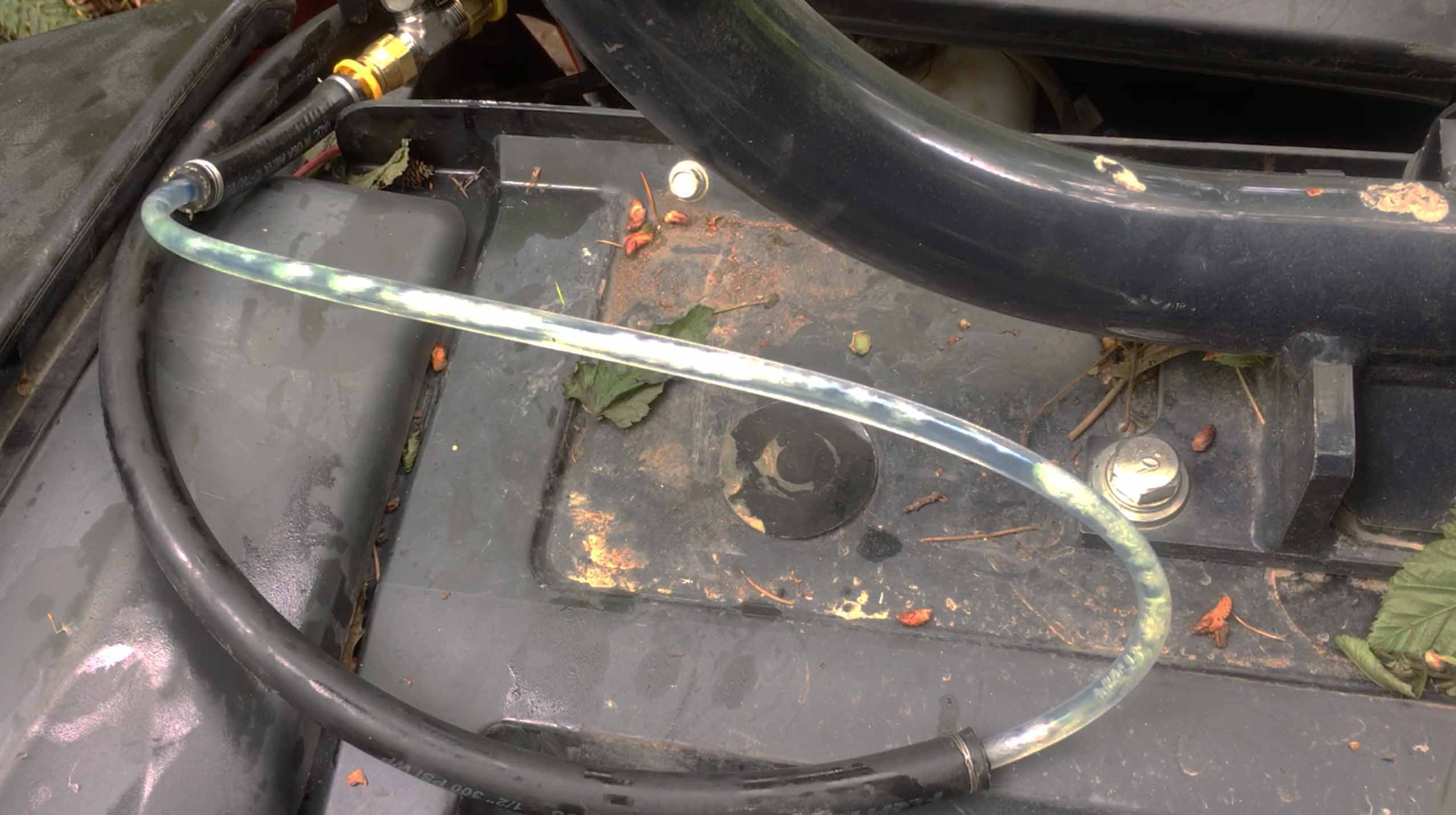

To observe the fuel on it's last leg from the filter into the injector pump I added a section of clear hose.
All that air is going into the injector pump.
It runs, but stumbles when you try to do some work (I suppose when it opens the throttle)
I bought the shop manual, and as usual, I should have bought it last week.

The water separator is on the suction side of the fuel pump and I'm "pretty sure" it doesn't leak.
I removed the fuel tank and cleaned it out super clean.
There was nothing in it but a tiny bit of water and sediment, real clean.
Now its so clean you could eat out of it.
So what I need help with now is, how can I find where the air is getting into the fuel system?
It must be on the suction side.
It doesn't drip any fuel when shut down.
Do I pressurize the suction-side and spray soap on the hoses?
Are there any tricks to find an air leak on the suction side of the fuel system?
