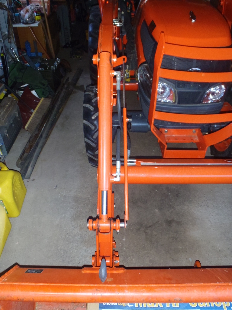

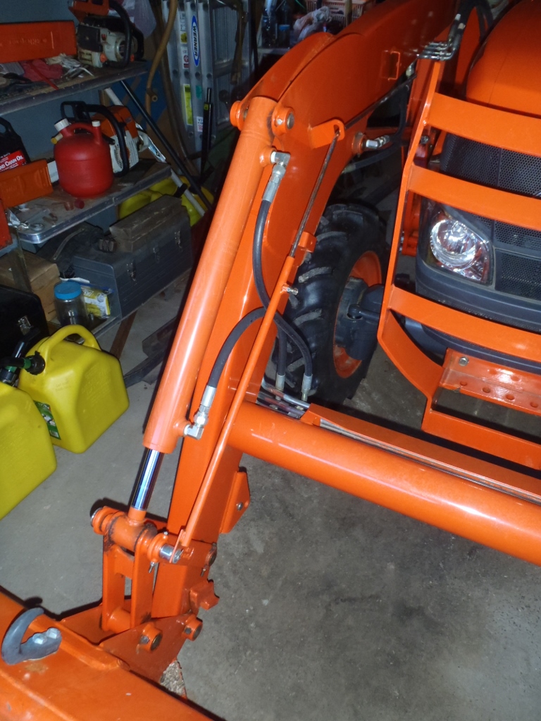

Hi,
I'm new to this and need help finding a picture that shows how the bucket leveler should be attached and routed. I bought my Kubota L3240 in 2007 and Kubota does not have a good picture of this item. I have looked everywhere including Messicks!!! :(
I am beyond frustrated. Would someone be able to assist me, please?
Thanks
   / Help with LA724 Loader bucket leveler placement picture #2
Welcome. Are you taking about the steel rod on the right loader arm? If so I can take a picture tomorrow of mine.
   / Help with LA724 Loader bucket leveler placement picture #3
My L3240 is an early 2007 model, so hopefully the same arrangement:
