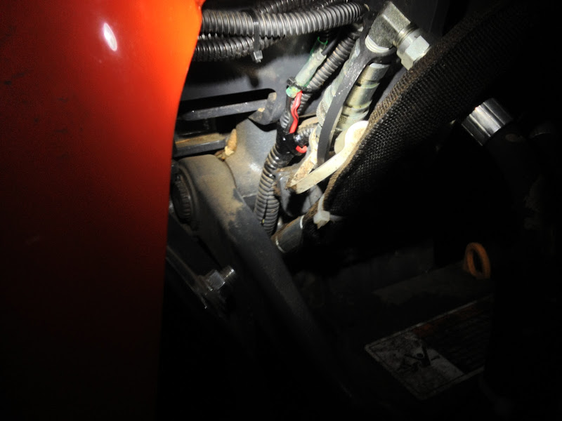

happy holidays to every body have'nt been on in some time .
need help finding the wire or the plug to install work lights on the bx25
is it under the seat or the fender ? can't see it . Any help will be well appreciated. thanks
   / help with lights #2
If you can't find it go back to the switch and trace it from there. A test light should tell you what color it is and you can follow the loom til that color comes out. Or just add a new wire.
   / help with lights #3
Should be under the left rear fender....taped up to the other wires.
   / help with lights #4
I believe this wire (hot) comes straight from the 20 amp fuse marked "Working Light" on the fuse box cover, not from the switch. Mine was wrapped up in black electrical tape behind the seat, over the 3ph. There are actually 2 bullet style connectors, one male (ground) and one female (+). I have four 55 watt lights running off mine which will be in the neighborhood of 15.2 amps to 17.6, depending on whether the engine is running or not. Hope this helps.
Dean
   / help with lights #5
on my tractor there were two leads (red/black), each with a bullet connector on the end. they were totally wrapped in, and concealed by, electrical tape. when standing behind the tractor they were attached to a loom that comes up the center/left, not far below the toplink connection, just below where that loom branches off to feed the left tail light. look for a bulge in the loom and more electrical tape than you see elsewhere. hope that helps.
   / help with lights #6
Mine were just where HeLa has pointed out. As noted they were completely taped over with black electric tape to the existing wire loom. Had to cut/remove the tape to expose the wires.
