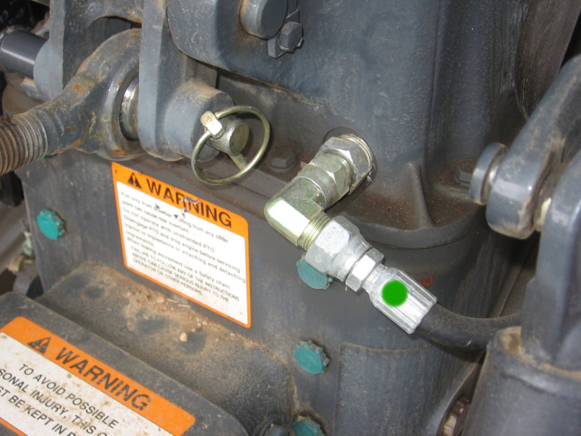

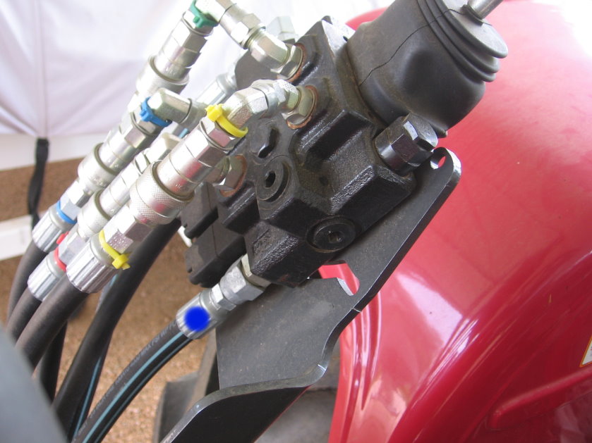

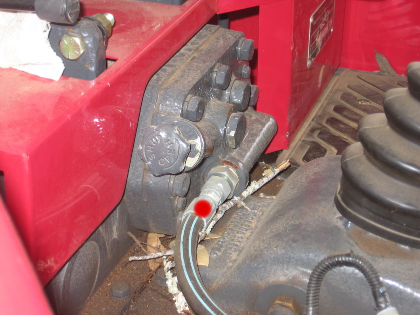

Thanks for the fast reply Guys,
Since I really don't know anything about this stuff, I took these pictures that may help. The hose marked in RED and the one marked in GREEN on the valve, picture #1, terminate as shown in picture #2 and #3. Not sure which one is pressure and which one is return.
Picture #4 the blue dot line goes back up to the pump. But also it shows some plugs in the valve are these something I can use for the log splitter.
The log splitter has its own control valve so all I need is a supply and a return quick disconnect setup. But I don't know how or where to add the lines. Any help would be appreciated, Thanks again.

   / Help with Log Splitter install on Mahindra 4025 #5
Either way is OK.
You will need some long hoses with QD 's on each end
If you want to use the curl UP circuit on the FEL, just add QD's to the valve and hoses, that will match up to the log splitter, then it is a simple process to unplug the curl cyl and plug in the log splitter hoses.
Then bungee the FEL valve curl UP position to open.
The valve is marked such as IN, OUT, PB, Work port A and B.
It appears you are using PB to route fluid to the back.
Did you mark the hoses, or is there a color code in your manual.

   / Help with Log Splitter install on Mahindra 4025 #10
That picture tells all .
If you want permanent connections then I would install a remote valve, and plug the log spitter into the remote.
Least expensive, and semi-permanent would be like I said earlier. Install bulkhead bracket and connect a male QD and a female QD to it.
Remove the PB hose from the side of the tractor and connect it to the male QD on the bulkhead bracket.
Make a new hose and attach it to the female QD on the bulkhead bracket and the other end of the hose would go to where you removed the original PB hose from the side of the tractor.
To use log splitter, plug the splitter into the QD's on the rear bulkhead and split some wood.
When you remove the log splitter, make a short hose with male and female QD's and connect the bulkhead QD's together, and that will complete the hyd flow path to the 3pt.
Second solution and more safe, is to replace the log splitter valve with a log splitter valve with PB, and connect the log splitter PB out to the 3pt fitting and run the tank line to tank.
