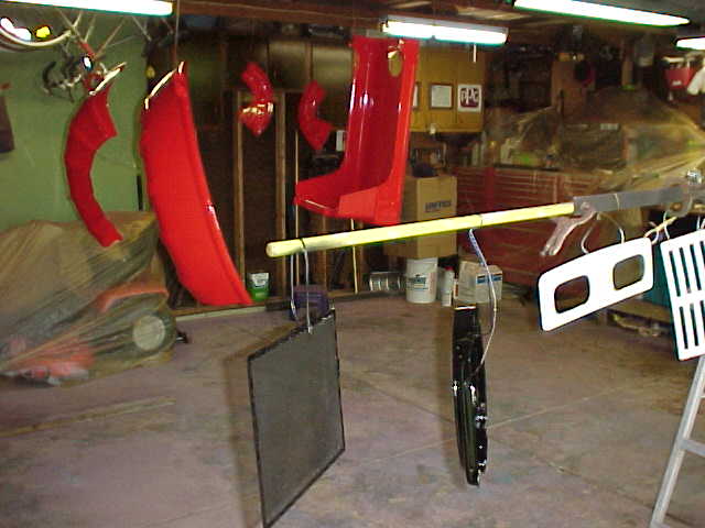

Thanks to all for the help. I am finally getting over the obvious mechanical shortcomings and now I am focusing on the body of the tractor. I have some fairly bad surface rust on the body parts. I have tried Ospho and other similar rust products but soon after the rust returns. I want to do it right this time. I have run into a place that will powder coat the parts. I explianed the rust and he told me he would "take it down to the metal" and start from there. All body parts (Hood, fenders, etc.) for $225.00.
In addition, Somebody "rolled" the tractor at some point because the fender is bent up. I bent/banged it back with a hammer and a two by four. Needless to say it's far from perfect. Are you supposed to do something special when you do this? Heat up the parts before bending and banging?
   / Help with Paint Job #2
To straighten metal you're supposed to use metal body straightening tools, like a hammer and dolly. But this is not something easily learned without practice. I suggest a body shop. They can do it quickly and for a reasonable cost.
   / Help with Paint Job #3
I think the price quote you got for powder coat is only for the top coat and maybe primer . You still need to repair the sheetmetal. If you apply body filler , will the powder adhere to it ? Can the body filler be heated like the powder is ?
I used good old sand blaster and epoxy primer followed with bc/cc urethane. Just painted this today.

1700,
Powder coating does an excellent job and is as they say just paint in powder form. Absolutely True. High line powders contain acrylics, urethanes and UV properties that are added to powder pigments and are very durable (as durable as sprayed) and last for years.
There is a downside and it is BIG: even the slightest imperfections in metal can not be filled with the best products available, ie Bondo, Putty and 2 part fill and build and epoxy primers. It has been tried many times, but as the process needs heat. Metal warm up time (preheat) starting at 325-375 and curing at approx 400 lifts fillers off, powder will not stick and all adhesion is lost.
It is almost a lost art to prepare metal without the aid (cheating) of thin sandable fillers. It takes hours to "metal Finish" fair parts with spoons, picks, slappers and files. With all my contacts in the trade I cant think of one that would take on the smallest project without large compensation ($).
You might consider better used sheetmetal if yours is very bad or A shop that will rough out your sheetmetal resonably ($) and you use the filler and experiement by shaping and sanding. If you are piticular you will have great results. BTW if your powder coater does basic lawn chair and patio furniture - ask alot of questions as the price quoted to you is very, very reasonable. 6hot/8cold, good luck and regards, Mark

Beautiful. Looks like my place, parts hanging everywhere. And I think I have the exact same PPG sign (next to an old DuPont clock).
