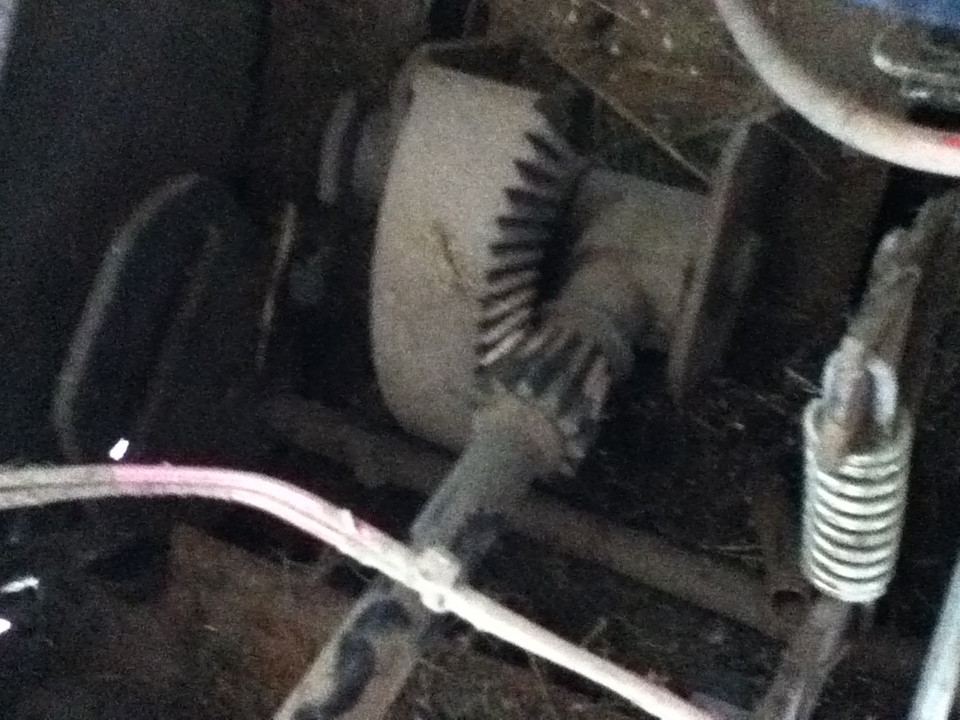

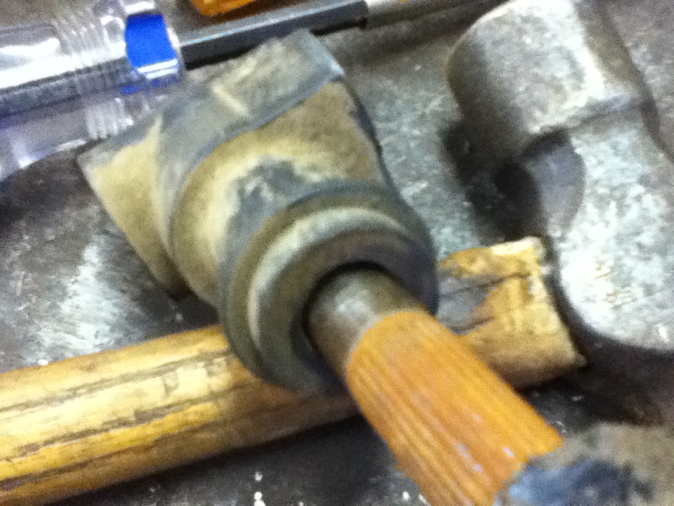

I have had 7 riding mowers that I can remember, still have 3. :laughing: I did it as a project, fixing up lawn tractors and selling them ready to work again. Which place are you getting the lawn tractor for? The place in WA or CA? Since I have taken apart so many lawn tractors I was able to figure out where things wear out.
First off is the steering gears:
Steering gears in newer lawn tractors are routed directly from the steering shaft to another gear. Craftsman uses a system which uses two angled gears that mesh to turn teh wheels left and right. The steering shaft sits in a plastic boot that over time wears and eventually due to the way the gears mesh the lawn tractor will only turn left (like nascar :laughing:) It is a cheap system and it poorly designed, at least it is located within the lawn tractor, fairly protected from the elements. mower.
John Deere's L and LA series is no better. They use gears that mesh in awkward angles between the mower deck and the frame. Over time being exposed to moisture, dirt, small rocks, and lawn debris these gears will no longer meet and the only way you will be able to move the lawn mower is by pulling up on the steering wheel (happened to me on my L118 :ashamed:). It is not easy to get to the gears either, deck must be partially removed and the front of the tractor must be lifted off the ground to provide decent access to the gears.
Also make sure the ball joints on the steering rods are in good shape, when they wear out since the rod is upside down it will fall off the worn ball and the front tires will suddenly turn in opposite directions. It is not easy to move when this happens. Fortunately it is fairly easy to fix.
