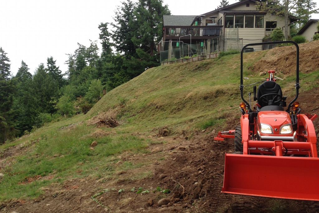

I have several hundred feet of glacial till (hard rocky ground) to trench to lay water pipe around my property. I have looked on line at BXpanded and BroTek products and I own several products from each company and can attest on the quality and usefulness. But what else is out there? That said, I am wondering what experiences you have all had. I thought about building my own but too many projects and think this is one that I ought to pass on so I can get 'real' work done. Help!!!

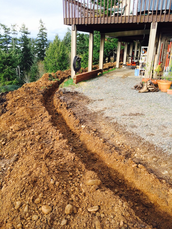

Thanks HeLa... actually my BX has done quite a bit of trenching... (100+ feet already). I just don't want a 12in wide ditch as I will be tearing up a gravel road I made a couple years ago. Most of the 'boulders' are softball size or smaller. A few may be volleyball size... those I know will be a pain in the arse if I don't catch it right with the trencher.

Well, I have about an acre of pretty steep land that I want to supply water to instead of long hoses and auto timers. I want to tap into my main water line before it enters the house from our well. A couple hundred feet or more to run down to my wife's garden, install a few risers around the property and also a Rainbird lawn/garden watering system. I have done some trenching to my greenhouse near the house but I want a much narrower ditch than 12in wide that makes a serious mess to get down to the lower part of the property that is flatter and where the vegetable garden and lawns are at.

Steep it is. You need dynamite and a dozer to level things off some!:laughing:
Try MIE, (Michigan Iron & Equipment); they can size a ripper tooth like I have, that will get you trenching a path just wide enough, but not as wide as 12".
They do custom work, that would fit your hoe to your specs.
