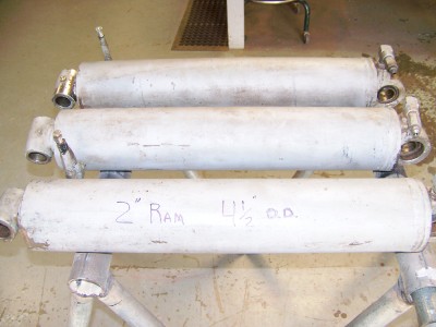

I had three of these fall in the back of my truck from work. They used to be hooked up to a field tarp lift and we did away with the lift so I snagged them thinking I will use one of them for a splitter. Can anyone tell me what size they are. Thanks

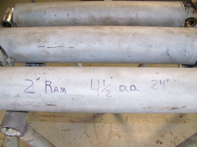

Did you write those sizes on the cylinders?
Are they indeed 2" ram with 4-1/2 OD and 24" long?
If so, then (I'm guessing) the wall thickness leaves a 4" cylinder with about 18 to 20" stroke.
Assuming 2,000psi for the hydraulic system pressure, that would give you a 12-1/2 ton cylinder.
If your hydraulic system pressure (psi) is more, you'd have more tons and visa versa if less, less tons.
Formula is [(pi)(r squared) x psi]/2000=tons of pressure.
Speed of the cylinders depends on the gpm (flow) of your hydraulic system.
I think that's right...

The correct answer is written on the cylinder, except for the pin size. Maybe 1 1/2 in

Thanks guys. I guess I should have ask what the lbs or tons were. I got these things free and figure some time down the road I could use them for something. Im just now trying to learn about hydraulics so bear with me. I did put the numbers on them and they have no stamp or markings. They did loose some fluid so does that hurt??
   / Help with size #7
If you mean they lost fluid out of the port holes while they are off ... no. No problem.
Just seal off the ports with a plug to keep debris and other crap from getting in there.

Yes. And thanks. I did cap them off last night.
