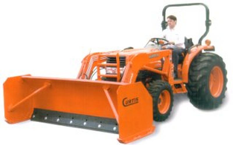

I've been using a FEL plow for a couple of years and they are hard to beat. I'm sure you could get by with your light bucket idea, but you should be able to find a plow in the $2000 range. My 7 1/2' plow with hyd angle was barely over 2k including shipping to my dealer. You can also get them without the hyd angle for less money, but I would spend the little extra.
There's a post from someone in PA selling a Curtis FEL blade from a TC45, Over in the NH Pricing forum.
http://www.tractorbynet.com/forums/new-holland-buying-pricing/138721-curtis-snowplow.html

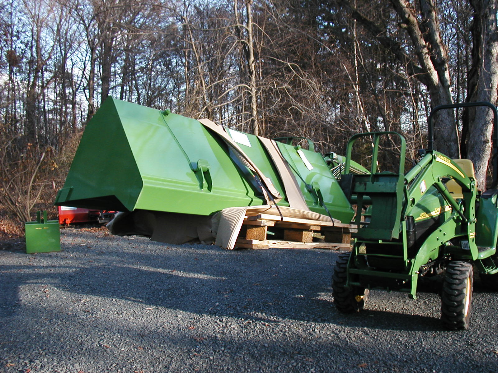

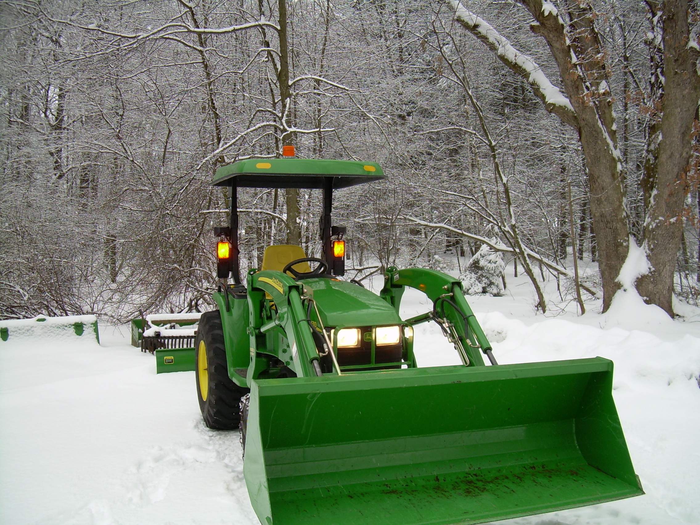

I did exactly what your thinking about, I to thought first about a pusher box either buying or making one but instead I got the light materials bucket.
My standard bucket was 61" and the light materials bucket is 73" but is taller and deeper, definitely speeds up snow removal efforts and can be used for other tasks unlike the snow pusher or even front snow plows.

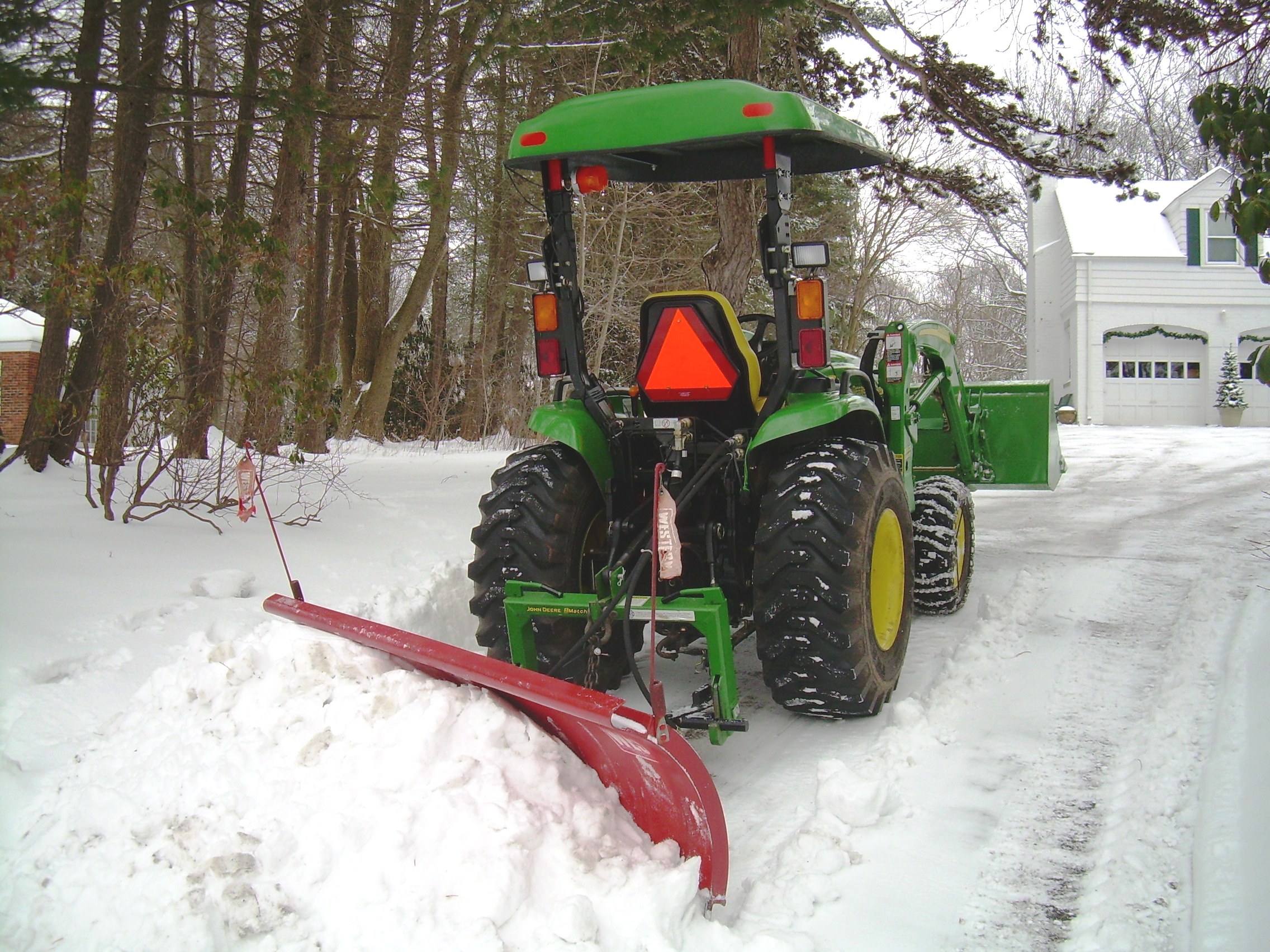

This year I concocted a rear power angle plow from a truck plow, it is great to be able to push snow off to the side instead of having to pick up every flake with the bucket. Pushing snow alone will build piles quickly, that's where the bucket comes in.
If you can get a power angle set up on your rear plow and the larger bucket you'd have a great combo. Try and get the bucket with replaceable cutting edge, mine doesn't have one and it's wearing down, since I started using the rear blade more I'm saving the bucket edge considerably.
Are you saying the light material bucket your looking at is 8 inches wider than your 6' bucket, or is 8' wide itself. If it's 8 ft wide and taller and deeper then that may be a bit much for a your machine, especially if you heaped up a bucket of heavy snow, what's the lift capacity of that loader? I'm able to lift heaping 6' bucket no problem with my 32 hp ~1500lb loader lift capacity JD.

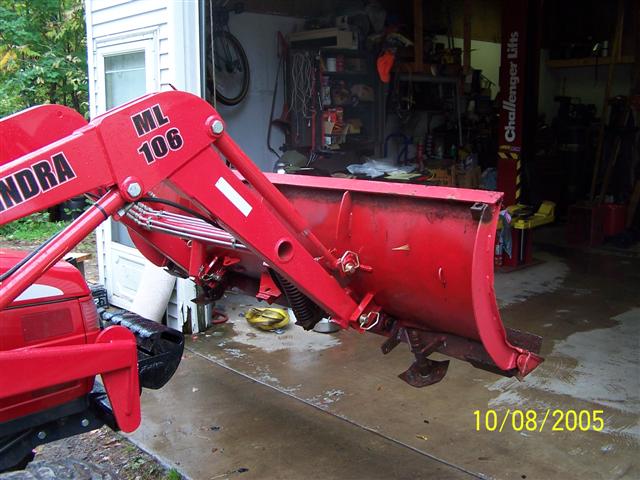

You could find an old truck snow plow blade and adapt it to fit your quick attach on your loader arms. I don't have a quick attach / detach but my bucket detaches with 4 pins then I attach an old truck plow blade (see pic). I use this setup through the first half of winter to straight blade plow the snow and have now switched back to the loader bucket for moving piles.
This summer I plan to convert my truck blade into a pusher by adding sides similar to the one in the second pic.
I got the old blade from a friend for about $100 and welded on brackets to where my loader arms attach. It's worked for several years now. There are several companies that sell the quick attach brackets that can be welded onto an old plow blade to make it fit your setup.
