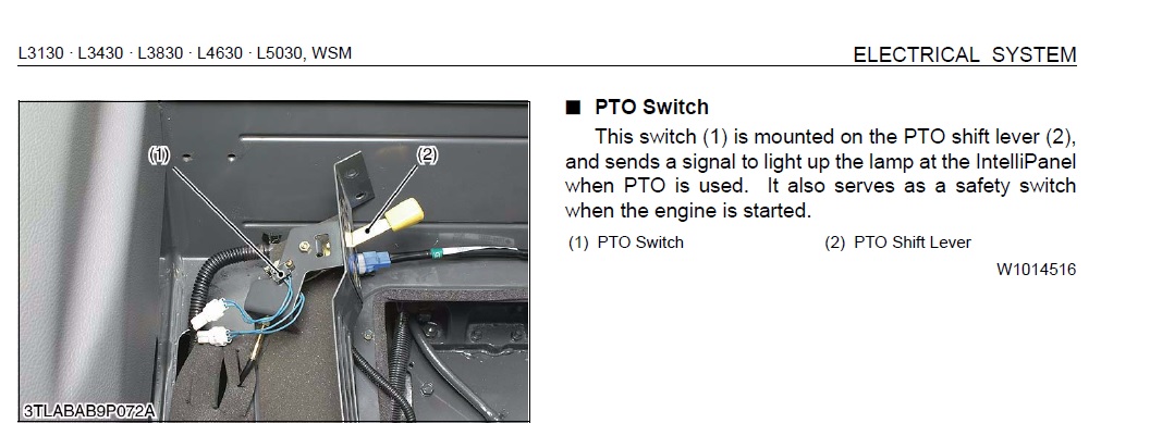

   / Help with the PTO display on my L3130 #6
Suggest you check the simple stuff first like the pto switch
See photo of WSM page
Dave M7040

Thanks for all the responses I will check the switch and let you all know how it works out. Thanks John
