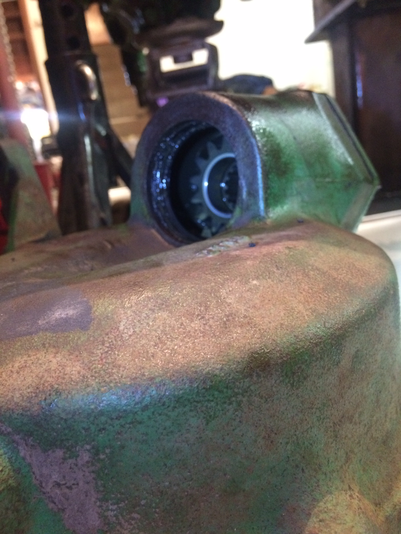

I have a Yanmar 3110d that has the old style seals in knuckle. There is lots of info on the new style but I can稚 find much on the old style. There are 2 seals that are suppose to go on. When I pulled it apart I only found 1 seal.
Do both seals go inside the front lower gear box (#2)?
Or point me in the correct way I am suppose to put these back together...any help is appreciated!

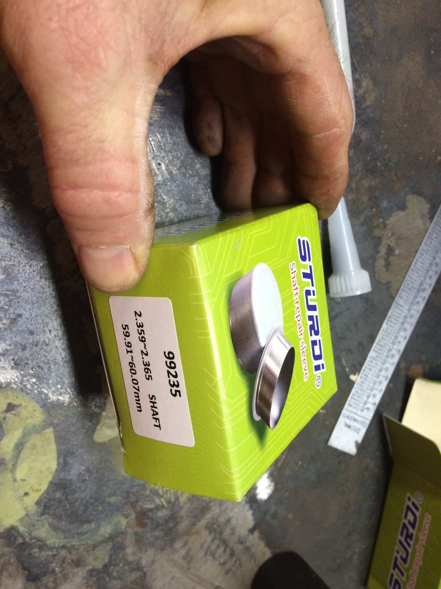

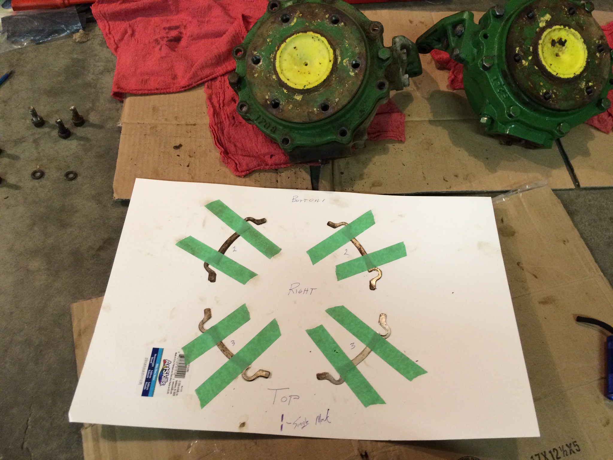

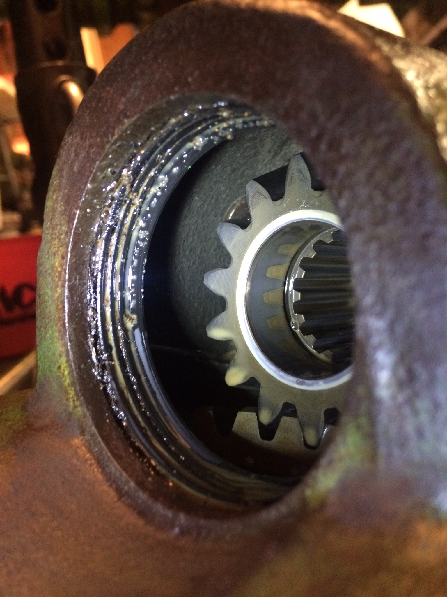

It’s been a while but I think I had the old style in my JD 950. They both go inside the lower housing. Be sure to keep track of all shims and reassemble as removed. I also had to install a sleeve on the knuckle shaft. I didn’t like the Hoye sleeve as it was thick enough that the hole in the housing would require enlarging. I wasn’t about to cobble up the housing with a die grinder and I don’t have a mill.

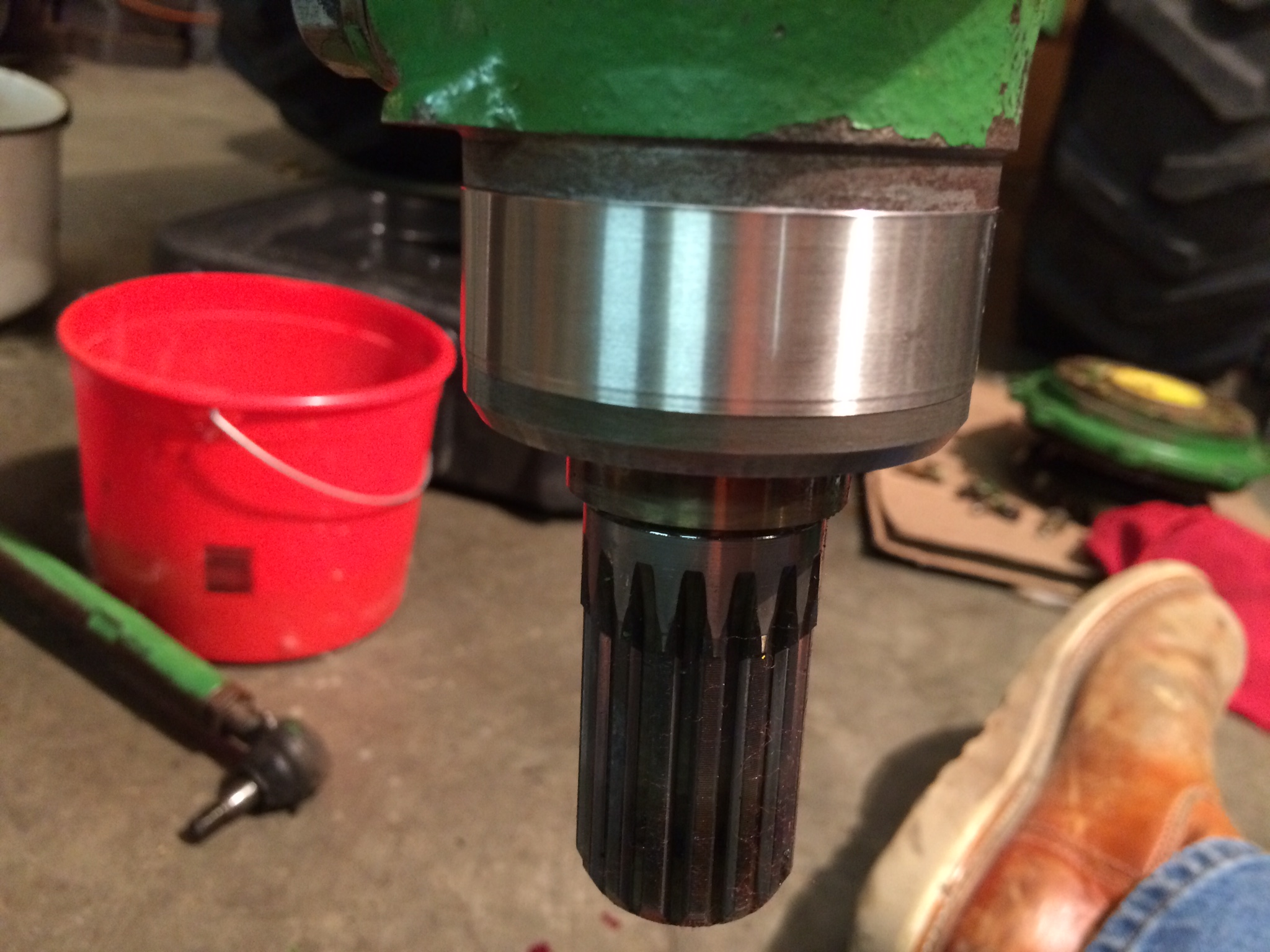

This is the sleeve I used. Worked perfect and did not require enlarging the hole in the lower gear housing.

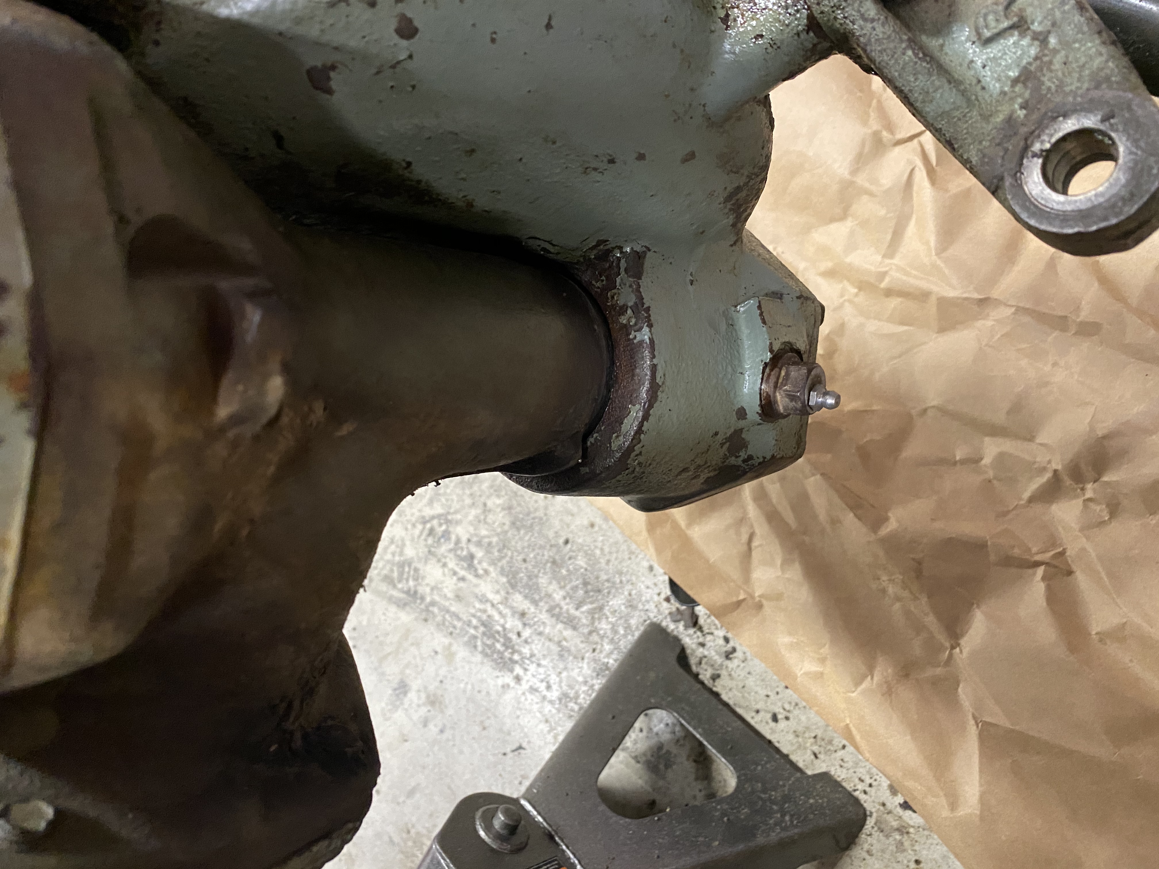

Someone sometime ago added a bunch of grease zerks to the drain bolts instead of replacing the seals, any ideas on getting the grease out they pumped in or just add the oil and run it?

Yes that is correct. They pumped everything full of grease. They put bolts with zerks anywhere the drain bolts are. The area where I replaced the seals wasnt really too full and is clean now. The portion of the gear box that the rim bolts onto can pulled apart. Maybe I should do that to clean the grease. I just donthave those seals.

Bolt with grease zerk

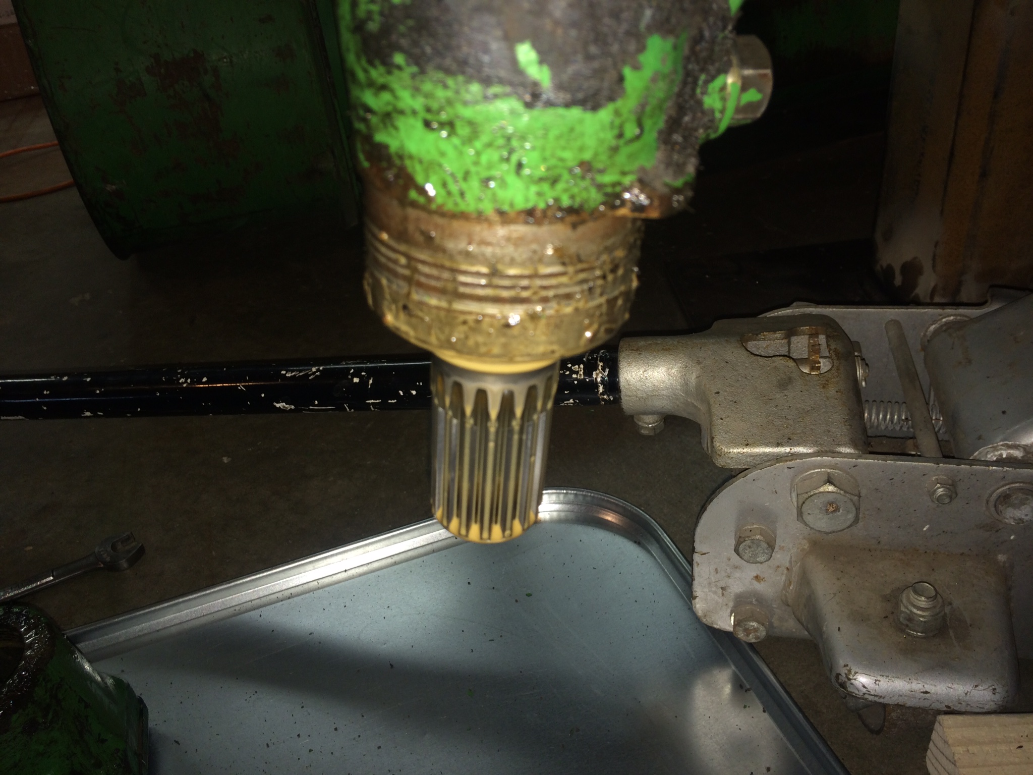

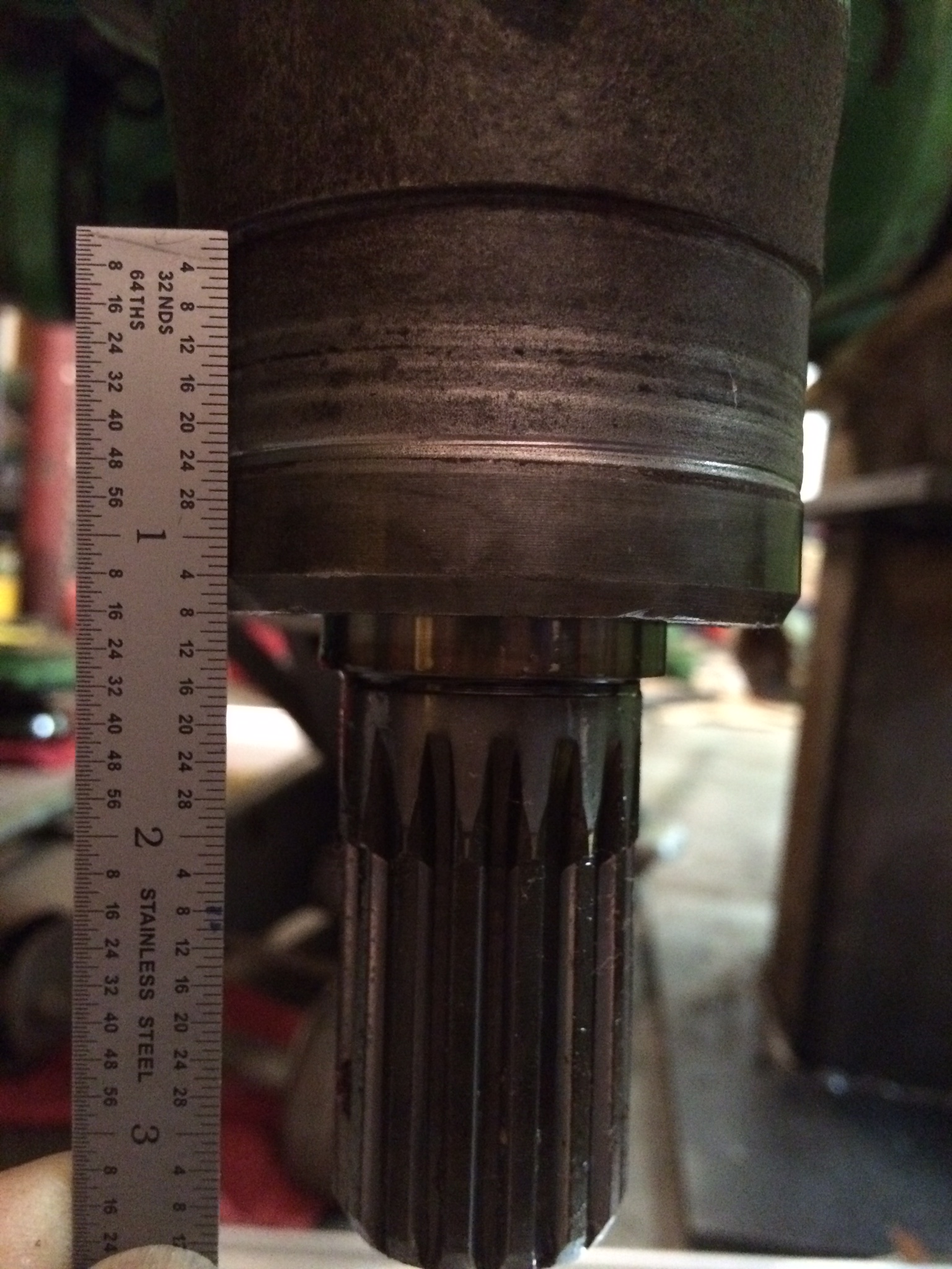

Wow, that sealing surface is ugly! The sleeve is thin enough that you will use the same seal. You will need to make some sort of driver but even pvc will work. Don’t feel too bad, I spent the evening pulling the transmission out of my 2017 Silverado with only 115K miles. It’s always something!

Got the sleeve ordered today from a local bearing company. Ordered the bearings from for the hub from hoye. The sealing surface almost looks like there was a sleeve put on it once before. The bad looking spot is raised slightly. Just above it measures 60mm. Makes me think the raised part is a sleeve. I’ll see how it cleans up when the parts get here.
