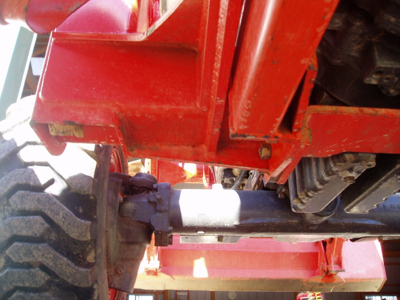

Don't know if it helps, but here are some photos of my tractor showing the FEL subframe. Don't have really good detail photos, but maybe it will give you something to go by.
The tractor/FEL setup is larger and heavier than your L2500, so you may not need to use exactly the same materials. The subframe is mostly 1/2" and 3/8" plate. All the attachment points to the tractor are 1/2" material.

Thanks for the reply and it does help a lot on what thickness of steel to use and the pics show me where the loader mounts.

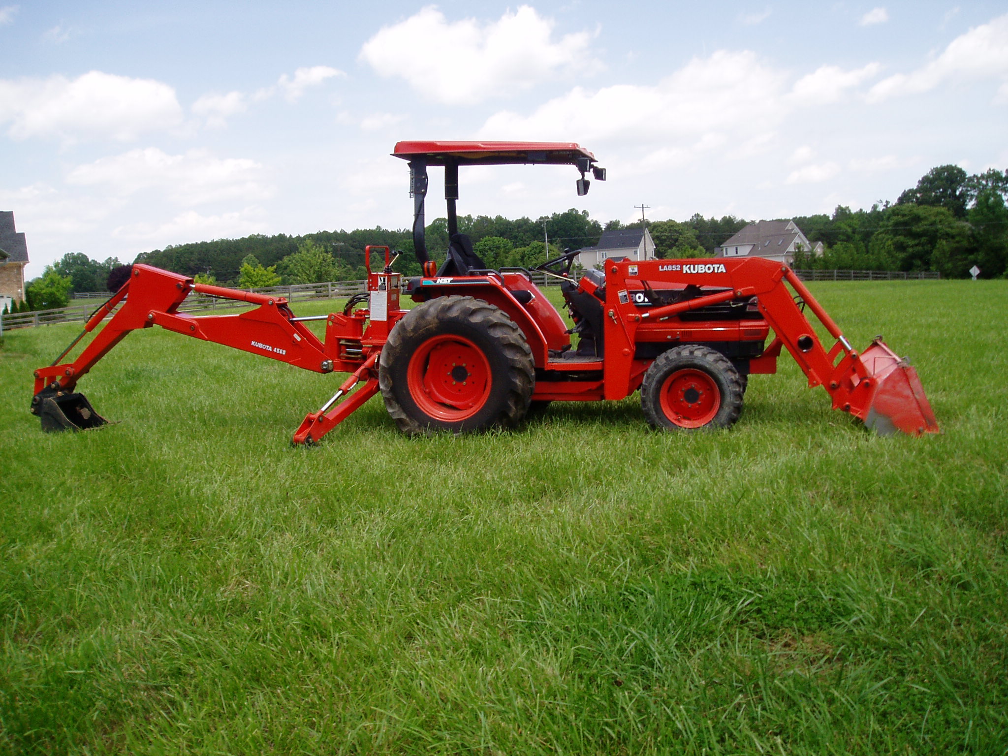

I would love to put some pics of sub frame I built for FEL la350 that I mounted on a L2500DT tractor.
Took me a few weekends but will do final weld this weekend and paint
Can someone help me with posting pic of sub frame?
Thanks Cal
   / HELP ???????
Back Again,
Ok all I have posted a few pics of sub frame under LA350 loader today's post
If anyone needs measurements let me know.hanks Again for everyone's help
