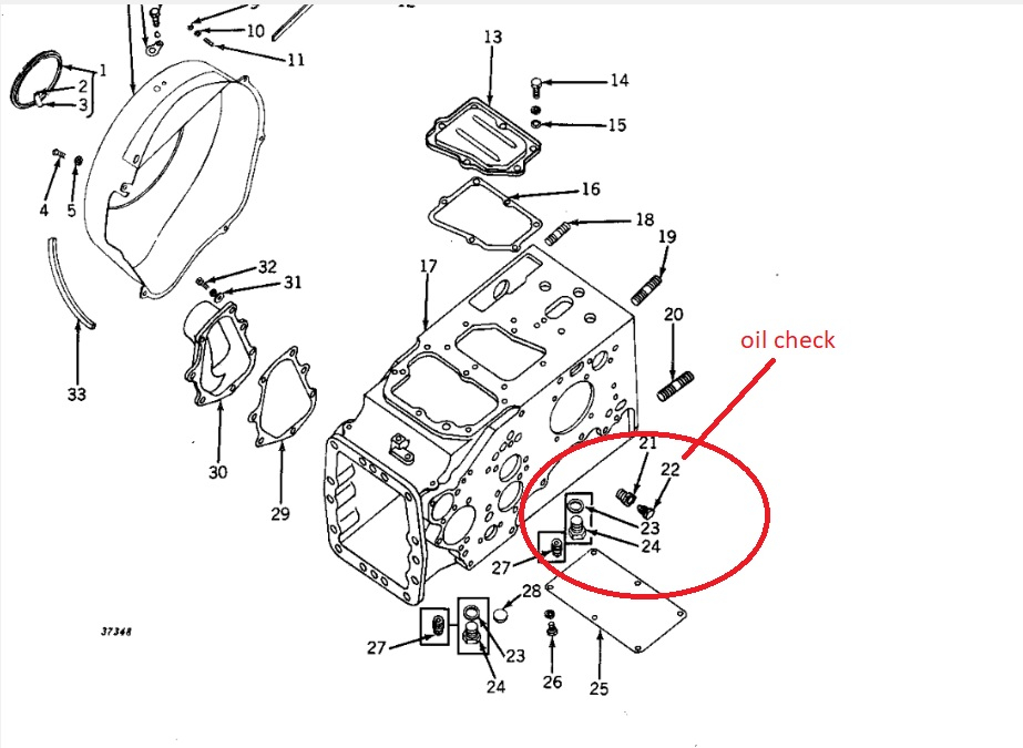

My son n law inherited this jd50 and I have several questions about it.
1) How do we check the engine oil level,,, we can not find a dip stick.
2) We want to rebuild the carb,, is there a fuel shut off from the tank....we do not see one .
3) Where if any is a number located for the carb so we can get the correct kit
4) Would we be better off exchanging for a rebuilt carb vs working on ours or is just up to ourselves personal choice.

Sounds like you have the engine oil figured out. The two cylinder JDs are well worth fixing up.
On the carb, don't let anyone talk you out of the original carb. They were designed to be rebuilt indefinitely and originals are very expensive.
I would get a copy of John Deere's Service Manual SM-2024 which is a big 8.5x11" printed manual of about a hundred pages with great photos and illustractions. Covers everything on all their two cylinder carbs including how to identify which carb you have. You could build a library of literature that JD published on their 2 cylinder tractors.
Rebuilding your JD carb takes about $50 worth of parts to do a reasonably good job and can be done with hand tools on a kitchen table. Most of the time just taking the bowl off replacing the needle valve, and cleaning the gunk out of the passages is all it needs. Minimal or even no parts required. f you want a rebuild for some reason, that's OK. But keep that old carb. It's golden.
Don't know if there is a fuel shut off on yours. JD used several different fuel filter & shut off assemblies. Take a photo and lets see. When they did have shut offs on the fuel filter under the tank they get old and leaky. So it is fairly popular to interrupt the line down to the carb and put a better quality inline fuel shut off there.
