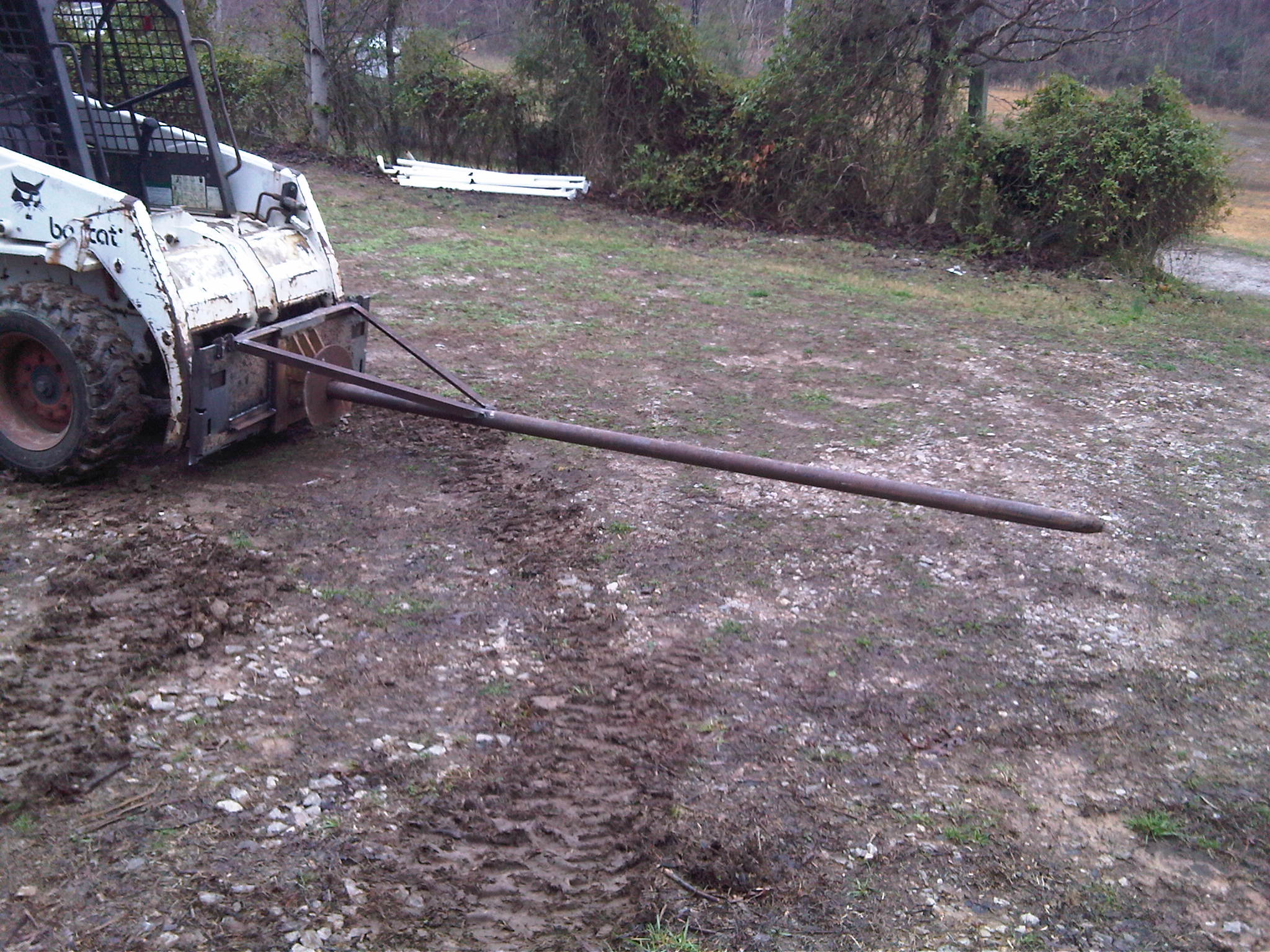

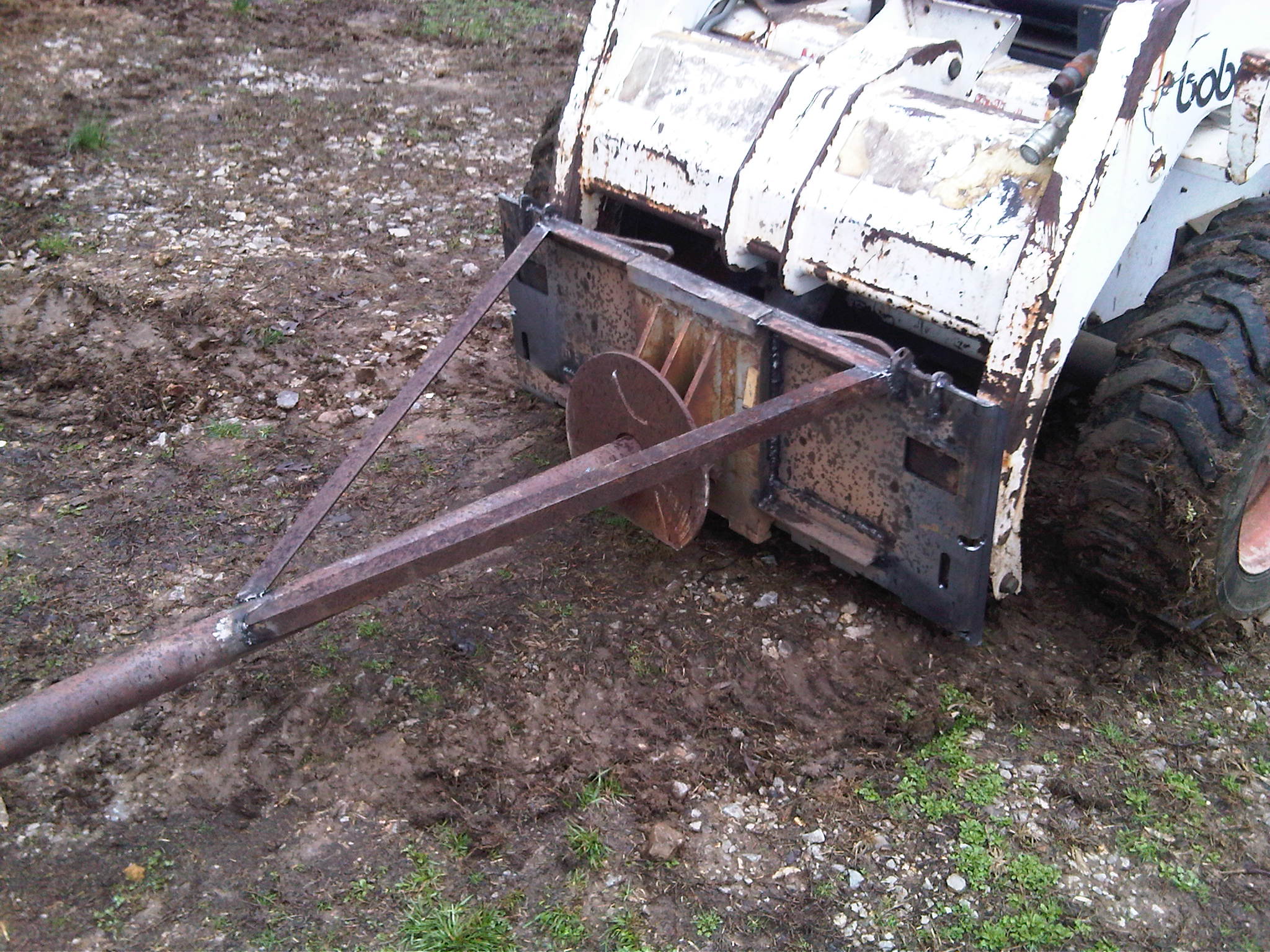

How many of your projects start with an item that you just need to find a use for? :D
I had picked up a carpet rod for a forklift (FREE!!!!!!) a while back and needed to find a "use" for it. Its a 10 foot long solid steel dowel about 3" diameter - they use them to move rolls of carpet.
I thought a boom pole/crane would be handy to lift suplies onto the roof, pick stuff up, etc.

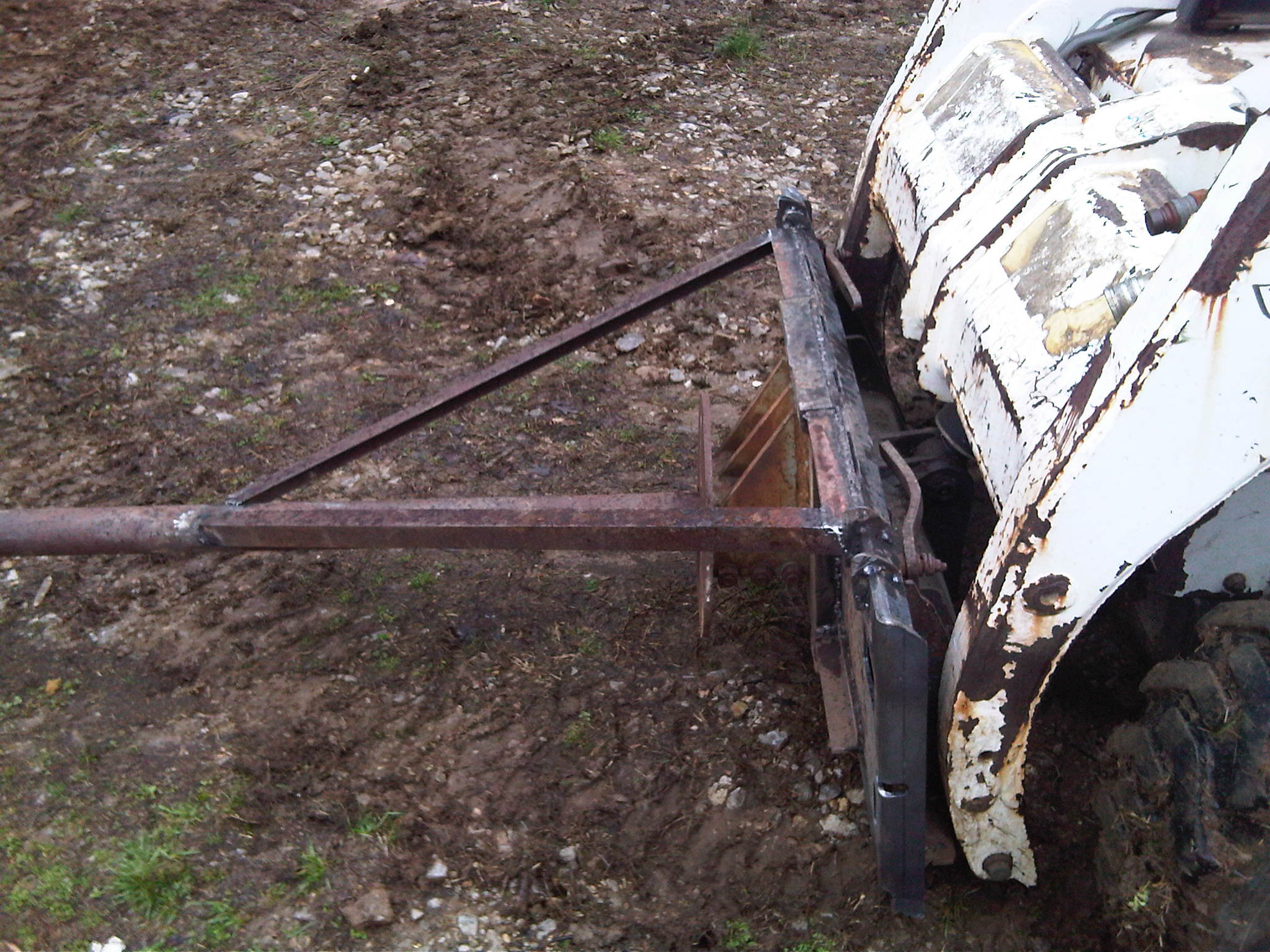

Aside from the skid steer plate (bought it new), this was all scrap and stuff laying around the shop.
I painted it today - pictures were before painting. Still need to weld an attachment point on the end of the pole. Figure I will add both an attachment ring and a chain hook at the end, then add a ring about half way up for heavier lifts.

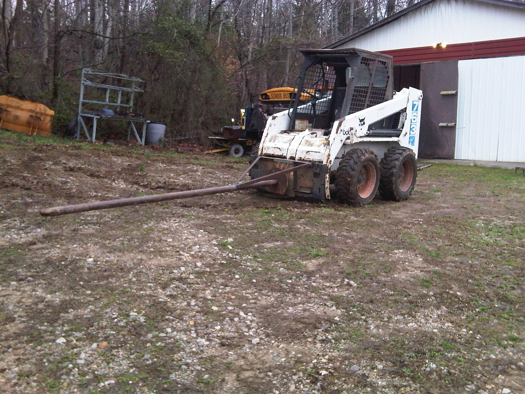

I was initially concerned about the weight of the thing - not sure how much it could lift with 10 feet of leverage plus the weight of the pole. But the skid steer (Bobcat 763) hoisted about 300 pounds hanging on the end of the pole with no problem. I will gradually increase loads to see how much it takes to get the skid tippy - just so I know. But I don't see me lifting really heavy weight with it anyway.
The 10 foot pole, plus the skid's lift gives me about 25 feet at max lift.

Bet that's a stout pole..
Some ideas..
Here's what I did on my tip. I've removable attachments for it.
And added strength with a ring and rebar.

Just keep in mind that it doesn't take very much weight out that far to cause the SS to get a little tippy:confused2:

May want to consider as in the other example putting something long the top Sid to prevent bending when loaded at the end
Not sure about the term but it would be for example some flat rolled stock with a piece of square stock in the middle with both ends of the flat stock welded to your pole
Flat to round my be tough fit but you get the idea
Nice project and a crane is always useful to have around

RCR, thats a good idea about the changable ends! I may adopt that. It will be a bear to drill the hole for the pin though...
I had thought about making a sleeve (tube) to go over the end to give me more height for lighter stuff. That could be one of the attachments, but I don't think I would use more height that often and the leverage of the weight gets worse as length increases. This gets on top of my house and barn ok as-is. Don't see me needing more than that.
As for jousting :)laughing:), on anything but level ground, the skid's short wheelbase gets it pitching front to back with any kind of speed - I would be scared of grounding the end in the dirt as it pitched forward. THAT would be a sudden stop I would NOT want to make!!!
