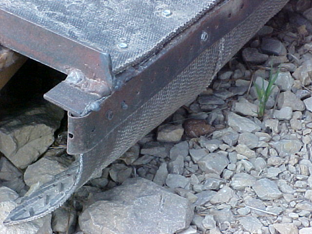

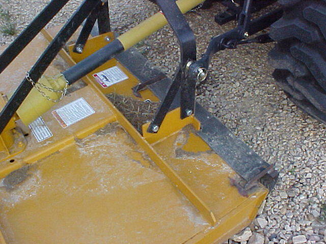

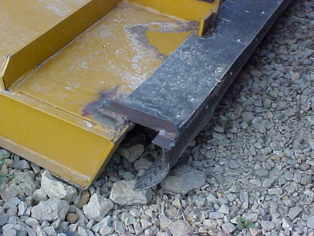

Here's three different pictures of the front guard on my 5' KK brush hog. I just used some angle iron, baler belting, plumber's strap metal, and some self tapping sheet metal screws. Has been mowing all summer and working well. Contains the dust in the mower better than the chain model I built and posted before.

a little closer in

angle iron closeup
