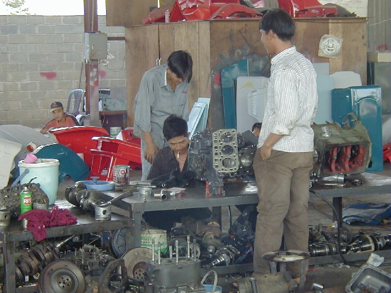

it was Buck from EFC that did the expose on the Vietcong tractors back in the day...
Remember those? Boy were they ever ugly, more like smoke and mirrors for the unsuspecting.
In 2010 my cousin was in SE Asia. I asked him to take photos if he saw a tractor overhaul shop in VN, with Yanmars. Scroll down in this thread. The other posts in the thread are interesting too.
And here are a couple of photos from a shop overhauling Yanmars (and others) specifically for the US market.
