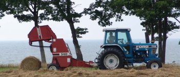

Anyone had any experience with one of these balers?
   / Hesston 530 Small Round baler #2
My neighbor has the Case-IH version of the 530 and it does a decent job. It has not been taken care of the best but is reliable.
I ran the 540 a couple times and didn't have any trouble with it at all. It did a good job with the ruined hay. The field was set to be small square baled and then it rained for a week. When the rain went away I rolled the hay over twice and used the 540 to pick the crap up. I wish I could have justified buying the 540 but for my use it just didn't make sense to own a round baler.

They are a good reliable baler that seems to take a beating and keep working. They are a very basic baler that can be run with a 35pto horsepower tractor.
