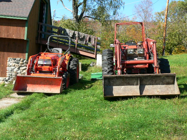

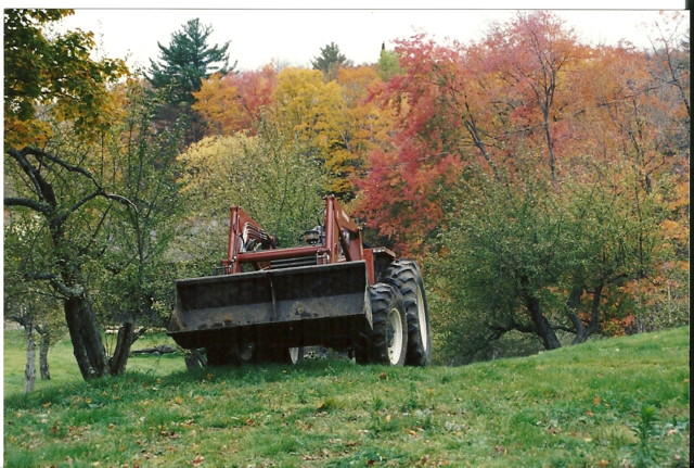

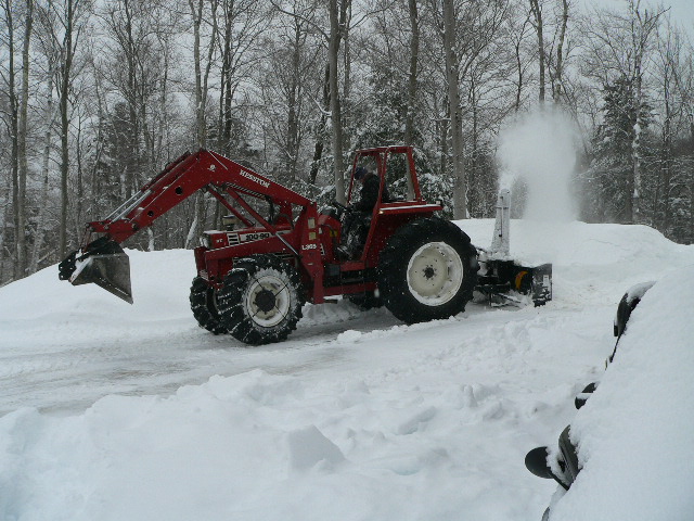

Try sourcing in Canada, particularly Quebec. Those tractors were very popular there and I see plenty of them in the eastern townships between Vermont and Montreal.
I have a 100 90 DT with the loader. Awesome machine.
