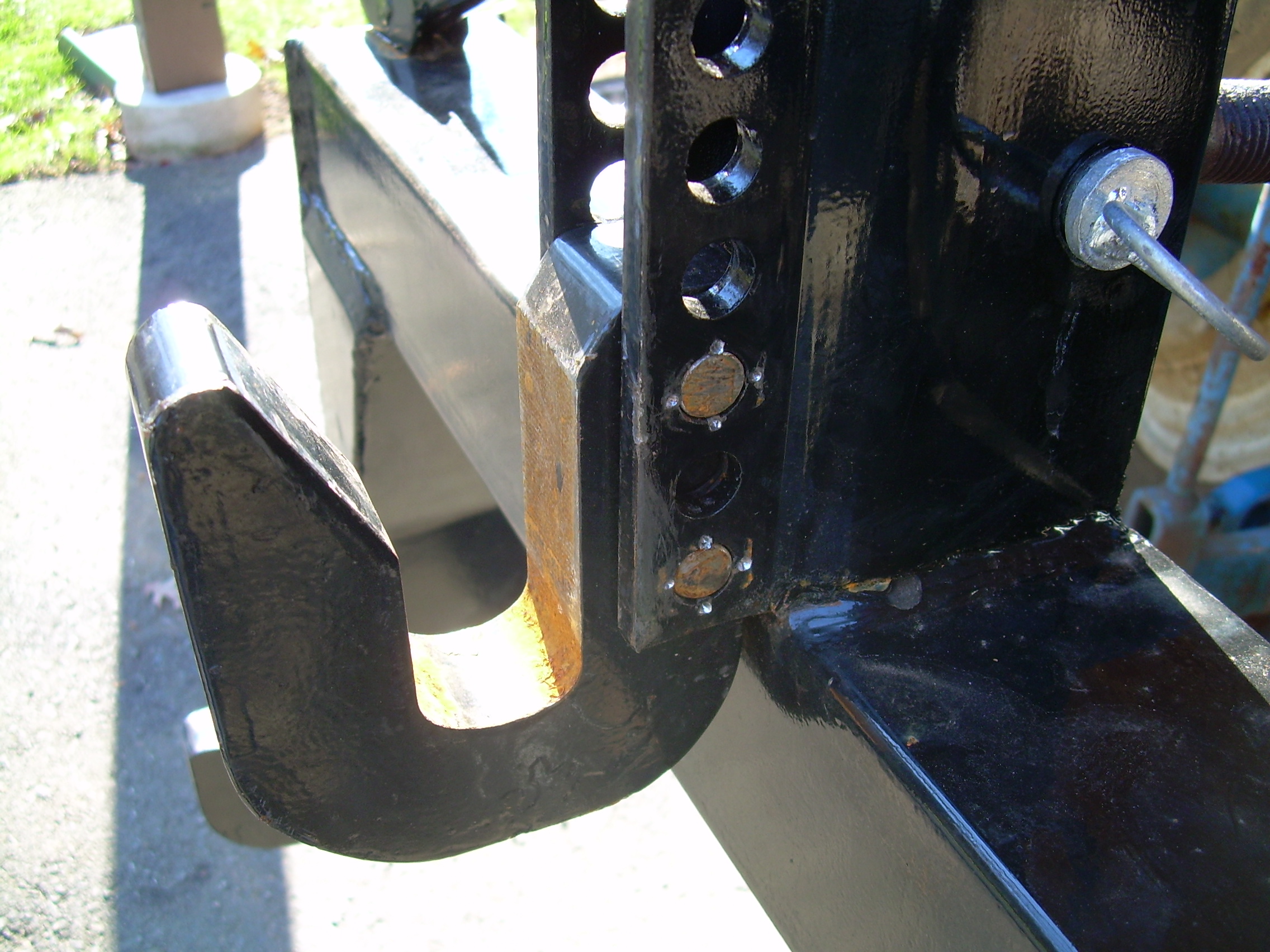

foggy,
I agree with you it's more the hitch that's the problem especially those bolts on the top J-hook, that just doesn't make sense would not fit in a JD rear blade or a Land Pride rake's upper link. These are not exactly off brand/odd ball implements.
I have an i-match for my newer machine, bought all the bushings and had to mod a few things on the implements but everything works fine now.
Then I wanted another QH for an older machine and didn't want to spend much so I got the $89. HF unit, of course it wouldn't work with the I-match compatible class 2 lower link bushings, didn't know that till after I bought it but this is understandable I guess. An hour of grinding later that's ok now.
Then the upper J-hook had to be cut on a bridgeport (still had some credit from my buddy after I gave him a bottle of Gray Goose for other machine work he did for me) to fit the 1.25" top link bushings, then those bolts were the icing on the cake, Yea you get what you pay for, I would have just spent the extra ching for another i-match had I realized how much work the discount unit would need.
JB.
