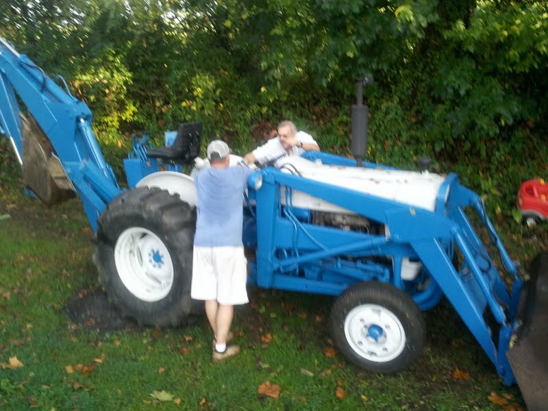

Hopefully someone can help me, I need to know what kind of power steering fluid to use, all fluids really and how much to use. Can u tell me where to find the
id number on the tractor?? anything else that would be useful. Thanks so much!

Welcome to TBN. I'd start a new thread, something like this: Ford 3500, (2xxx Year), which fluids to use?

Nice looking machine, As CM said start a new thread under the Ford Forum and you will have a lot of smart Ford guys to help. Also go buy your owners and service books for tractor, loader and backhoe. Good luck.

rear and hyds and tranny and power steering.. and any external hyds for a loader tank or hoe can ALL use a utf fluid meeting the ford/nh spec M2C134
just about every store brand UTF meets those specs ( read the lable ).
tsc, walmart, napa, etc.

Nice looking tractor with the loader and backhoe. Is it an industrial model?
