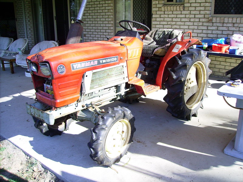

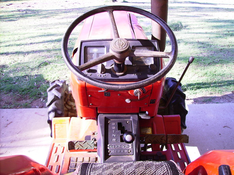

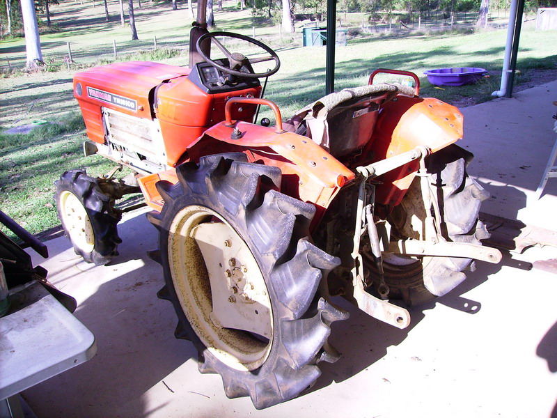

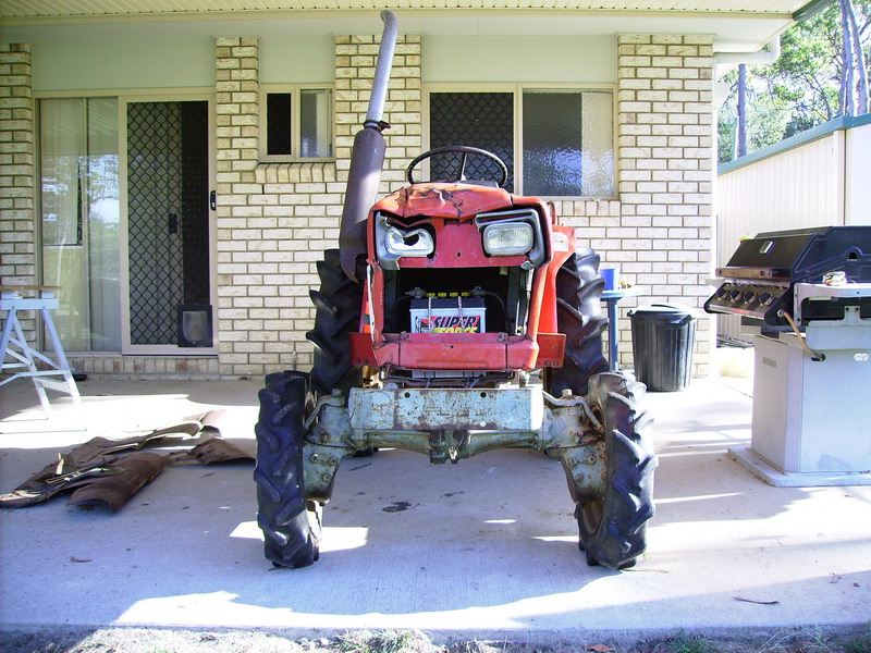

Hi fellow Yanmarians,
Although I have only just registered, I’ve been eagerly reading the discussions in this forum since buying my first tractor a month ago, a YM1810D with 620 hrs on the clock, purchased locally for AUD$3800 (US$2990) which included a slasher (I think you guys call it a brush cutter?), a Yanmar rotary hoe, a single tine ripper and a rear bucket. It had been sitting in storage for a number of years and the guy I brought it from wanted to travel so he was selling his stuff.
As you can see from the photos, it has been rolled, so there’s some panel damage to the front and the radiator supports are a little bent. The engine seems in good condition, which starts on the first turn of the key and doesn’t blow smoke, and the power shift, pto and lift work fine.
Although I’m worried about getting parts down here in Oz, at least I was able to source oil, air and fuel filters reasonably cheaply which was the first thing I changed.
My next adventure is to fix the charging circuit (battery isn’t being charged). The alternator is providing around 22 VAC at 1500 rpm (both when the reg is plugged in or out). I’ve check the ground connection, fuses, wiring (as much as I can figure out). The charging warning light doesn’t come on at all, and I’ve check the bulb, and respective connections. I presume it must be the VR at fault.

The VR will be listed as a current limiter when you try to find one. They are one of the more common items to need replaced. Locally, in the US, some of the Yanmar importers have found generic replacements that are much cheaper than OEM.

After reading a few posts on this forum regarding similar models to mine, I’m guessing that the alternator in the 1810d is the type that doesn’t have rectifying diodes (as they are in the VR??) and no field coil either (permanent magnet instead). There are only 2 wires coming from the alternator and they only have an AC component to them. Can anyone confirm this? (ok I’m hoping not to pull the alternator off and open it up)
I’ll be taking the reg (or limiter) which I suspect is at fault to an auto electrician this week, hopefully to find a compatible replacement. But after speaking with my neighbor who is a mechanic, he suggested that this type of alternator (one without diodes or field coils) and voltage regulator (one that has the rectifying diodes) is uncommon (in Australia anyway), and then said 'good luck'! He suggested I could always replace both the alternator and regulator to a more standard variety.
