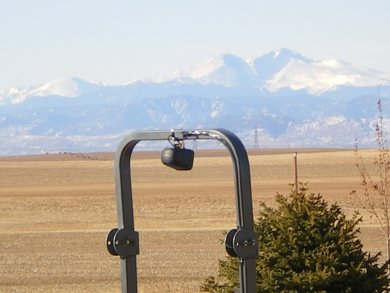

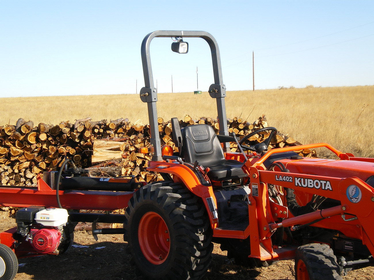

Installed two HIDs, a wide beam for the front and a super wide for the rear. Easy install used a stainless steel pipe clamp to attatch light to the ROPS (no drilling or welding) and used a water resistance electric box for the switches. Powered them from the battery using a inline fuse, also used plastic split loom for the wires to the switch box. These lights work great next best thing to sunlight and one is all thats needed. Ordered them from mobilhid.com, second day shipping included in the price I'll post some night pics latter.

That's sweet. Those things don't use many amps, so less strain on your charging system, and you'll have some super bright lights too.
   / HID lights pics #3
What lights? All I can see is that mountain in the background.

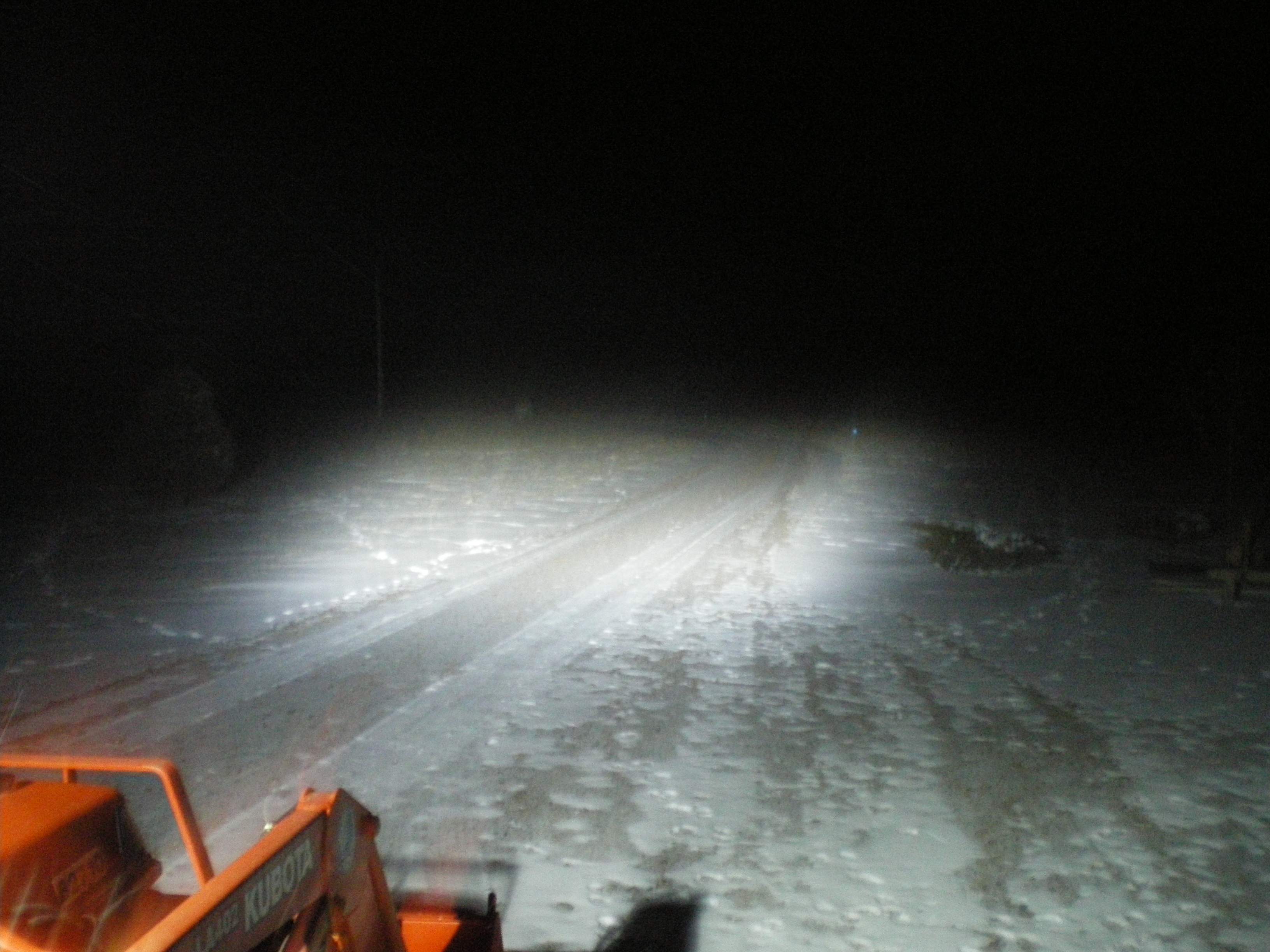

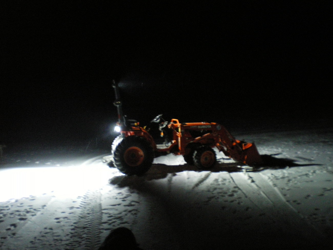

Here are the night shots.

Oh no worries. And man, they look fantastic in those night shots!! I'd love to see a comparison of those to the LED's some folks are starting to use. I might get the wife to swallow the idea of some LED's but she aint gonna bite for these.
