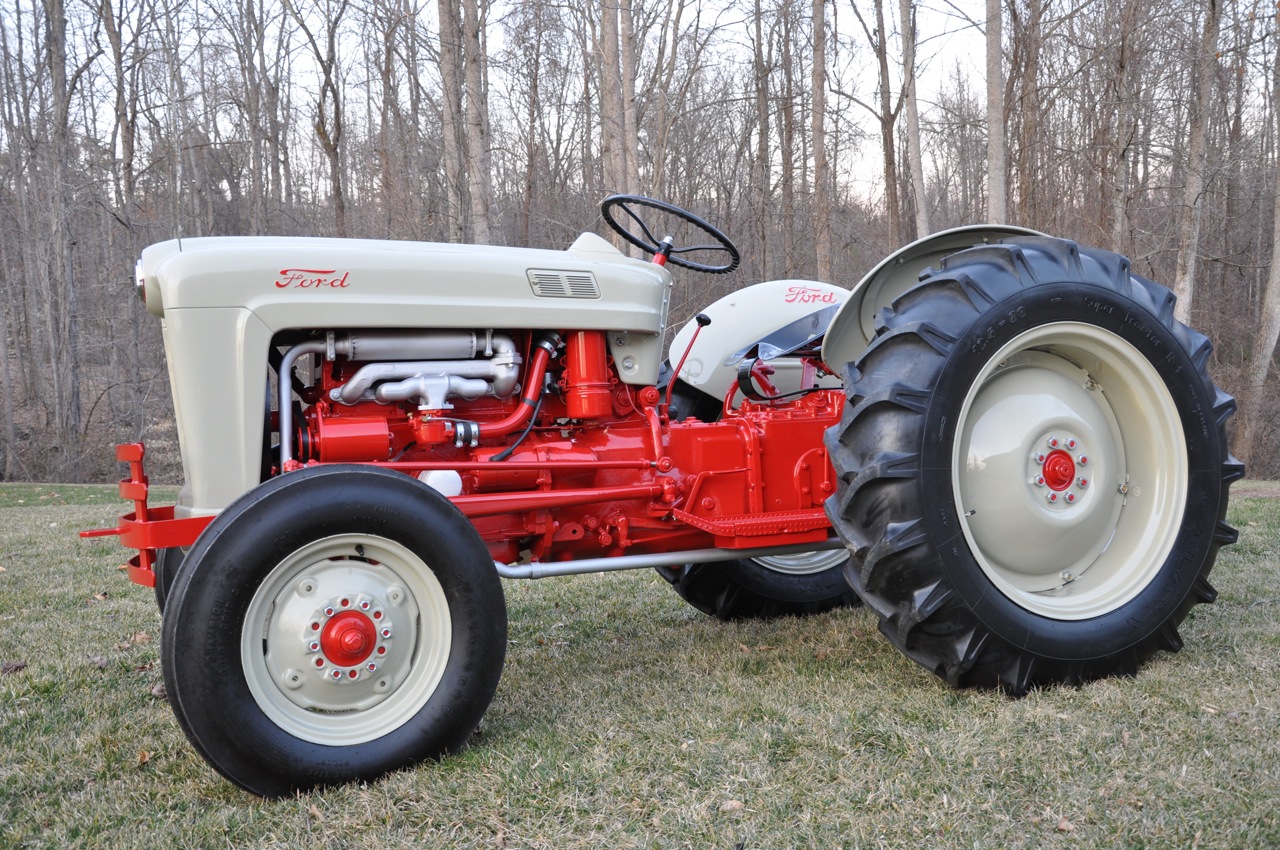

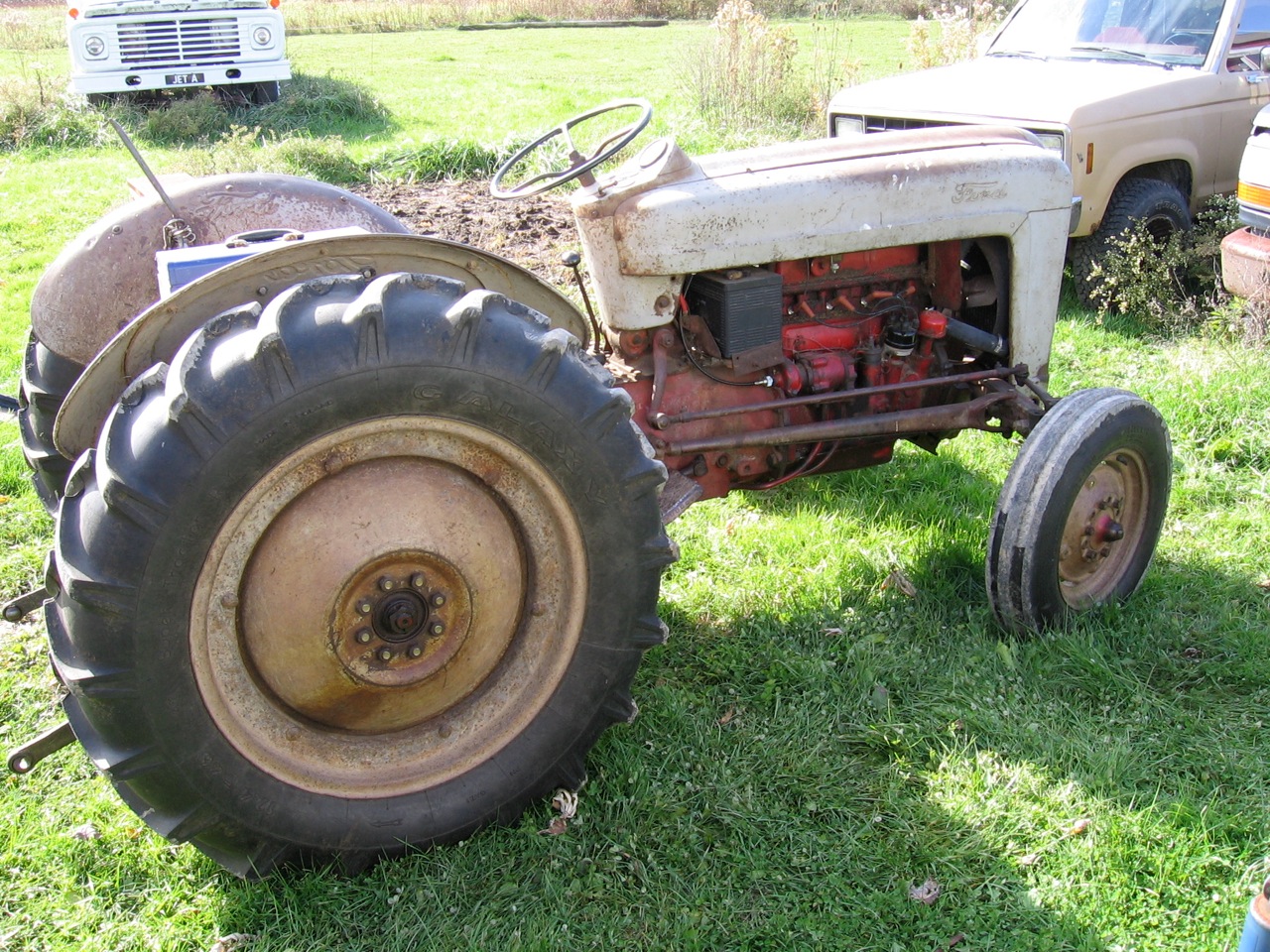

Thats what i was hoping to hear. We basically restored the entire tractor EXCEPT for the engine. I know this is strange but my grandfather did it a few years before he passed so felt it should still be in great shape. I have a ridicoulous amount of money in everything else on it and could of bought a brand new NewHolland. However, my great grand dad bought it new in 53 so it means alot to me just to have it. Anyway i felt i was wasting money rebuilding the engine again but was a little worried once it was complete. It runs great now but guess i was second guessing my decision. I will post a before and after picture in a few. Thanks again for your help.
   / High oil pressure on Ford NAA? #10
Here are the before and after pictures. I have no idea how many hours are on this tractor. It was basically used along with another tractor to service a 150 acre farm from 1953-1991. Used for feeding, hay, planting / harvesting etc. They sure don't make them like they use too.

   / High oil pressure on Ford NAA? #11
red tigers are very tough durable engines.... not uncommon to see the early 53/54 models still pumping along stron on all holes and lube system, untouched...
   / High oil pressure on Ford NAA? #12
They have to be very durable. Not sure about great grandfather but my grandfather never changed oil on anything. He did grease stuff but thats it. From 1953 till now the engine only has 1 rebuild which is amazing considering all the hours it has on it with little maintenance. I can remember in the late 80's when i was a senior in high school and i decided to change the oil for the first time. When i pulled the plug lumps of grease were the first things out. I couldnt believe what i saw. Changed it again a few months later and oil was still black. However now when i change it its almost as clear as when i put it in.
   / High oil pressure on Ford NAA? #13
very nice job on the restore:drink:
   / High oil pressure on Ford NAA? #14
Thanks. I didnt do it myself but had a local friend that restores both cars and tractors do it for me. Hes very detailed in his work.
