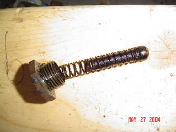

Once you repalce the gauge, and it is still high. Kill the engine and go take a look at that plunger / spring. While I think the FO-4 may give the inch pounds and length of the spring.. I think an old one is gonna be a gamble on getting it adjusted.. however a new spring is cheap.. still.. if you feel up to it.. you might try bending or shortening it a loop or so.. If you start it up and have no oil pressure, you have lost prime, and / or the spring is too loose and letting all the oil bypass. Stretch the spring back out or replace to account for the lowered oil pressure. If it did loose its prime, get some heavy oil.. egen gear oil.. anything that is thick.. even stp motor addative.. pour it down the relief hole till it is full.. slap the spring and plunger and cap back on super fast, and then get that engine cranking over to get the pump primed. As you may have guessed, the oil relief setup is above the oil pump, and dribbling oil into it fills the gearing. Loss of prime while dinking with the plunger / spring is not common.. but not unheard of either. Let me see if I have some pics for you.
Soundguy

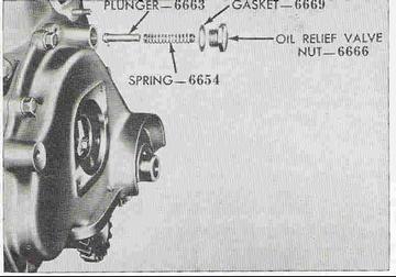

Ok.. that first pic shows the manual's info about the spring and plunger - part numbers.

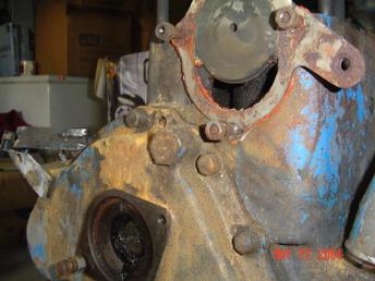

Also.. I lied to you.. the plug is actuall to the left of the water pump and under it.. but it is to the right of the front mounted distribuitor on the timing cover. For a side mounted distribuitor, it will still be there.. just the timing cover will be a tad different. Sorry.. Been a while since I dinked with the oil pressure valve.. I knew it was on front at least!
Next pic shows some other shots.

next pic
