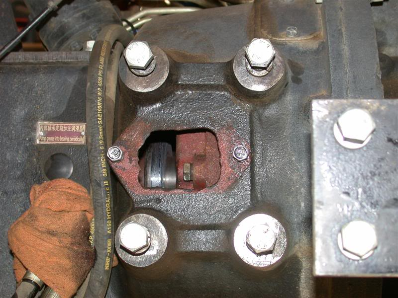

Is this the cover plate to inspect? see attached photo

That's correct. And FYI, that brass colored threaded object at the top right corner of the plate is the tach sensor.
Oh. And while the clutchpack is turning, look also for a pinhole on the side of the TOB housing. You might have to reach in with a tool to rotate the bearing yourself. A hole means its a greasable bearing, one that you should have serviced years ago. If the tractor came with a pointy tipped grease gun, that's what it's for. No hole means it's a sealed bearing; no user lubrication requirement.

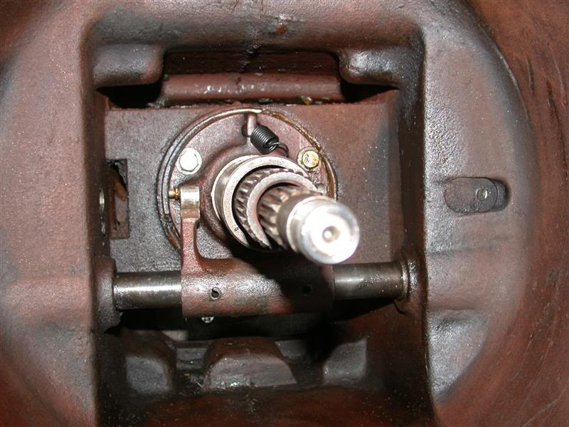

I read through 3RL clutch repair. The finger adjustment is behind the "hidden door". That is to say, behind the FEL mount. While reading his post, he mentioned a grease fitting to a bearing just behind the TOB , towards the back. I have not lubed this for a while so maybe the source of the squeal. It only make noise at high RPMs just moving along.
I'll try lubing the bearing with hopes that might cure it. If not, I'll have to remove the FEL and the fixed portion as well.
Patrick T

OK, I had a 454 with no loader. Told you my memory was going....Guess I adjusted the fingers on my 454 elsewhere. That grease fitting by the way, is not for the bearing. Again memory is a fleeting thing, but I think that's for the bearing carrier. But he also added an extra fitting of his own, so don't get his configuration confused with yours.
If you see a tiny hole in the side of the TOB housing, that's the grease point. No hole means you have a sealed bearing. The bearing carrier might actually need some grease, but it won't stop the "high pitched squeal" you originally described
