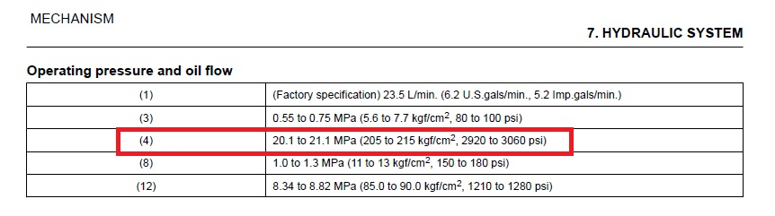

I am seeing spec'd hydraulic pressures for a BX23S around 3,000 psi
Are these pressures the ones you felt may be too high?

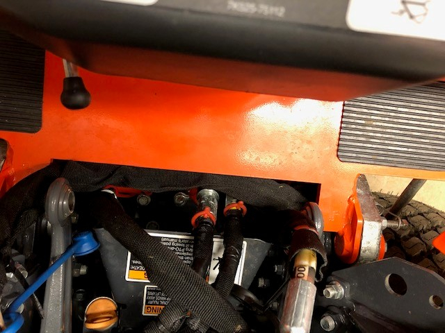

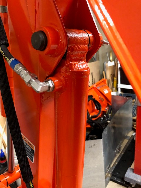

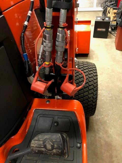

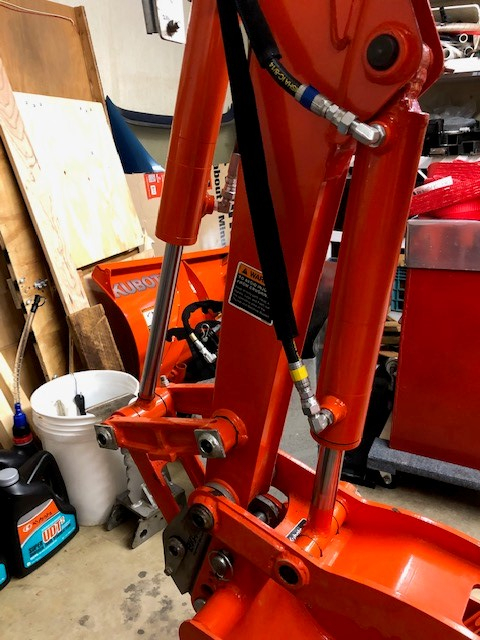

Well, how ‘bout that…… Could not find it in my owner’s manual. But doing some Google search found it in the Kubota Workshop Manual WSM (free download www.kubotabooks.com). I responded to your first reply here since TractorByNet sends an email notice for replies. I now see your reply in the other forum, which is where I was getting the 1840 psi rating & where I originally posted.
So now appears all is well and I’m actually low by about 300 psi—I think I’ll not mess with it. That thumb has been amazing to work with compared to the factory manual unit--here are some pics.

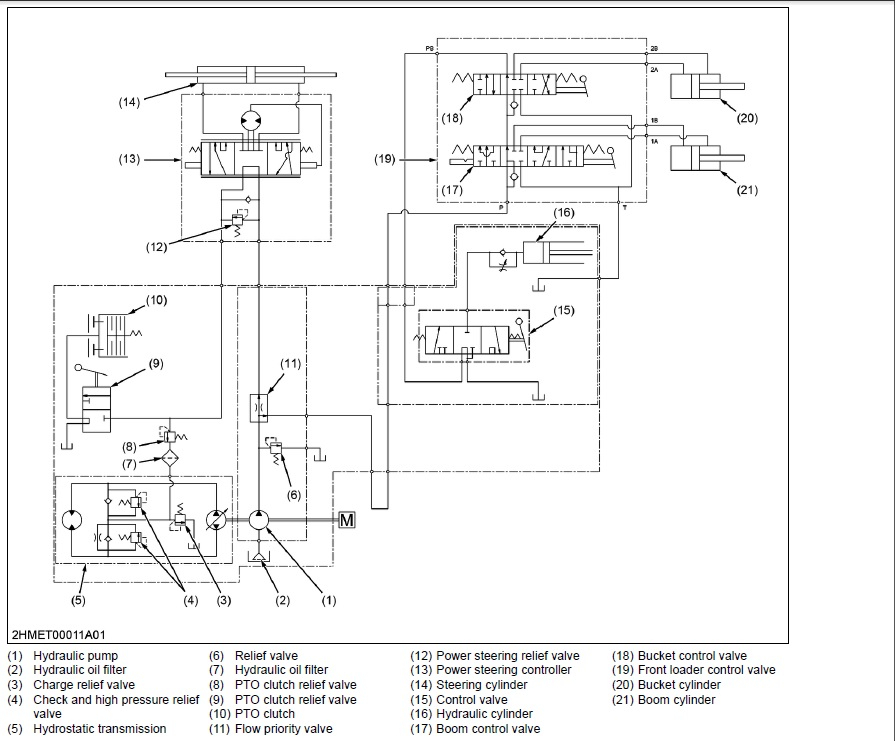

Wow, that is so weird. The hydraulic pressure spec for my 2009 BX25 is only 1750! Surely they did not almost double it for the BX23s.
The high WSM pressures are the HST pressures.
