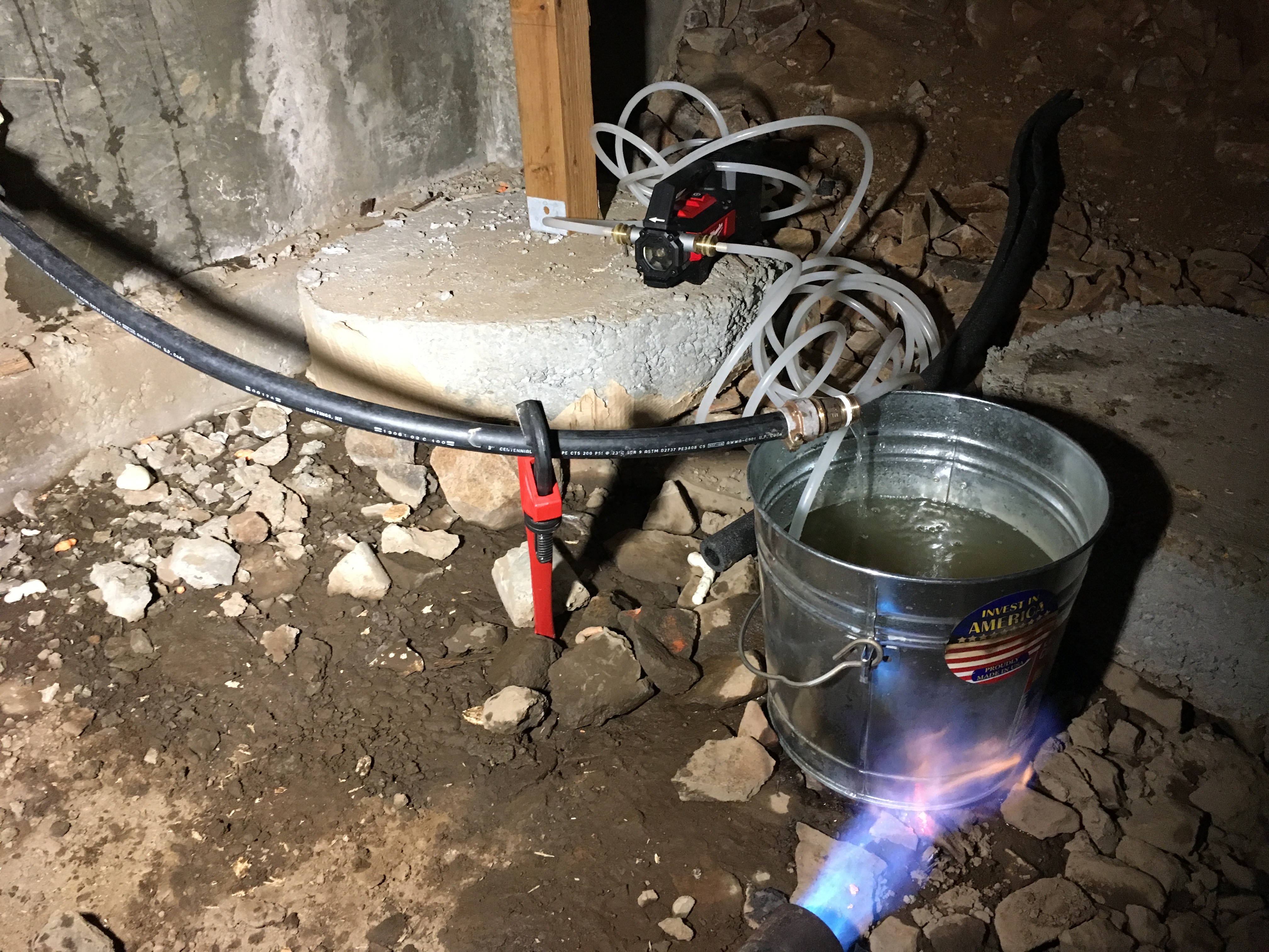

Well, the frost free issue spread like cancer, it dropped down through the Tee and into the main 1" poly line to the house.
A neighbor of mine was here and we considered getting the backhoe and started choosing where we'd dig up the line, to determine where it is frozen, and yada yada yada. What a mess. 200' of 1" poly from the water building to the house.
Well, then I came up with this little solution.
We used a fiberglass fish tape to find the ice blockage.
125' of 1/2" tubing that we pushed up through the 1" poly water supply line to the house. We put a bucket under the main line for water to drain back in to, and heated it up constantly with a weed torch. We used a Milwaukee transfer pump to pump hot water from the bucket up into the frozen 1" line, where the water then just poured back into the bucket.
We started from the house end, and found about 50' of ice, that took us HOURS to clear, and then we went up to the water building and repeated the process in the other direction clearing about 25' of ice, which took as there were more bends and Tee's to fish through.
All in all, with 1 break to run to town for some parts, a couple of slices of pizza, each of us taking turns when our arms were giving out, and we got water back on to the house at 5:30AM, we started the previous day at 1:30PM.
Not something I want to do again.
Now, I have a question I'm also going to send to a friend of mine that is a fluid dynamics engineer at Boeing. How can ice travel that fast in one day. Can it really go that far?!
~Moses
