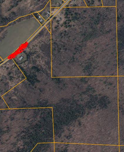

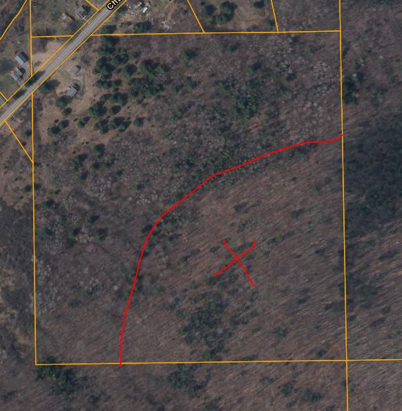

Just so I have the right idea of what I want to accomplish and if a tractor and backhoe would do the job specifically the XG3025/MT225 (25hp tractor on a 35hp frame). This tractor is similar to the Kuboat L2501 and John Deere 3025e actually a little higher on the capacity side of things. The next step in HP in the LS lineup isn't
Some back story, my property is diamond as pictured on the top and is a total of 40 acres. This is in NY on the southern tier towards the middle of the state near Watkins Glen N.Y. We get a good amount of snow have wet springs and somewhat dry summers. I plan to use the tractor for a number of things but need something to maintain our property but be nimble around our house. All while having enough Oomph to pull logs out of the woods for firewood and milling. I also plan to do some road building around our property and add some food plots for hunting. Our property has been growing wild since the late 1800s (according to town documents) and hasn't been logged in over 50 years, so I need to do some clearing and cleaning up. I plan to add a deep 2 acre pond from the springs on the property.
The red line with the X indicates the steeper portion of my property. I currently have an ATV path that outlines the top edge of the diamond to the top (north) corner but stops there and from the house to the East (right corner). I need to clear some trees and plan to add a path using the tractor around the top edge to the east and then to the south corner and connect the rest of the way around. So in essence I will outline the property with a 4wd path all the way around it. I am hoping at some point if the neighbors sell I would buy their additional 60 acres (bottom picture) to my south and continue the road around that section of property.
Anyway would I be wiser spending my money elsewhere than a tractor and backhoe? I realize this is going to be a good amount of work but I'm not afraid of the work and have time to do it. I would have other uses for the backhoe but for the property and current trails I feel the MT225 is a good compromise on size and versatility. Either way I need the tractor for clean up around the house, large driveway for clearing snow, and other tasks listed above. I'm not new to tractors or heavy equipment but some of the task I will be doing for the 1st time in my life as my parents farm already had a lot of it done before I came around.

LS XG3025 is too light for the tasks you have specified on your current property.
Tractors around 2,700 pounds are pretty fair on max ten (10) flat acres but you have 40 acres with hills now and the aspiration for 60 additional acres, for 100 acres total.
With a Loader and Backhoe mounted and a scant 24.4 horsepower you will crawl up slopes in HST/LOW.
Note that engine on this model displaces only 80 cubic inches and driveline seems to be marginally efficient with a drop of seven horsepower, 30%, from engine gross to PTO horsepower; drawbar (pulling) horsepower is always less than PTO horsepower.
I suggest a tractor with a bare tractor weight of 3,600 to 4,000 pounds and thirty-six to fifty horsepower.
If you consider a 3,700 pound bare weight tractor while maintaining a small tractor footprint research Kubota L3560.
I am not familiar enough with LS to recommend a similar machine in their line. Doubtless LS has competing models.
