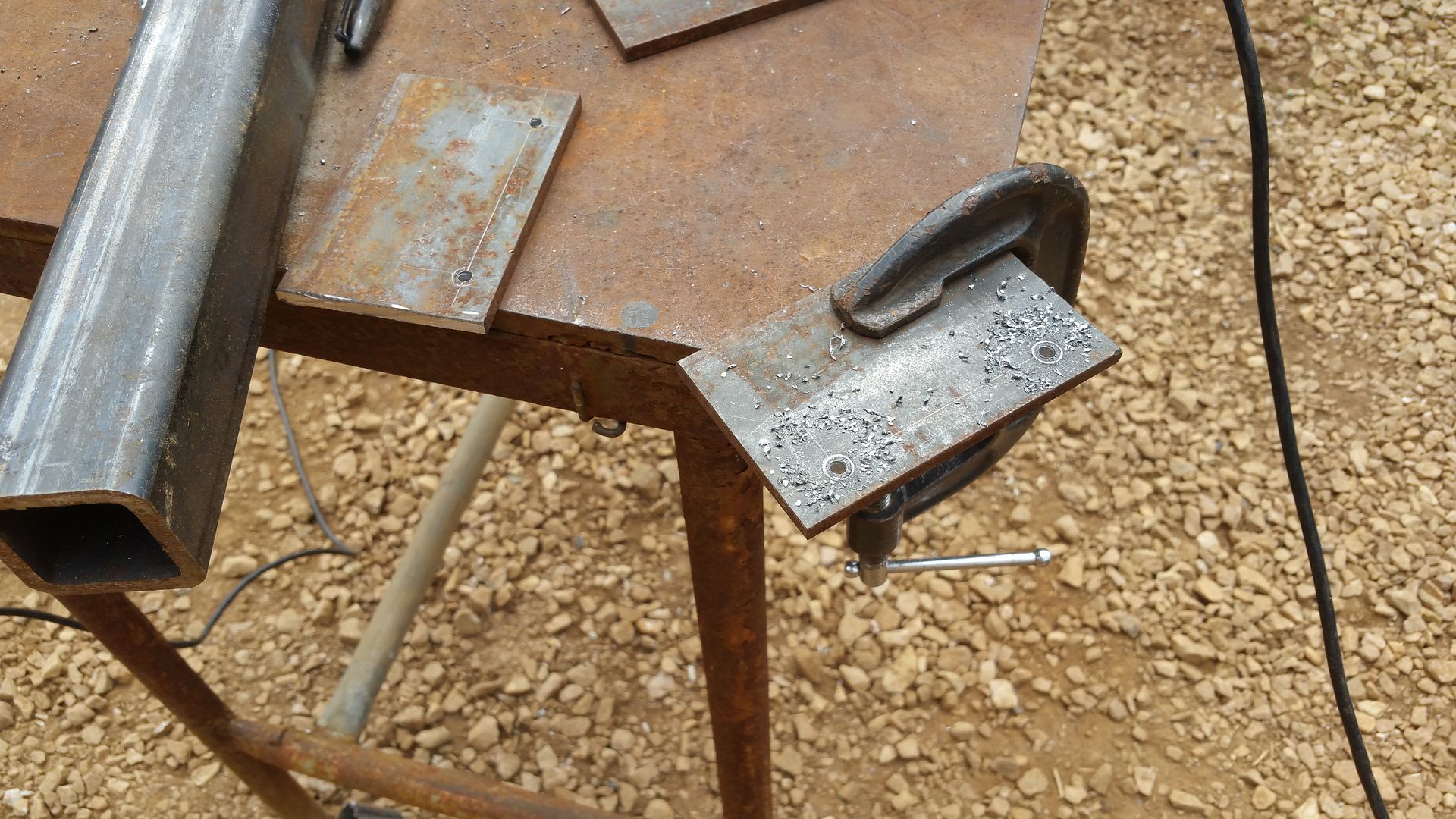

okay,just finished today's project minus paint and some bracing...if it works;)
working from home with no access to lathes and mills sucks, so using a grinder, hand drill and 15 year old Harbor frieght drill press...I pushed on :cool2:
Spent an hour making $2.00 pins :confused2:
laid out
found some old rollcage tubing and used it for spacers
had to make a couple plates to attach discs to tubing
welded up disc holders
mounted
I can swap sides and get them 6" from each other
well, going to grab lunch and see if they work

   / Hiller stage 1
it worked good
carried it down in bucket, and then assembled
here it is on the ole girl
of course papaw raised **** because I buried tators 6" or 8" deep instead of 4"....what ever...I am having fun and learning new stuff weekly
I told wifey, would of been easier if you just let me buy a Fire Truck :D:laughing::laughing:
