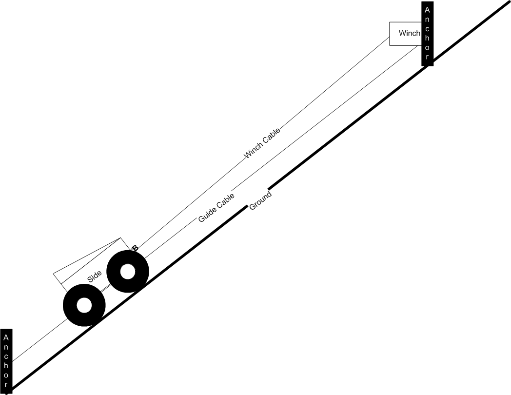

Thanks again for the suggestions. Its looking like an overhead tramcart is not going to cut it due to the weight and stress at the end poles as someone suggested. So I'm thinking now it will have to be a big wheeled cart and I'll have to clear a path as best I can or have it run on handrail poles. As for power, I'm thinking now maybe until I have time to rig something better I'll just pull it up with my tractor. Its about a 45 degree incline of 120 feet, so it should be interesting....
Bob
   / Hillside tool elevator ideas ? #13

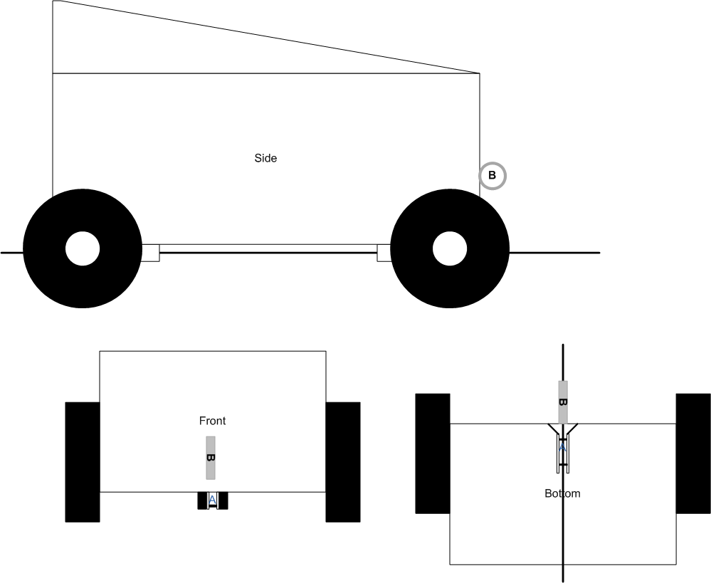

I would make a cart with 4 wheelbarrow/ATV tires, put a guide on the bottom (A) and a ring on the front (B). I would then use the guide with a cable below the cart to keep it going where you want it to go and the eye/winch to raise/lower it.
I would also add a "Leash" at the top so that if the winch doesn't hold, you don't have a cart freewheeling down the slope.
