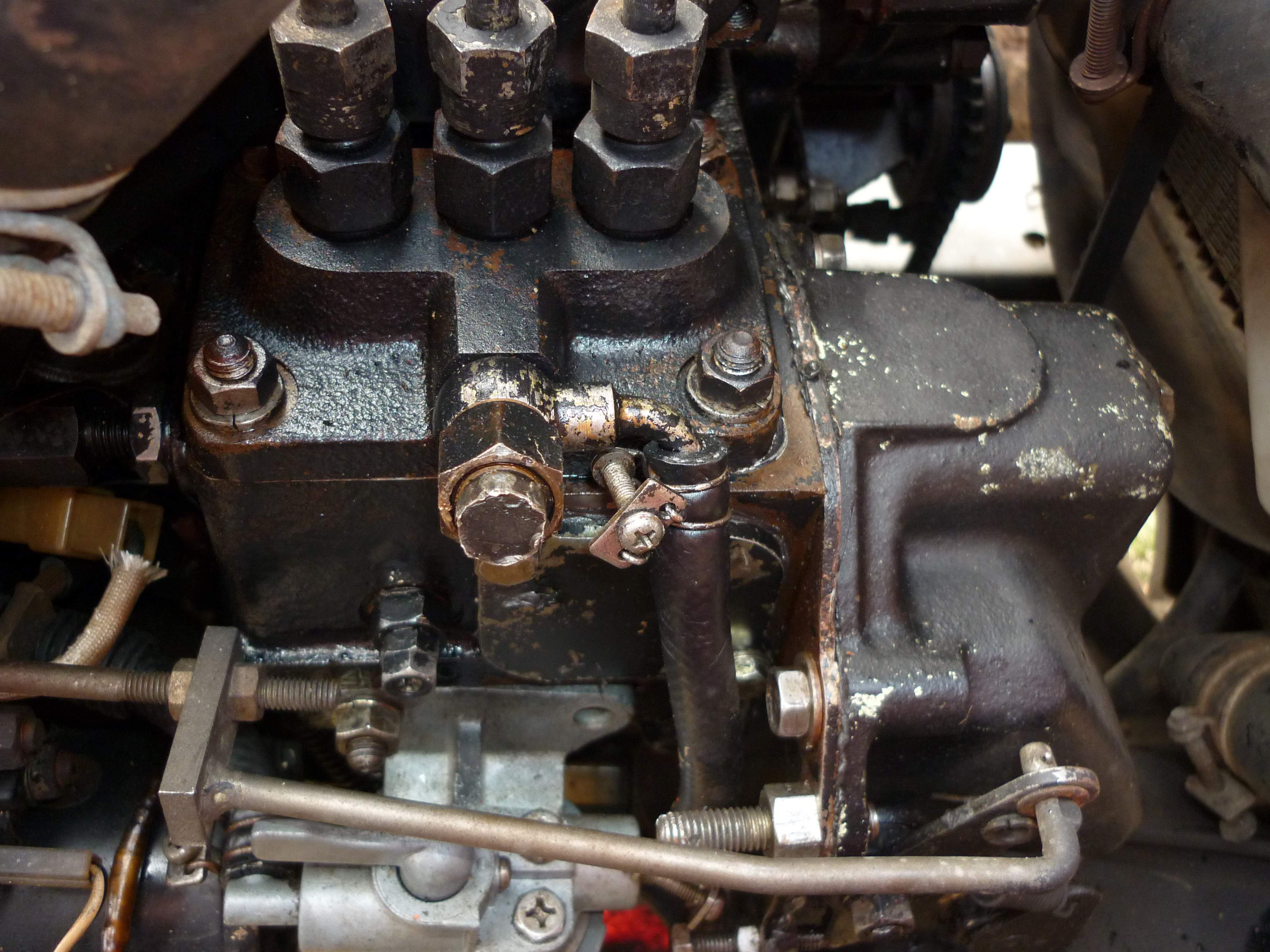

Hello guys,I'm from Europe and I have purchased recently a Hinomoto E2304 4WD. I'm really pleased so far with it. However, I have a problem with the engine oil quantity. I've read that it takes about 3.5 litres of oil, but I've put in it about 5 litres, barely showing on the dipstick. The sump has two drain plugs, one on each side. Could one of you kindly measure a dipstick for this model, because I'm thinking it's not the right one. Thanks in advance!
   / Hinomoto E2304 questions
#2
Ok, I went ahead and put in 5.7 litres, halfway between the marks on the dipstick. Hopefully, no oil seal will get blown. :) Now, another issue, how in the world to change the oil in the injection pump? Can't seem to figure out. :confused:
