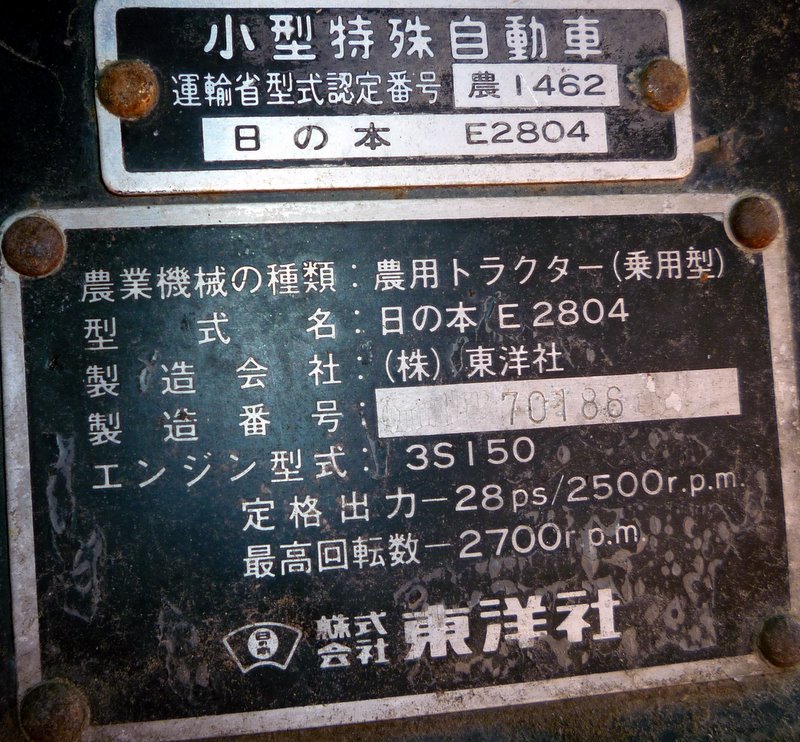

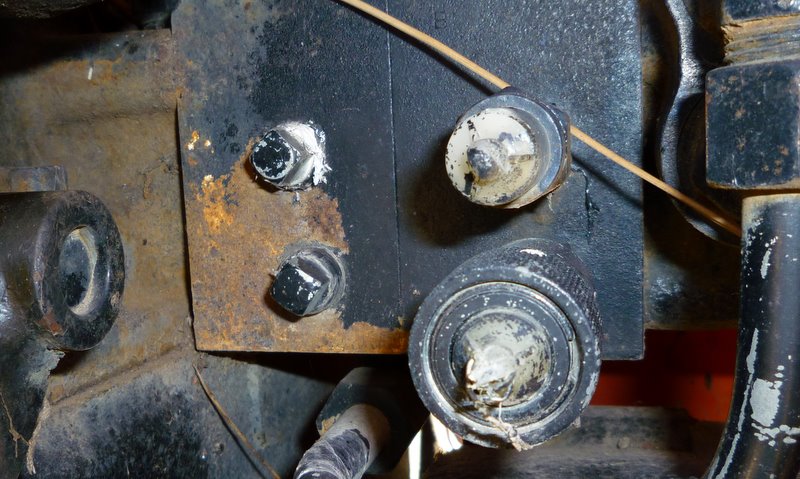

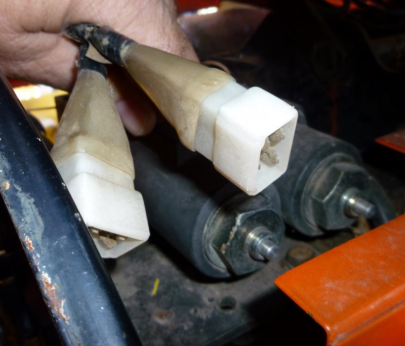

I have owned this tractor for a few years, and it looks like there is some sort of rear remote, maybe 2. I would like to use them if someone can give insight to how to conect a lever, or where to find them. Am posting photo's of S/N and ports and possible valves. Thanks in advance for any help.

Bump, I'm still looking for help with this. the 2 (valves?) are directly in front and above the 4 ports 2 ports have QD's that are male/female instead of both female like all American tractors I've been around. the 2 gang plugs have 4 male spade terminals inside. Oh, the QD's are rather small, maybe for 1/4 or 3/8ths hoses. If no one hase info here, maybe you can set a ballpark figure on PSI's. I could try testing with a ohmmeter and pressure gauge if I can connect the valves up.

That setup, looks like it was designed for an attachment that probably had solenoid valves to control the hydraulics. Although I see two solenoid valves, I see only one set of outputs. Do you have any switches on the FEL lever handle? I believe the male QD is the pressure fitting, and the female the return line. . Plug a gage on it and see if it has pressure, and find a switch that might apply power to the electrical plugs. I am guessing that you don't have a manual.

Thanks Scotty for the link to the parts book. As to the Tractor Data site, the info there is a little suspect, as the 28 PS on my data plate translates to about 27.5 HP.
JJ: there are 2 pipe plugs next to the QD's that are in line with the selonoid on the rt. in the other pic. Are you saying the HYD is one way? The loader that is attached has 2 way Hyd. Haven't a clue as to what to expect for PSI. but will try something. Was hoping someone would have a more educated guess than I. Thank you for the help.

A one way solenoid usually has only one solenoid, to control fluid as in an on/off situation. A two way solenoid valve can switch hyd flow direction. You do have two sets of remotes, one set has QD's, and the other set is plugged. You could add some QD's instead of the plugs.
Without a schematic, it will be hard to determine the wiring, but in any case, you could go direct to the solenoid and apply 12v to the two wires on the solenoid to activate. As far as pressure, it will probably be tractor pressure. In order to test the pressure at the remotes, you would need to activate the solenoids.
You might try and trace the wires on the solenoid back to the plugs and see if the plug is used to apply power to the solenoid. The plugs might be for something else.
Can you think of an implement offered by the tractor manufacture that might use a hyd circuit? The electrical plugs might even be part of a feed back circuit for what the implement is doing.
