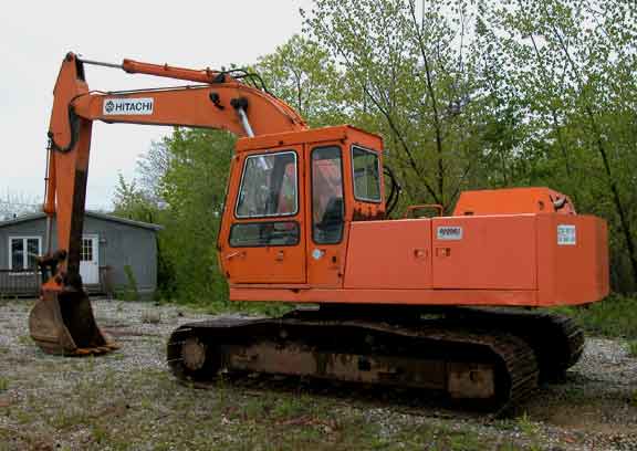

I just picked up a new for me, Hitachi UH083LC 44,000 lb excavator. It has 10,000 hours, the motor, turbo and hydraulics are fine. The undercarriage is in tough shape. I'm going to be using it on the farm to put in a road, pull large rocks and dig a few foundations so hopefully it will hang together until I'm done and can sell it. The work just takes too long with the TN75D and Woods 1050 hoe. Does anybody know where I can find any good used undercarriage parts cheap. Can th eundercarriage parts be rebuilt? The boy in the photo is my 17 year old son Jim who I'll be teaching to run it also. Maybe I'm crazy, but I always wanted a big excavator. I love the power, and cant' wait to see what I can dig up. I'll let you know.

Another picture of the new toy...
Hope it doesn't eat me out of house and home.

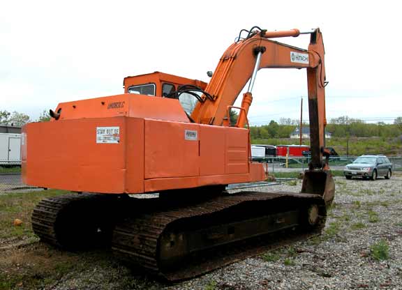

last one

That is one nice trackhoe you have there, dont have too much fun with it /forums/images/graemlins/wink.gif

Nice looking hoe! You might check with some of your local welding shops. A competent welder can rebuild the rails (chains) for you. The sprockets, if they are sharp pointed, will have to be replaced. If it is a sectional sprocket, you can simply unbolt and replace sections one at a time. If not, you will have to pull the sprockets with a heavy, multi-ton puller. Unfortunately to repair the chains you will have to break the track at the master pin to do repairs. This is very heavy and dangerous work! Make sure you have the tools and think safety constantly. Those heavy components will bite you real quick. The chains alone on my little D-20 weigh 300 lbs. apiece. When you add the pads and bolts they get real heavy. I like working on the durn things, I just hate paying for the parts. Be prepared for sticker shock, parts for any heavy equipment is not cheap. Here is a sight that might help you chase down used parts or manuals: www.ytmag.com/crawlers/wwwboard1.html. Good luck and have fun!
