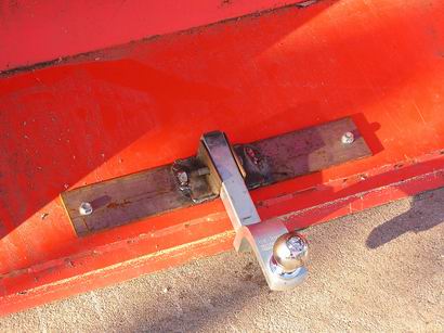

Here's what I did that cost almost nothing as I had all the parts.
I bolted a welded bracket to the bucket that allows me to insert a receiver hitch w/ ball. I can unpin the hitch and still use the FEL.
When I curl the bucket enough, I can see the ball which allows FAST hookups to trailers. If I had the ball bolted to the bucket, I'd never be able to see the ball to hook it up and likely would have to dismount to attach each trailer.
It's fast and easy and I could drill smaller holes to mount it.
Enjoy!
Ron
