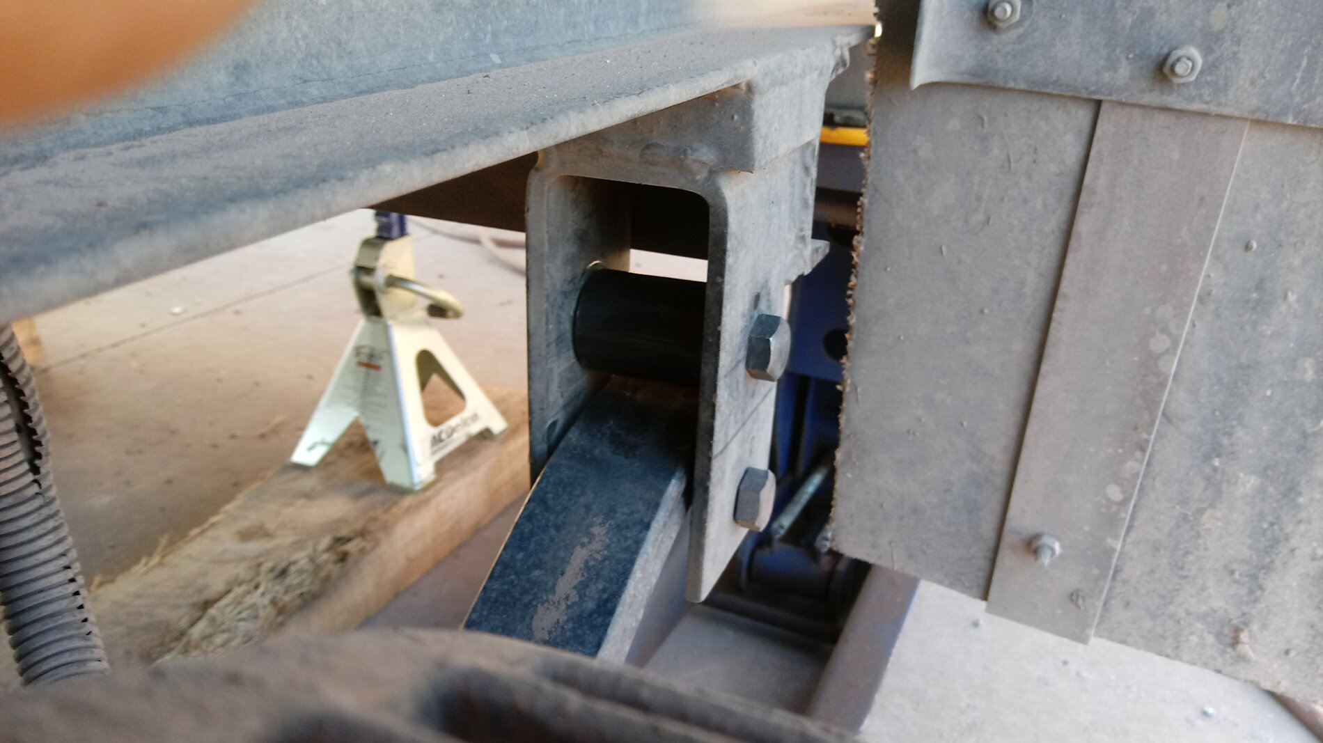

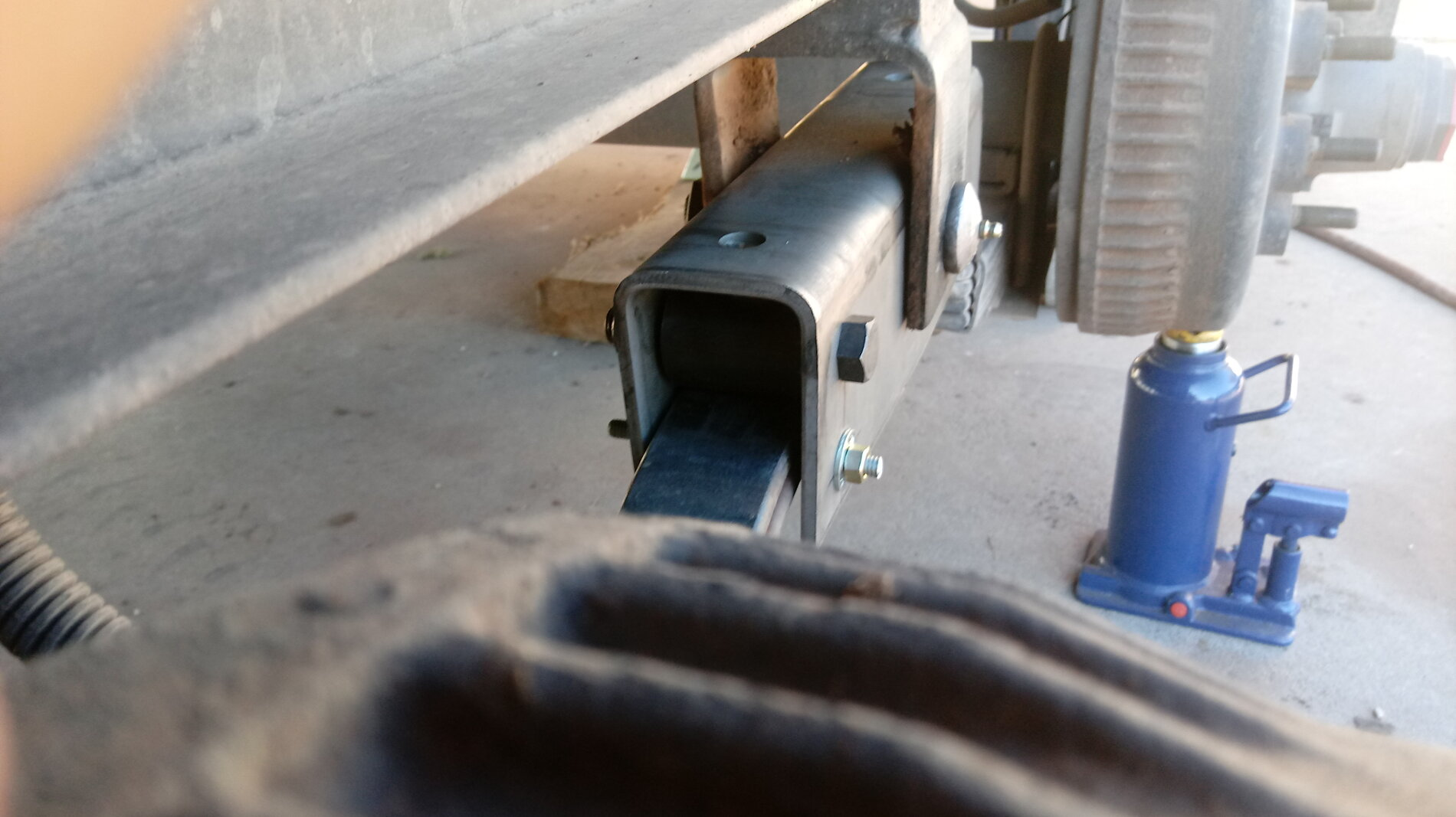

I have overloaded my much ā€œlower qualityā€ Kaufman and haven’t experienced and weld failures or broken goose neck hitches.
Yet.
I've severely overloaded my Kauffman on more than one occasion actually with no adverse effects other than a bit of sag in the middle. I've put 29 rounds on it in the past and hauled them home and survived to tell about it.
The only thing I did have to do was I added steel plate gussets to the spring hangers as in a tight turn, loaded, the axle hangers were twisting sideways.

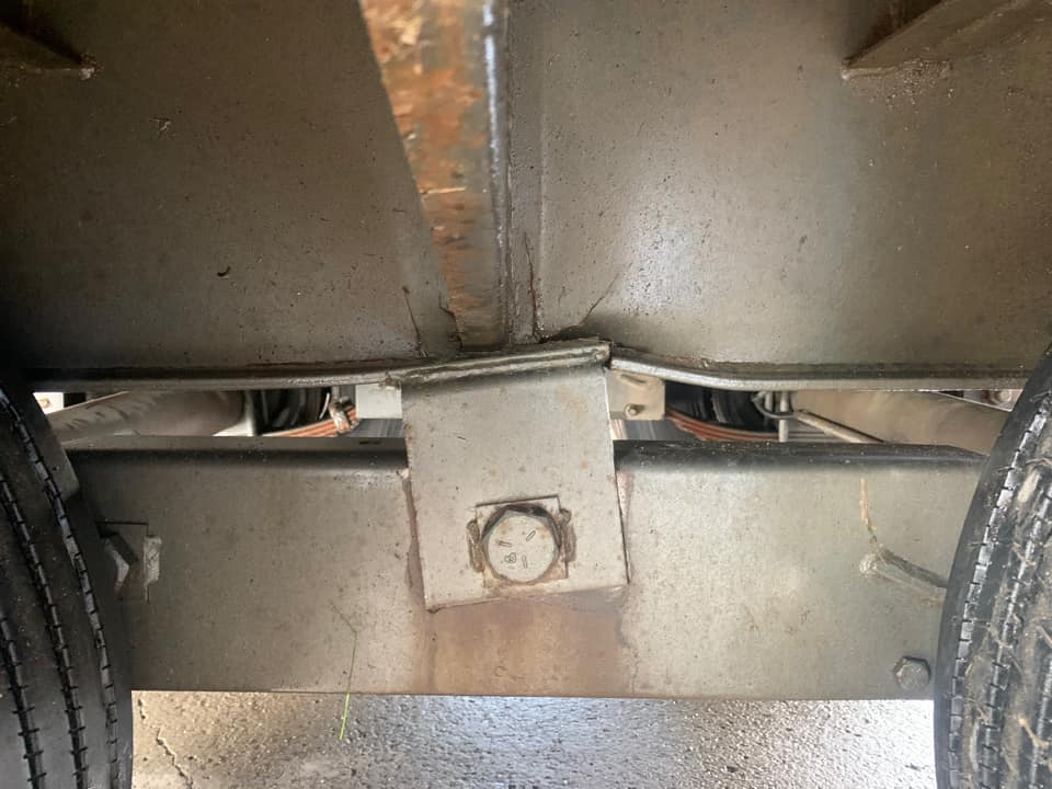

They need establish QC on their welding process starting with independent 3rd party NDT on safety items.
That would only increase the unit cost to where they would no longer be competitively priced. The trailer market, especially the GN trailer market is extremely competitive so increasing the unit cost to cover that would be detrimental to sales. My comment is crank up the amperage and increase the wire speed accordingly. It's MIG welded and not pulsed MIG either. If I was building them, I would have used high amperage globular transfer on critical welds.
   / Hitch failure on a Diamond C FMAX 212 #46
Always keep in mind that MIG welding with gas shielded wire is way down on the skill level totem pole as well. Why weldors refer to MIG as the 'Glue Gun' of welding. The only time real skill becomes involved in MIG is when the operator is skilled at Globular Transfer which is ultra high amperage (with shielding gas) and requires skill to achieve a sound weld.
Any one can MIG weld, good prep or not. Why it's referred to as the Glue Gun of welding. In as much as the joints in question, you cannot see if they were prepped properly (as in bevelled) or if there was a root pass used prior to the cover pass so it's all conjecture if they were prepped properly or just fitted up and welded with no pre-prep. Butt welding isn't the strongest joint by a long shot.
Any good guesses on why anyone would butt weld the goose neck to the frame ?
Ive seen chunks of beam tore out of the frame because the air spring hangers were wrought out in turns, because no gussets were added in the I beam above them.
