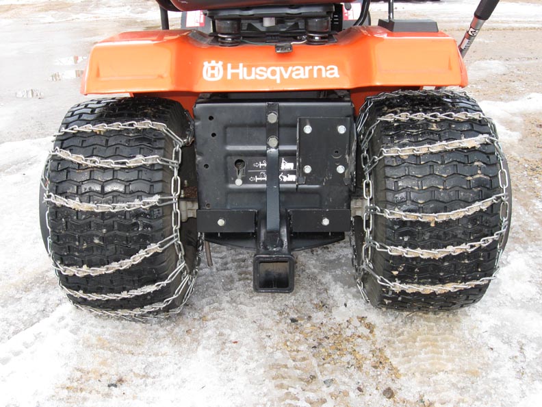

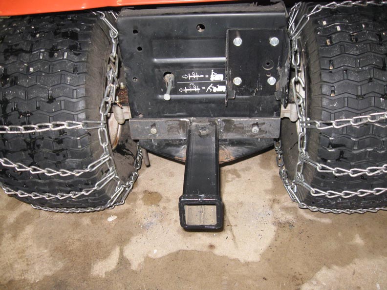

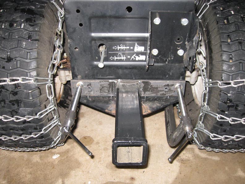

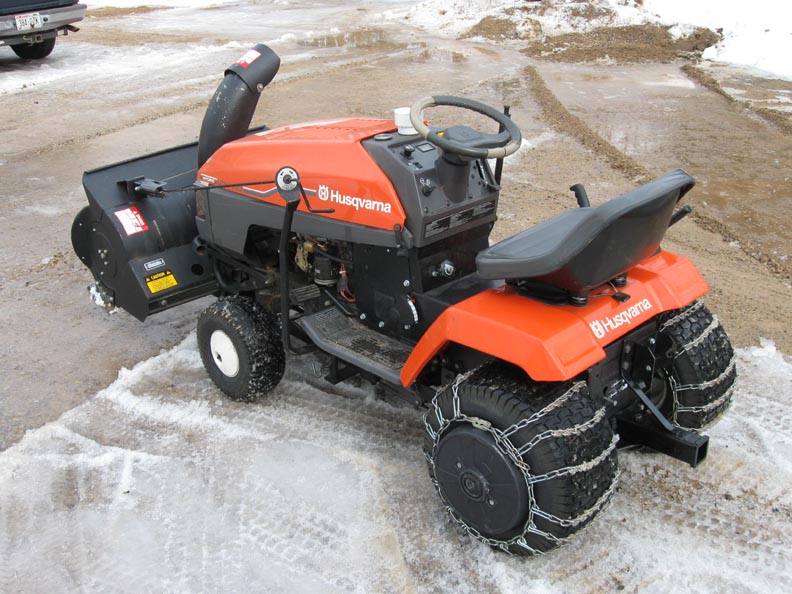

I finally got sick and tired of taking off the hitch every time I had to put on the snow blower. There is a brace that needs to connect to the platr on the rear of the tractor. I took a receiver and welded it to a flat bar and mounted it to the rear of the tractor, I then made a brace and mounted it. Now I can leave it all connected and still mount my blower. Where the old one was mounted, I put a longer bolt than needed and now I can put the brace over the bolt and put another nut on it.
hey buddy great idea i love costum stuff that is practical and works .i own the same machine:)
