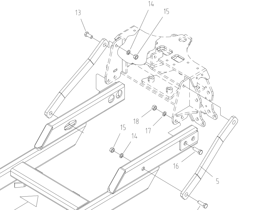

I searched for this but i didn't have any luck. I have a 2017 XR4140H with LB3104 hoe with the factory frame. I worked it real hard this past weekend and the 8 bolts that mount the hoe frame to the sub frame kept working loose. What kind of trouble am I looking at if I weld the frame together instead of just relying on the bolts. I can probably take it apart one bolt at a time and red loctite it, or tighten it up and tack weld the nuts. I'm just worried if I tack them or loctite I'll still have it shift around under load no matter how tight I get the bolts. There's provisions for using a toplink but I would be worried about breaking the rear axle housing. I've attached part of the manual that shows the mount of the frame to the subframe. What do you guys think?

What do you think about making some short welds to hold it together? Place the welds where they are easy to cut out at a later date.
   / Hoe frame welding question.
That's an idea. Was planning to retain the bolts but grind away the powder coat and bevel the areas that I can get to to provide a good clean surface. I can probably get to all of the areas with a 4" grinder and a cutoff wheel if need be. I'm just concerned about moving the stresses from the bolts to the box tubing. Of course if that happens I can always just heavier wall tubing and rebuild the subframe if need be. Thanks for the input. Anyone else.
axle housing.
There's your answer: use the toplink connection.
That type of subframe has been around a long time and is used on lots of tractors. It just flexes too much if you
don't use the toplink. Stress on the toplink connection on your tractor is not severe; it is nothing like
you would have with a 3-point hoe.
Kioti hoes use that design and I have seen where the braces are welded, but the flex does not go away.
It is near impossible to keep those bolts tight if you have that kind of flex.

when welding anything the heat from the weld makes it a little more brittle so if you do weld it up to take flex out, some thing has to give. If i was to weld it I think i'd tack the bolt heads enough to keep them tight but not all the way around then i think i'd brace it by using top link or bracing sub frame with steel brackets to solid it up a little but in the long run something will give if worked really hard.

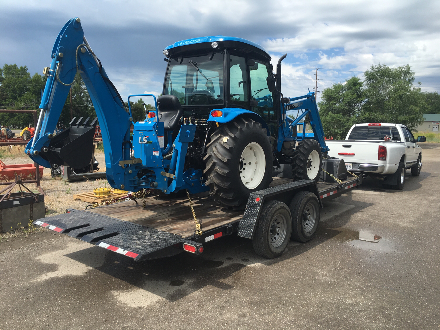

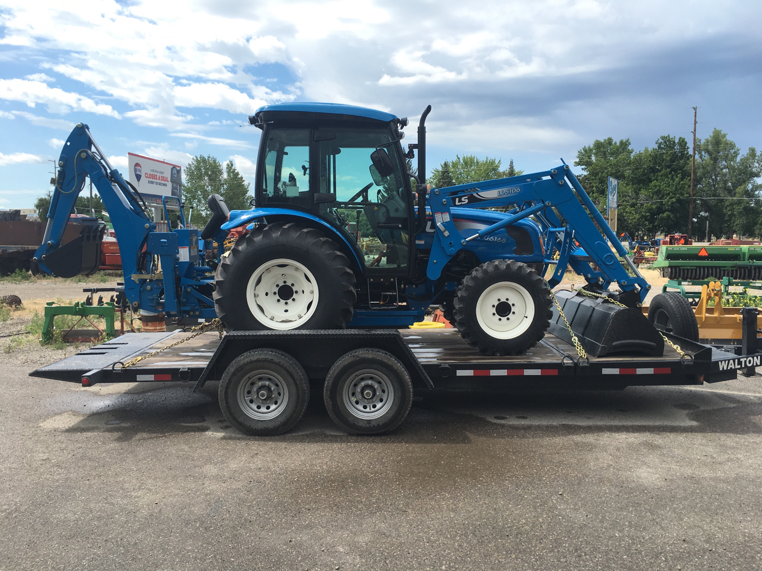

It should have been delivered with the top link in place. Install it and your problems will disappear.
Locktite on the bolts is fine if it makes you feel better.
You can see the top link installed the day I picked up my tractor.
